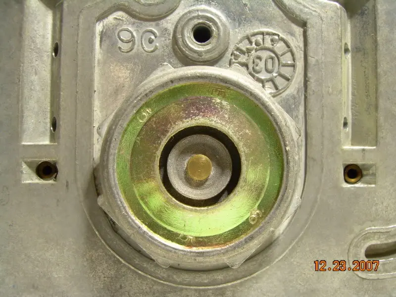

I rebuilt a holley 600 a while back and it ran like *****. idle screws didn't work, even though the blades were in the idle slot, at WOT it backfired like crazy. I took it apart, holley told me to check the power valve since it may be incorrectly sized for my combo, how the heck do I identify this power valve?

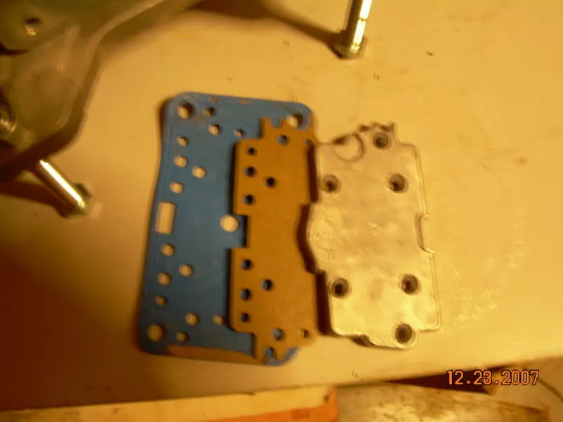

also, is this the proper orientation for the secondary metering plate (it is a 4160)? :
if anyone has a good linky that shows what factory stuff like gaskets originally came with the carb, that would be extremely helpful. Im starting to second-guess myself when it comes to things like the throttle body gasket and secondary gasket

Ditto, 6.5 PV. Make sure the gasket behind it is correctly centered. And for the metering plate gaskets, make sure to use the correct ones, kits come with multiple gaskets for different applications. I compare the old ones as I take it apart and pick out the correct ones for the assembly.This prevents gaskets blocking passages(a metering gasket on backwards will block certain passages too) You also have to verify all the tiny passages are clear of dirt and debris, I soak the parts in carb cleaner for a day, then using spray carb cleaner, spray thru all passages (use eye protection) and then follow with compressed air.
Do you know what your vacuum was at idle. Holley is thinking the number might be too small. If you idle vacuum around the same PV sizing, it could open or flutter at idle shooting the AFR thru the roof. The idle mixture screws wouldn't be much help if it was acting up.

So, to identify the power valve, I read the two numbers clockwise from that wierd letter? How do I identify if it is blown on the bench without a $80 proform power valve tester? I have a vacuum pump if i can use it somewhere. . . . I checked my other 4160 and it has the secondary metering block gasketed as shown
that carb is way too small first off, do you have anything else to play with? You are getting that backfire at WOT because of a lean pop. Skip the Demon and buy a 700 dp Holley. To check your PV place the front side(side with #'s) to your lips and inhale the other side of valve should pull shut and stay that way. Or of you have a brake bleeder you can use it to. Just attach a 3/8 hose to it and pump it till PV closes and watch gauge to make sure it maintains pressure. That carb can get you by in a pinch but is really less than ideal for that combo!!!!

thanks. didnt think of it being too high a restriction at wot to cause the popping. I checked the pv on my vacuum tester and it took 9.5" to fully seat the needle (as indicated by me tapping on it and increasing vacuuum until the noise stopped). In contrast, my other 6.5" power valves fully seated at 7.5". My gauge may be off, but the power valve in the 600 seats after more vacuum is introduced. I will swap it out for the lower running ones and see what happens. when I ran the carb on my motor previously (before swapping to the ugg edelbrock), at wot regardless of rpm my motor did the backfire thing. I figured its not because i was outflowing the carb, it was because something was F'ed up in my secondaries. When i tore it apart, i found the secondary metering plate directly attached to the blue nonstick gasket. the insructions say to use the cork (shown in original post), then a metal plate, then the blue gasket. I don't have a metal plate? when i put it back together, i will include the cork gasket as well, but the only difference i see with that is that it covers a center hole. WTF?
