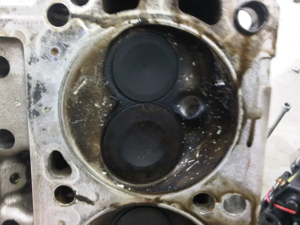

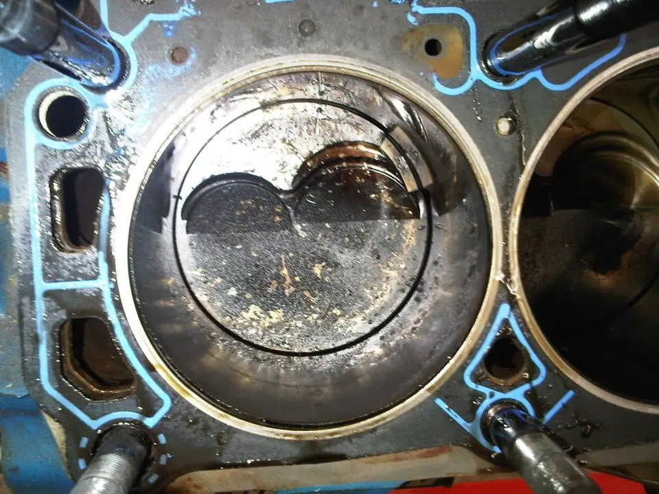

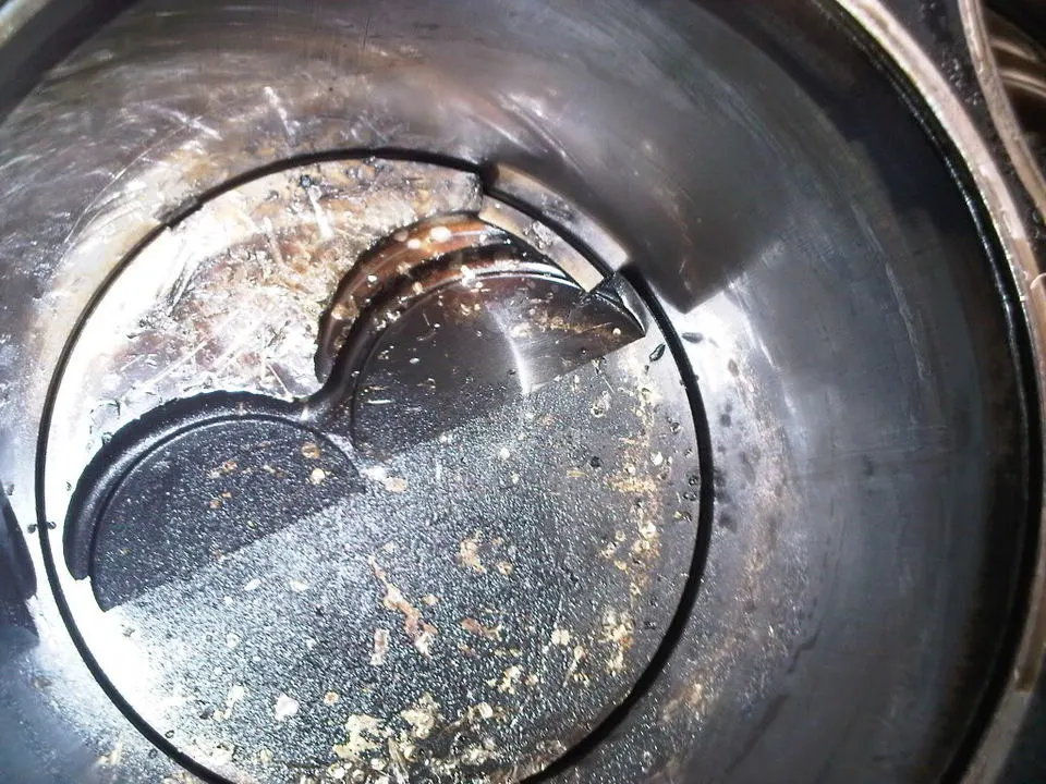

So I finally decided to see what the hell mess was in my engine. Pulled everything out and pulled off the heads. Found a couple problems. Cylinder six blew a head gasket and cylinder four had a broken piston. The cylinder with that had the broken piston has markings but the head is salvageable; however it appears part of the piston made it up the intake and over to cylinder one. Everything looks salvage able though besides the pistons. So I am relieved right now.
Anyway here a a couple pics of the tear down.

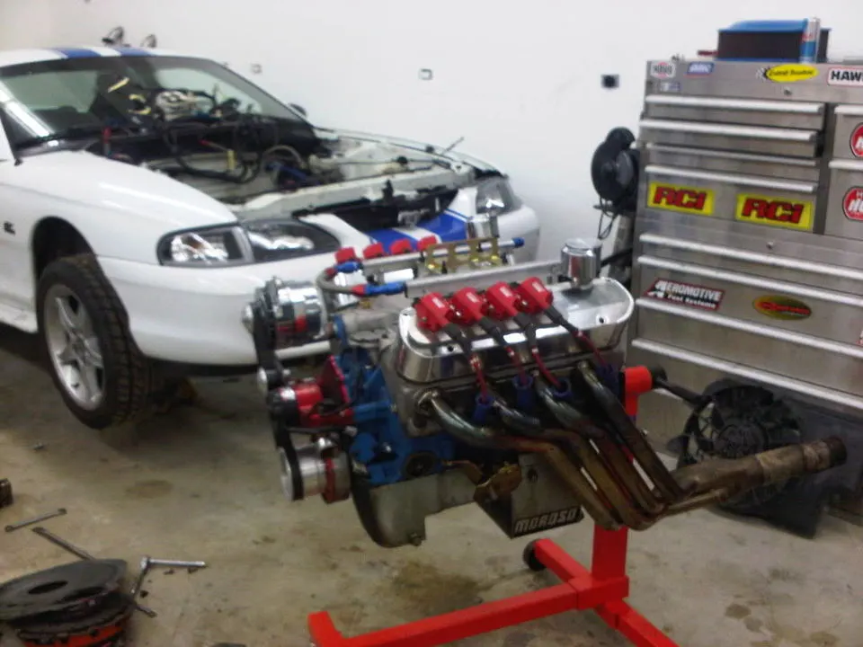

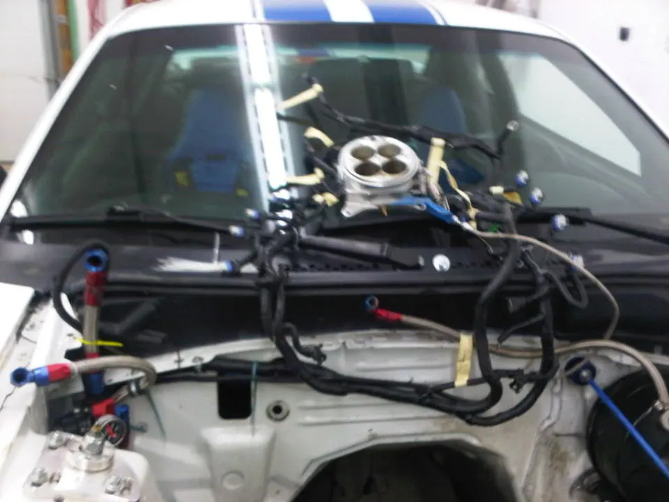

The car was wonderfully simple to remove the engine
Pulled the engine out
The majority looked like they where very happy.

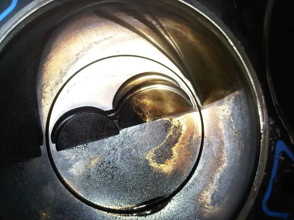

Except this one

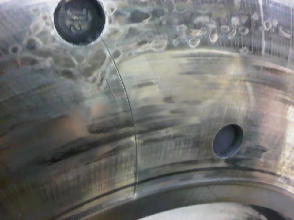

Also the flywheel had some marking that look like cracks. I have to talk to someone about this. I don't know if this is not good or bad.
The broken ring land with pitting of piston crowns/combustion chamber and blown head gasket are sure signs that the engine was detonating. You might want to look into why this happened as you rebuild the engine and correct it so that you don't get a recurrence.

Typically when I see pistons burn out or break there it is due to severe heat or detonation. That area with the relief so close to the edge is where they burn out/melt first.
Once you get it apart, look on the underside of the piston above the wristpin, you may see some signs of detontation there, heat/blueing, at times the pitting is not on the top.
I know down here in PA they have swapped over to the "winterized" gas which has a lot more oxygen content in it, it greatly effects the tune on pump gas. We torched a head gasket once year fresh off the dyno with a real safe tune, stopped at the gas station on the way to to track and filled it up...first pass, lean and pop. Pulled the crown up on the pistons, Id pull all the pistons (which I assume you are going to do anyway) and inspect the lands, you may find further damage.

BTW, severe heat in the flywheel, if the crack is not that deep you can turn/surface them out.

I travel for work so I haven't been home to tear the engine down. I will be going through this engine throughly. I also need to replace at least two pistons. The one in the pic and then cylinder 1 had a part of the ring land jump over and put three good pops into that pistons. Thanks for the info. I will update this thread once I have it torn down completely next week. Cheers
