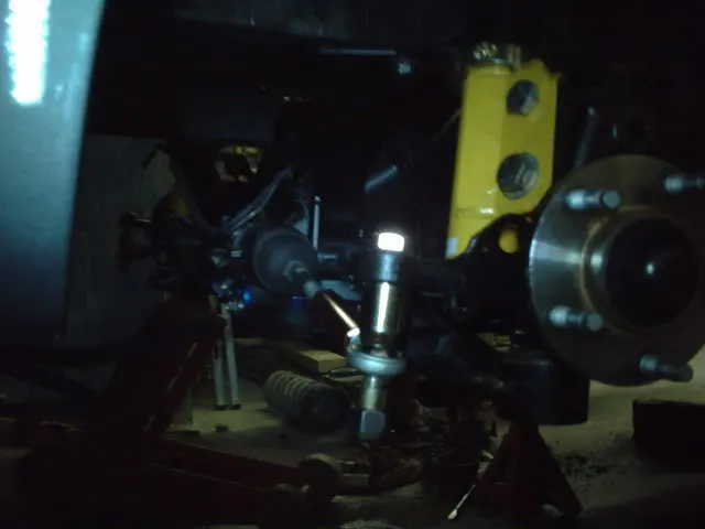

The tapered spacers in that kit are ment to focus all the clamping force against the tie rod. MM also requires that you use a mill to drill out the hole. I grabbed the wrong bit the first time i milled mine and made a hole FAR too big, second time around with the proper bit i had a hold that required me to tap the bolt with a screw driver to get it to go through.
I recommend buying the kit as well and only using the straight bolt kit is if its required like in my setup.

found a picture back from when i did mine, now i have a 5 axis mill, do NOT use a drill, drill press etc to do this, it will NOT form a tight fit and will be loose.
