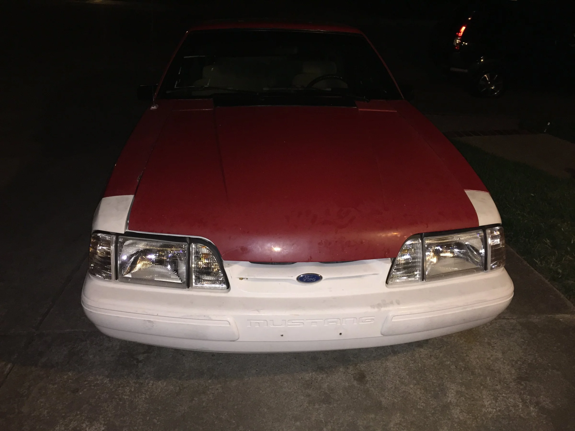

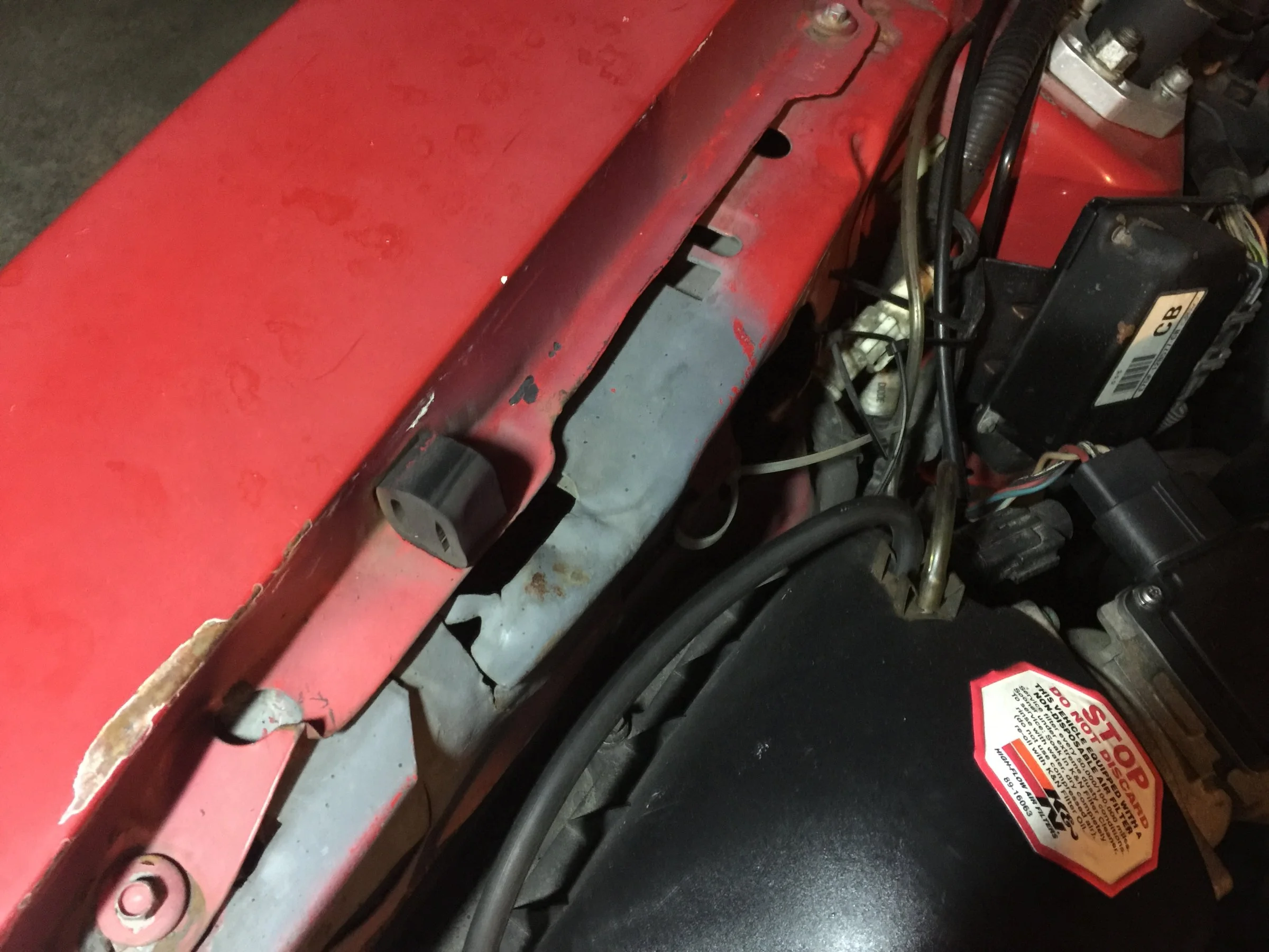

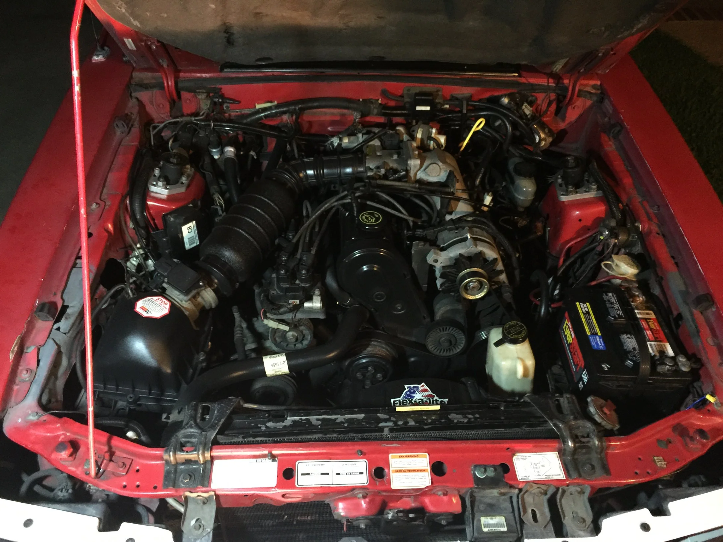

Having trouble aligning my hood, there's a big gap between the left fender and it's scraping against the right fender. I noticed the engine bay frame that's connected to the fender is a little bent in. Could that be the problem? And is that a pricey fix?
Yeah, it's been hit somewhere in it's past.
Would you take more pictures of the front for me?
You will probably need to have the frame pulled to really fix it right.
Just hard to tell without more and better pictures though.
These are the other pics I have, but I can take some more when I get off work.

I just looked at it at home. It's easier to see on my iPad instead of that little 2" screen on my phone!
It looks better than I thought.

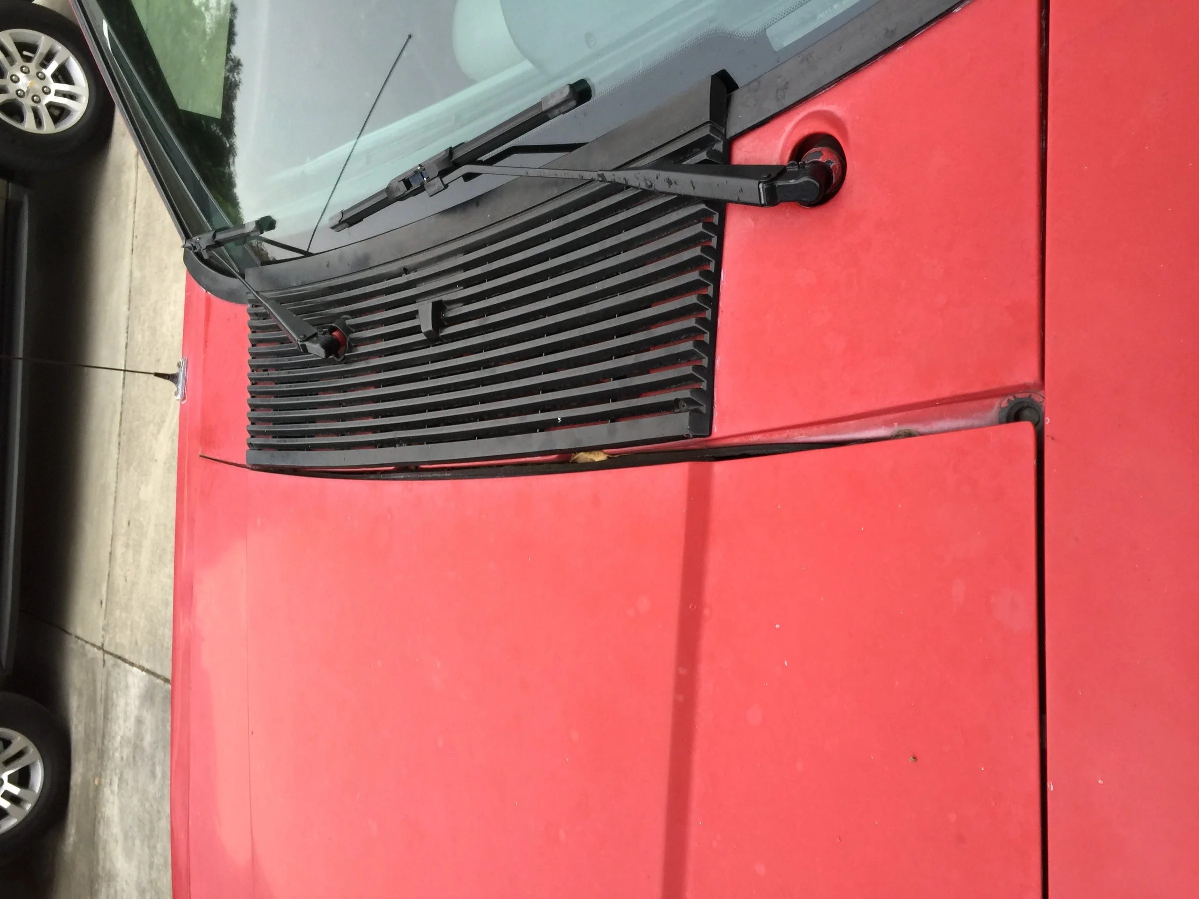

I can't see the gap at the back of the hood, what's it like? Is it even from side to side?
@Davedacarpainter you think he may have some room to move the fenders out for clearance?
There is a small amount of adjustment for that, but, based purely on the pictures we have, I think the hood just needs adjustment. It kind of depends what the gap at the back of the hood looks like.
Sure, the right side has been tweaked a little, but not enough to cause that misalignment, I would think. The latch probably has been knocked over a little to the left too. Easy fixes, depends on that back of hood gap.
right, but the front to back alignment won't fix the gap problem between the hood and the fenders, unless I am looking at the pics wrong. I don't see enough gap on both sides? He needs to adjust the fenders out a little, no?
The gap at the back will tell you if the hood is just misaligned. I'm thinking, if there isn't much problem from the wreck damage, that the hood gap will be tighter on the driver's side than on the passenger's.
It's pushed quite a ways towards the driver's side, if it just needs to have the hood and latch adjusted, the fenders may be alright except for that small buckle in the right fender.
It might just need the latch adjusted slightly to the right. That might fix it all.

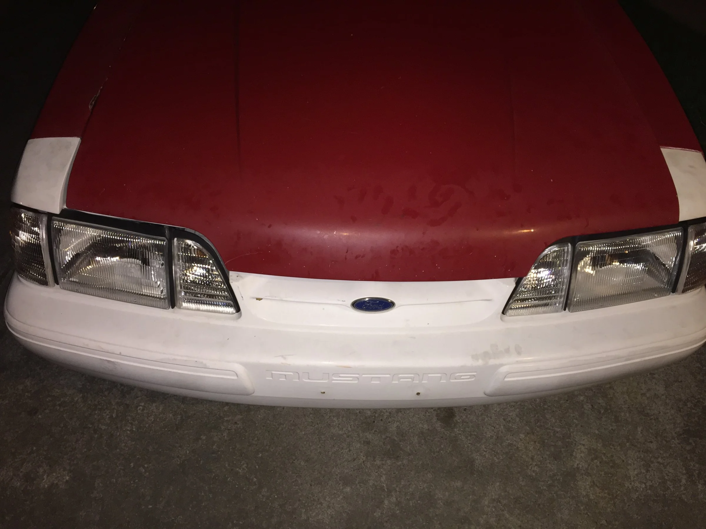

Thanks for the reply! I will try adjusting the latch when I get off work. Hopefully that'll fix the gap issue. It's been such a pain in the *** lol
Wow, I looked at the hood picture. Your front end is tweaked to the right definitely.
It will need to be pulled straight again with a frame machine. If you lived close to me, I would do it for nothing for you.
You probably could adjust the latch a little, but even a little will cause the right rear of the hood to dig into your cowl panel.
Do you have any friends that work in a body shop? If you do, then you could probably get it pulled for a fifty (or a bottle of good bourbon @madmike1157 !).
It really will need this done though.
