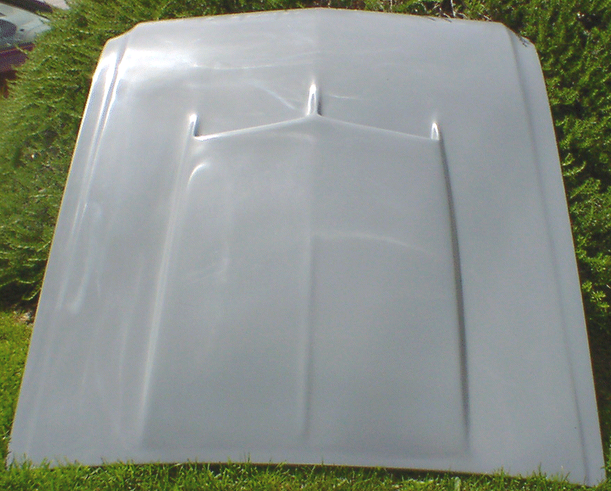

but I also have this fiberglass hood sitting in my basement that I have been saving
would it clear that you think?

I am running the same motor/intake setup on my '68. I'm using the TCP mounts which give it a little more drop. Everything is tucked under my Eleanor (gasp!) fiberglass hood which is open under the scoop, and it is still tight. I do have a standard round chrome air cleaner, so a drop base may would be the missing piece to get you by.

I have a 68 mustang with a custom 408 stroker and i am using the same motor mounts that came with the 302 it originally had. I also have a 3 inch cowl induction hood so clearance is not an issue for me.
the stealth and performer rpm intakes are only an inch taller than the stock 351w intake, and usually with a drop over style aircleaner it will fit under a stock hood, though clearance is tight. however the victor jr intake is almost 3" taller than the stock 351w intake, and even with a drop over aircleaner, it doesnt fit under a stock hood. usually a 3" tall hood scoop is needed to clear.
