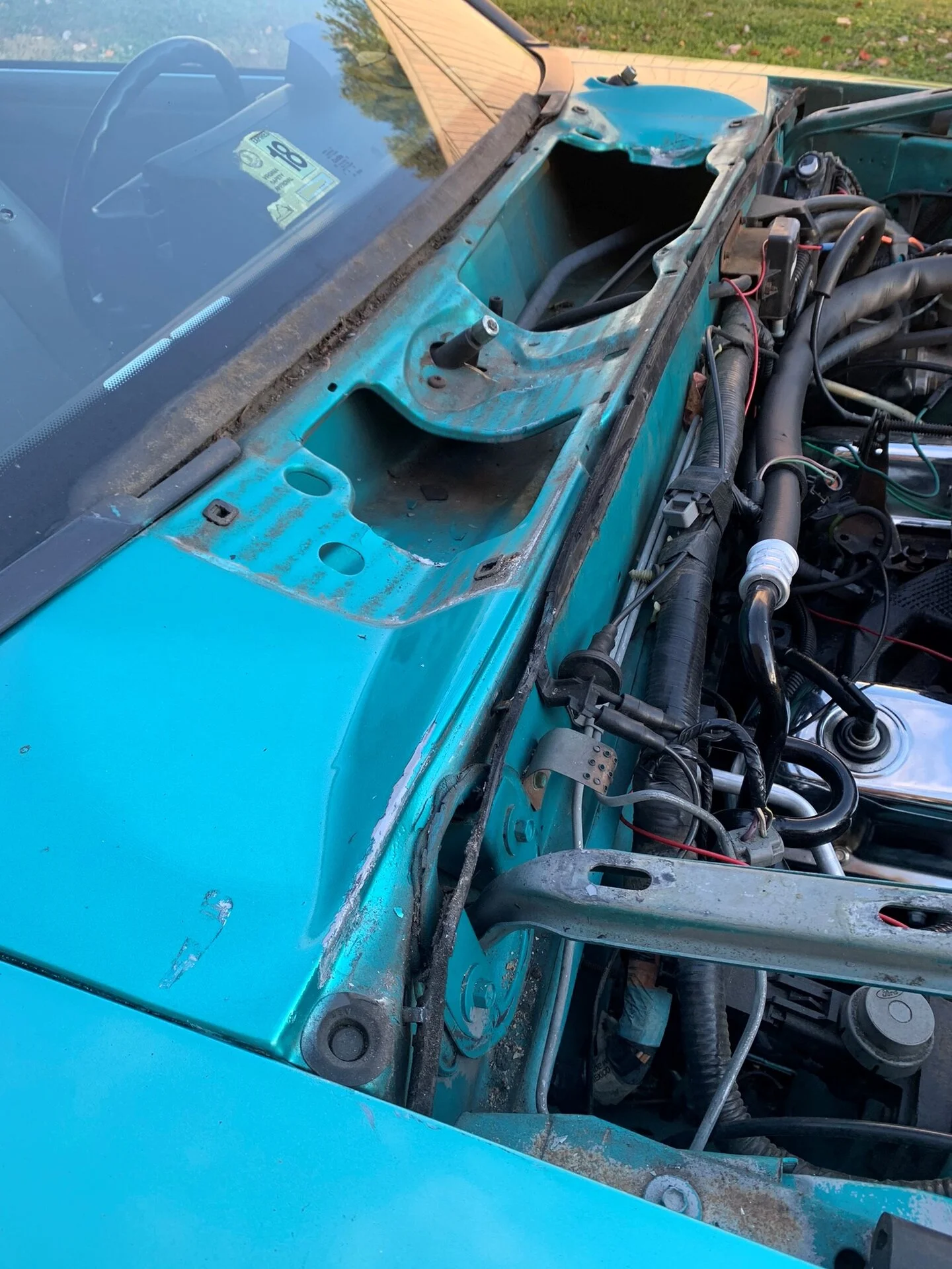

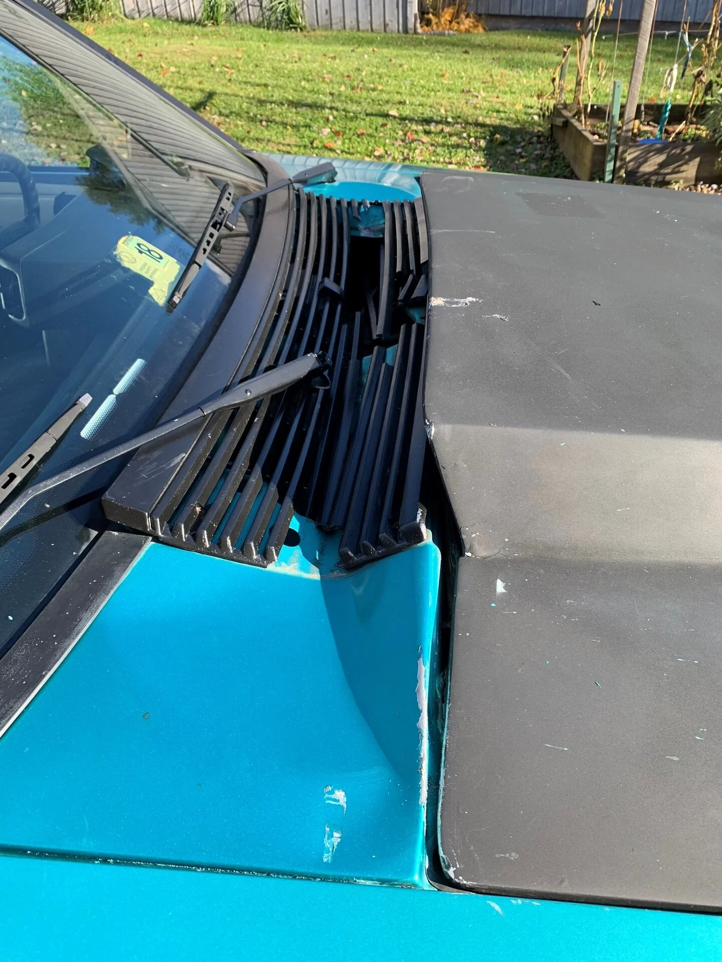

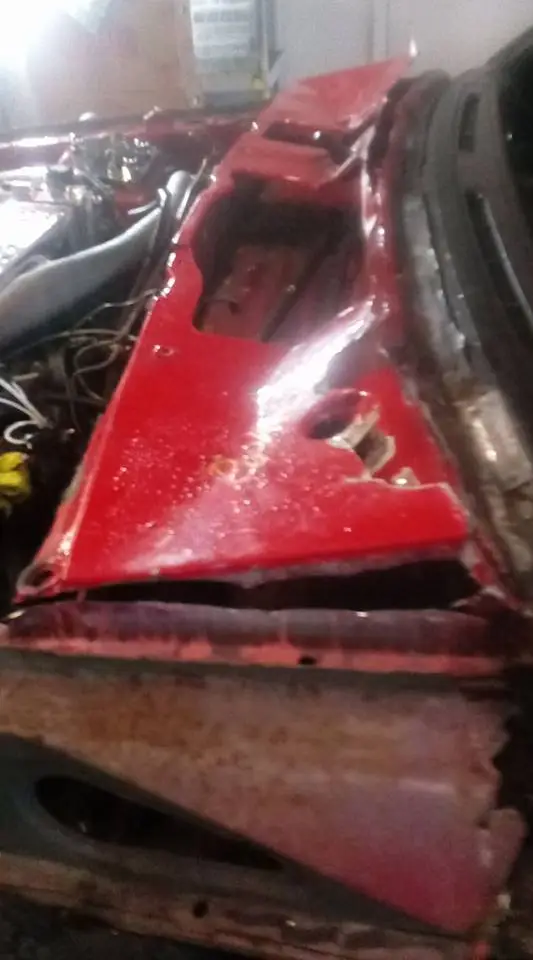

Driving the other day and my hood flew up. Screwed up the cowl area pretty bad... Hood is toast and my hinges are all beat up. I was quoted $1150 for full repair of just the metal... Don't really want to pay that much for such a small area of damage. Has anyone fix this themselves or have any ideas?

They aren't terrible to fix. You need to remove the hood hinges and the wiper motor and linkage. Whatever you do do not use a dent puller.
The hardest part to fix is the drivers side. There's a brace that runs below the top piece of metal. The trick is to gently message it back into shape. People use foot balls ( deflated and air up inside cowl ). A hydraulic dent repair kit from harbor freight will get under there too. You don't want to push up on it with anything with a sharp edge or it'll put point marks in it. You can use plywood to brace above a pry bar to leverage on. Multiple side share blocks of wood help. When flexing up tap around it with a flat end metal hammer or lightly whack with a small rubber mallet.
I've fixed a couple. ( I'm not a body man ). I try to straighten the metal around the holes first. It's got a small 90 in it and reinforces the panel. Then I work the dent from the furthest point away towards the center once the edge is straight the dent almost just pops right out.
That's got some gnarly creases, mine did not do that much damage so I was able to use a small hydraulic scissors thingy and a block of wood, got it good enough for my junk, that brace on the drivers side is a btch.
If it were me I would have to have it replaced but that involves pulling the wind screen, dash and dropping the the wiring and fenders, if you do most of the grunt work a good shop will charge less to do it right. That ride deserves to be done right.

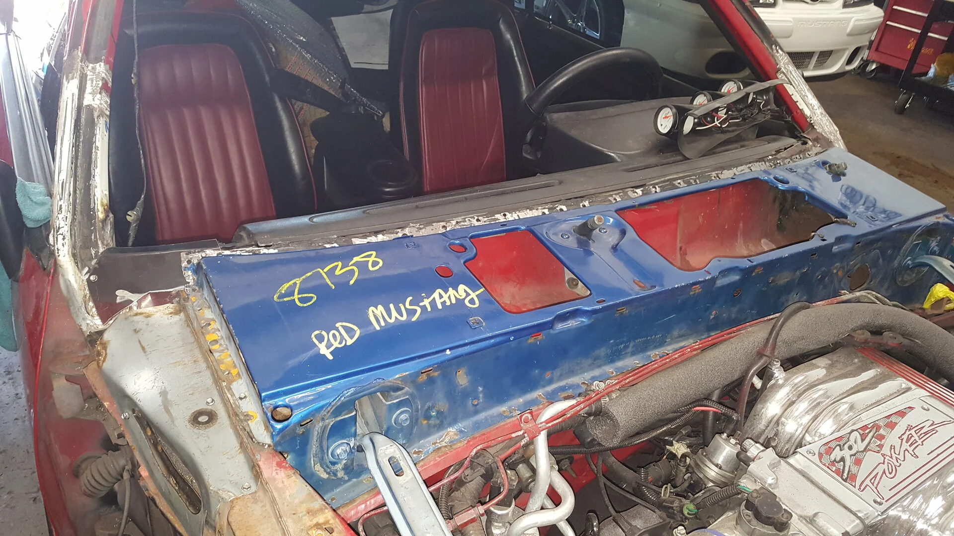

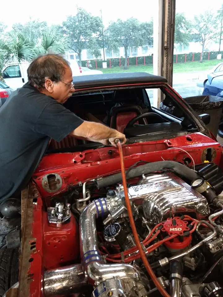

been there done that 5 years ago when I forgot to put my hood pins in. You can trip the football method and a small hand jack to bend it back up. I ended up cutting out and replacing the entire cowl section as it turned out there was rust all throughout the cowl and windshield.

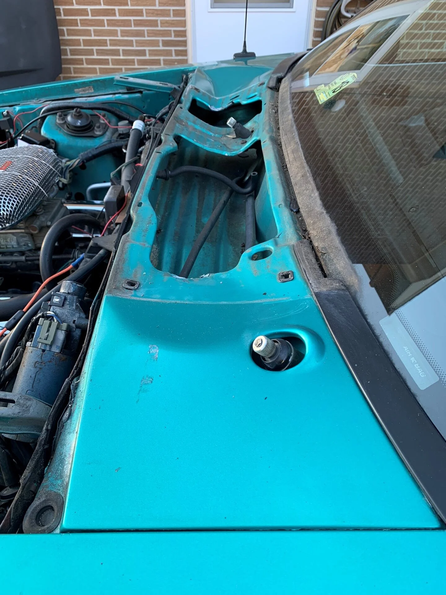

Football worked pretty well. I got the driver side piece pretty flat. I got the center piece bent back good enough for the cowl vent and wipers to fit/work. Passenger side is going to need more work. I can get the dent to pop out, but it pops right back in. I will have to work with it more.
I'm busy for the next week or so. I'll update when I work on it again.
