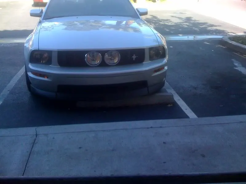

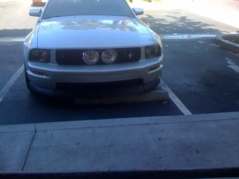

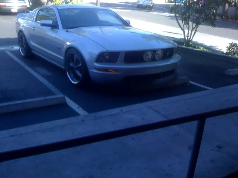

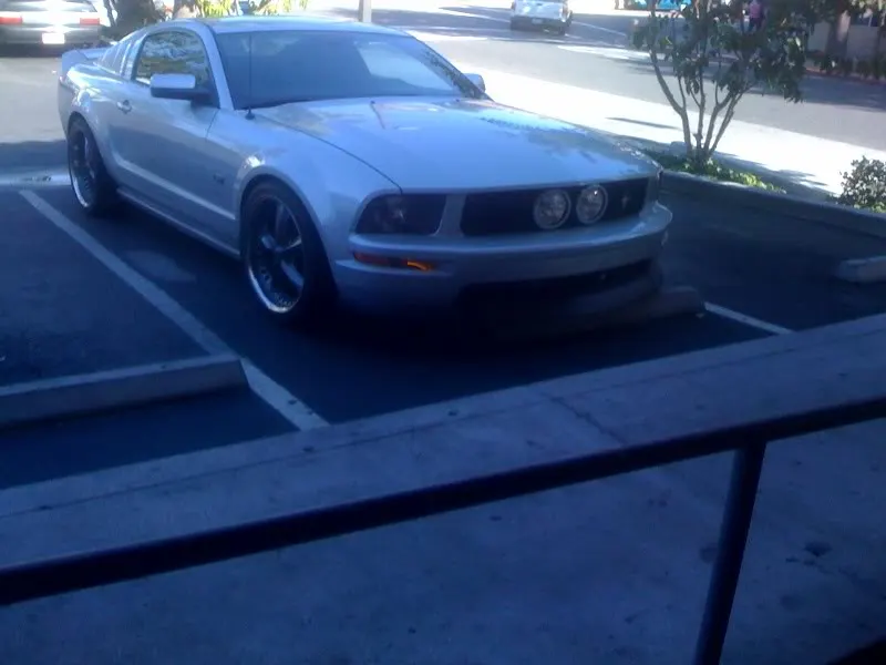

you can get the scoot drakes hood pins there like $60 there the same as the shelby but with out the shelby logos. check partscheap.com. On the grille go with the 3d it comes with the pony emlems and new bulbs. check my 3d grille with street scene chrome fog light benzels.

I just installed the Scott Drake billet hood pins (same as Shelby but without the logo). Haven't had the car out yet to test them but I didn't have the shake problem before anyway. I also just changed out my 3D Carbon Eleanor grille for a Street Scene black chrome center fog grille. Although I had some trouble with installing the fog lights on the SS grille (see my thread on that) in the end, I really like the result. The one thing that annoyed me about the 3D Carbon grille was trying to keep all the honeycomb clean. Lots of nooks and crannies that were a pain to get at.
