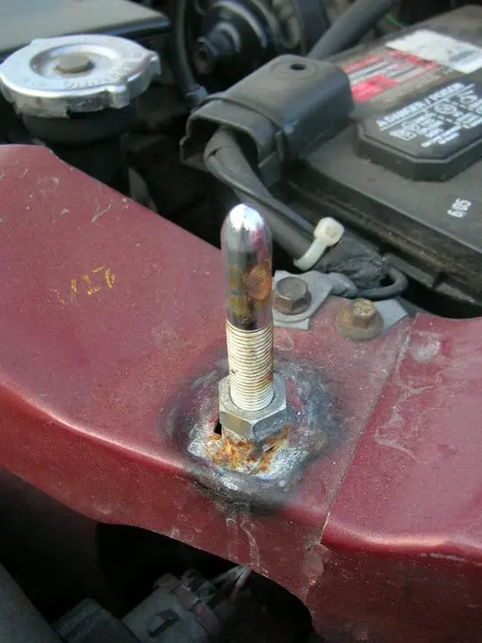

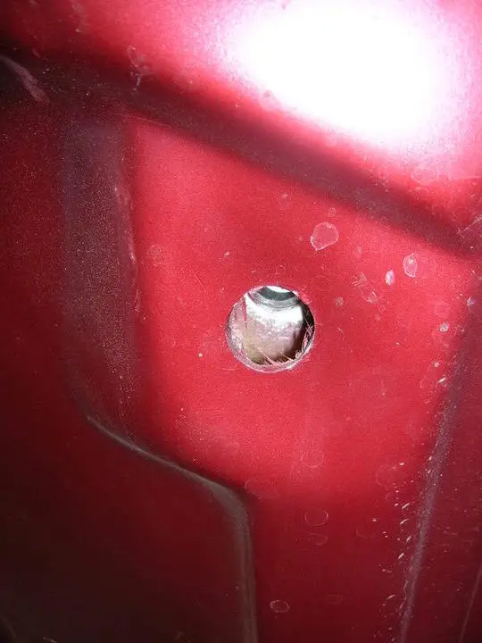

When i installed them i removed the rubber hood bumpers on the top of the radiator support. I then drilled out the hole big enough for the post. Then i welded one of the nuts to the rad support, screwed in the post, then tightened the 2nd nut against the one welded to the rad support. I then put some toothpaste on the tops of the posts, and closed the hood til it touched the toothpaste. Then i drilled out the hood from the bottom with a TINY bit so i wouldnt chip the paint since i was drilling from the bottom out. Then i got bigger bits and drilled from the top down til i got the posts to line up right, and til the hood closed. Then i adjused the posts to the right height and wala! Good luck.

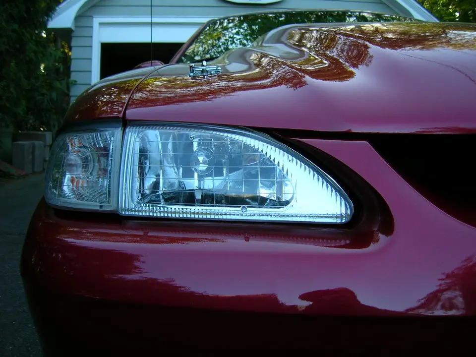

best pic i have:

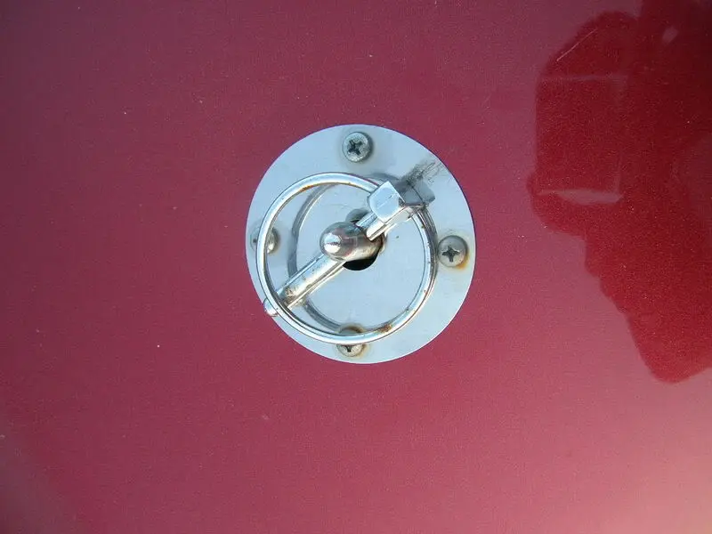

I saw a very trick set of hood pins on corral. They are called Aerocatch hood pins. I think they are unique and a nice alternative to the traditional style hood pin. I don't know very much about them but here are a couple pics the guy posted and a link to his thread about them.

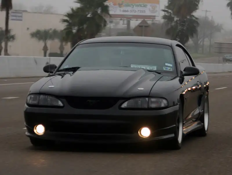

Here's a pic of mine. Don't have any of how I mounted the pins.
