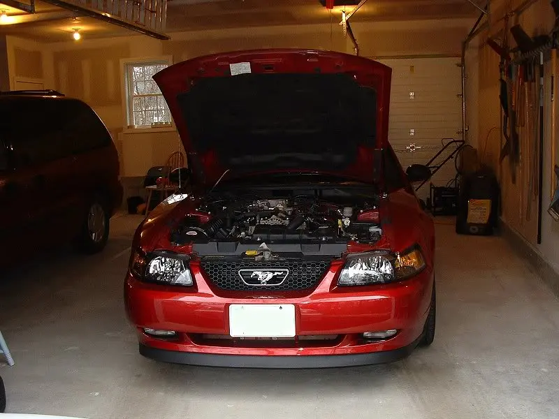

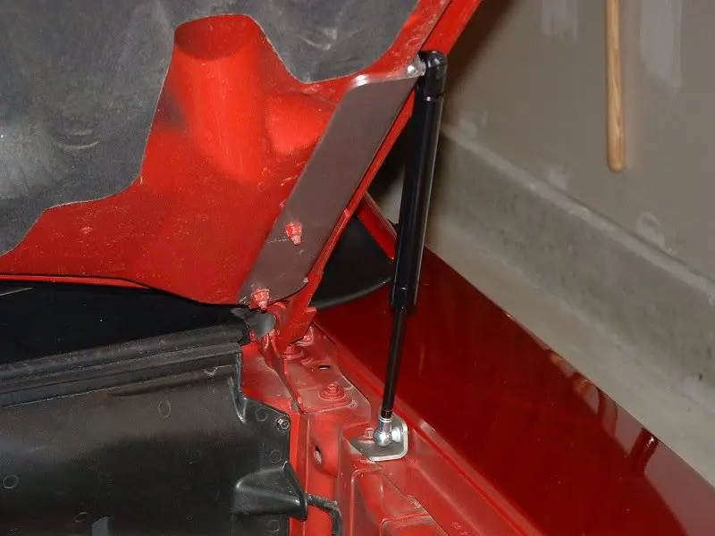

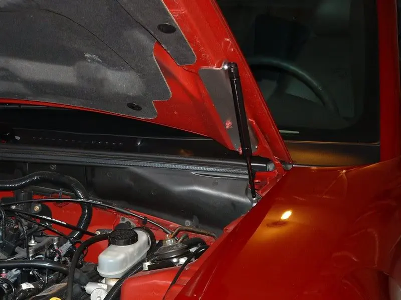

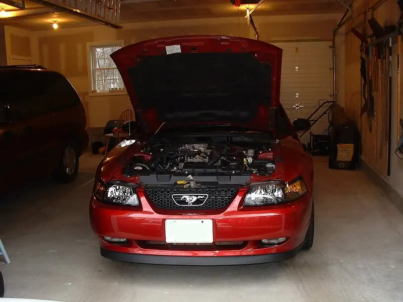

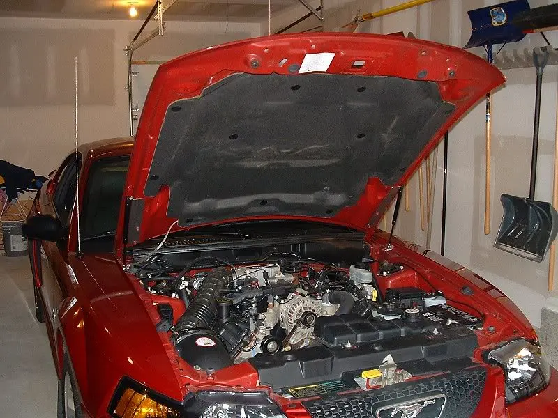

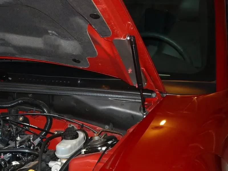

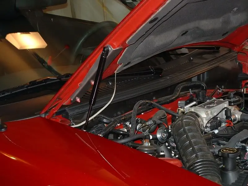

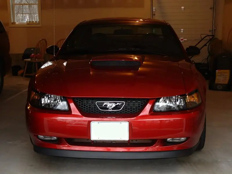

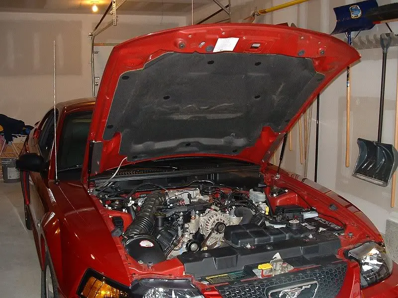

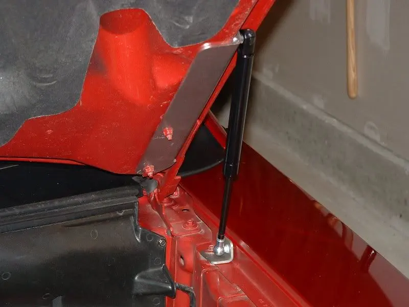

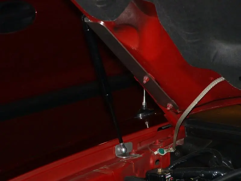

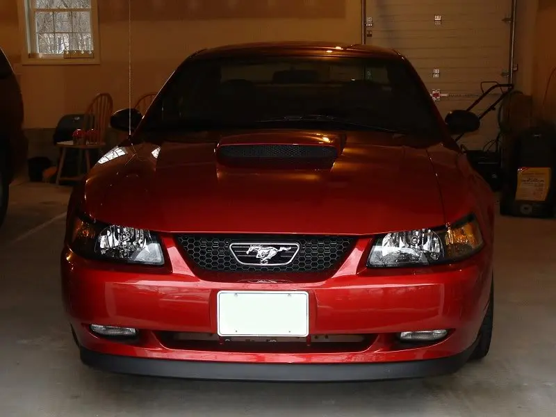

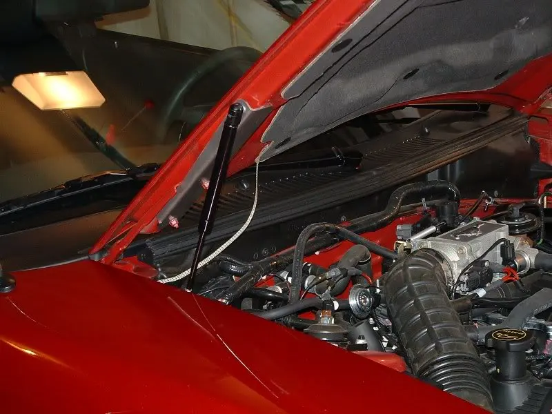

Installed the kit from MRT-Direct after work today. Decent kit, the only thing it is missing in my opinion is slightly longer bolts to mount the fender pieces due to spacers being under the fender clips. Great kit all around, much more room to work under the hood with this install. The struts hold the hood from the half way open point and will push it all the way open on thier own just past half way open. They have good holding power, it takes a good pull to bring the hood down :nice:

The struts used in this kit are shorter than the trunk struts used by Ford. The trunk struts are 19" pivot center to pivot center, where the hood kit uses 13" struts pivot center to pivot center.

Your not touching the hood any more with this kit than when raising and lowering to use the factory prop rod. Like other said, wash your hands. The struts only hold the weight of the hood from about the half way open point, less than that and it is basicaly in free fall when you close it so no you do not need to push down on the hood to close it.

They are slightly smaller in diameter than the truck struts, but I doubt the trunk ones would rub. The problem is what are you going to use to hold the strut ends? This kit comes with some stiff braces that bolt into place and distribute the wieght of the hood across the length of the brace.
The install on this kit was pretty easy, it's is a bolt on item. Although as I posted above I feel the kit needs longer bolts for the fender mount. With some patience it went on anyway. No drilling or rivits like the other kits. This kit was about 125 shipped.
