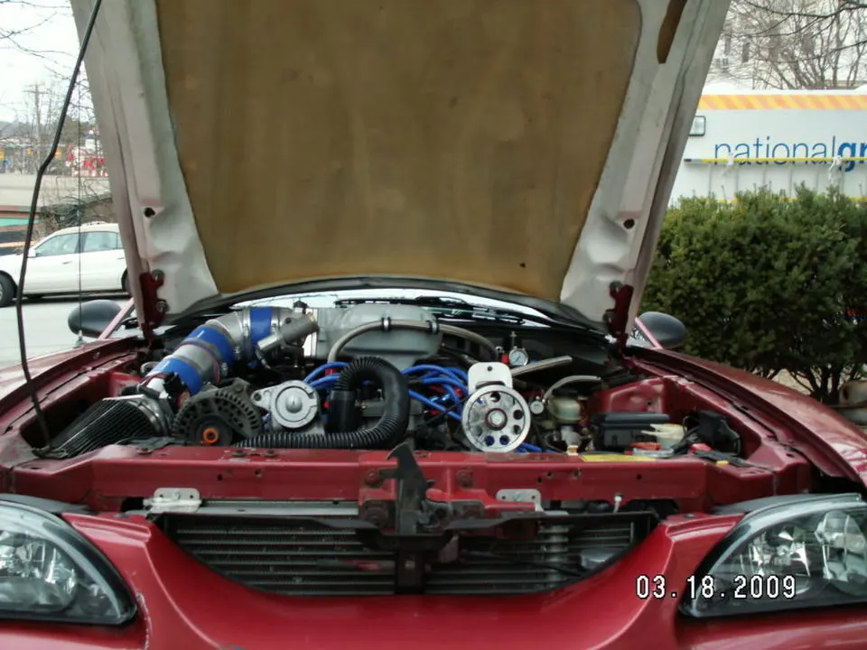

i decided to flip the plenum forward, I think I made the right decision lol
[/IMG]
[/IMG]
[/IMG]
:popcorn:...............
I do have a question, what do you have done to the engine? Looks stock:shrug:
lets see here
mark 8 shortblock
stock 2v guides with bronze sleeves
ported romeo heads
windsor cams
open pcv, no vacuum going to crankcase (big difference)
eddy intake
3484 plenum (eddy)
1" carb spacer
LSX TB (ported 78mm)
4" intake tube
longtubes
fidanza alum fly
zoom zoom clutch
bassani muffs all 2.5" mandrel
gss 340 walbro
fox radiator
behind bumper mounted overflow tank
udp's
halfway ****ty tune
thats the stuff i can remember
