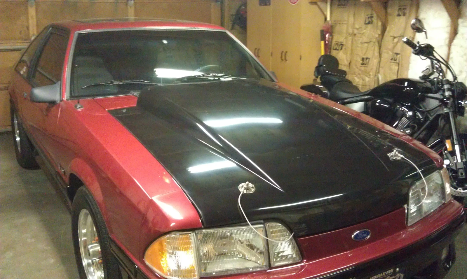

Here are mine, installed with a Boss FG hood. Ford Racing pins, the holes are a little bigger than the pins but that gives you a little wiggle room when you drill the holes in your hood. Water getting through won't hurt anything.
i like that hood bill. not so worried about rain getting in them just the looks of the larger hole.
