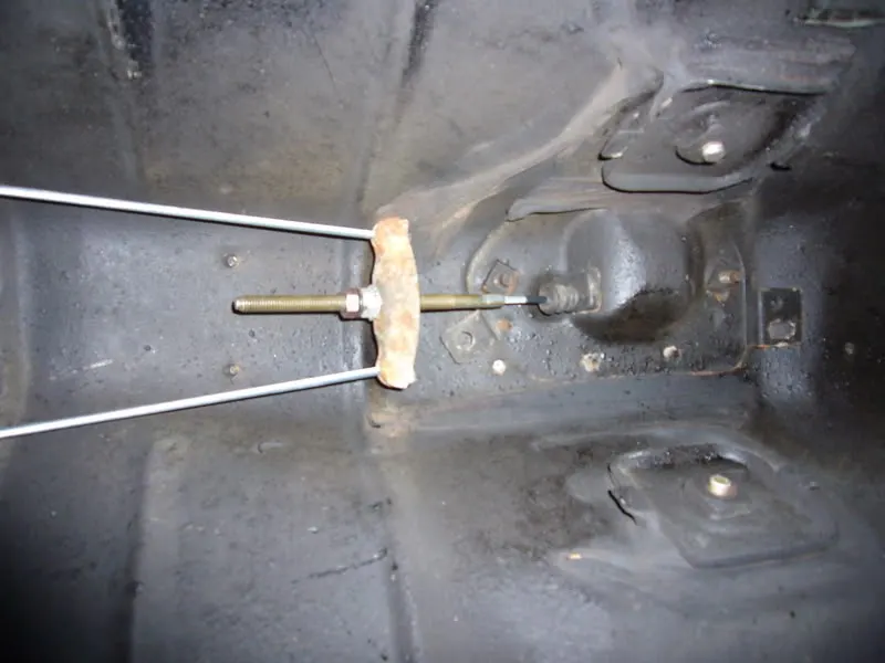

I welded the pawl on my handle and used a threaded adjuster on the front of the cables. I can't find the adjuster right now....
Jason 302
Aug 9, 2003
685
71
68
Newark, Ohio
Mar 14, 2017
  • Mar 14, 2017
nd this in a quick google search
Reactions: 92Apocalypso
