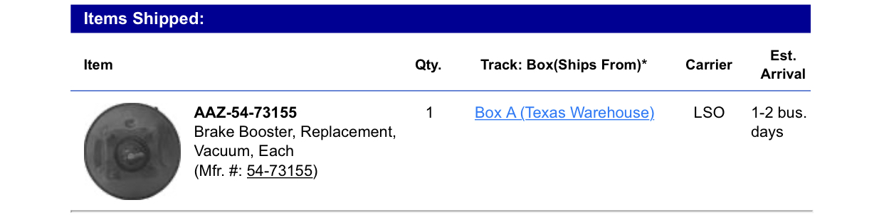

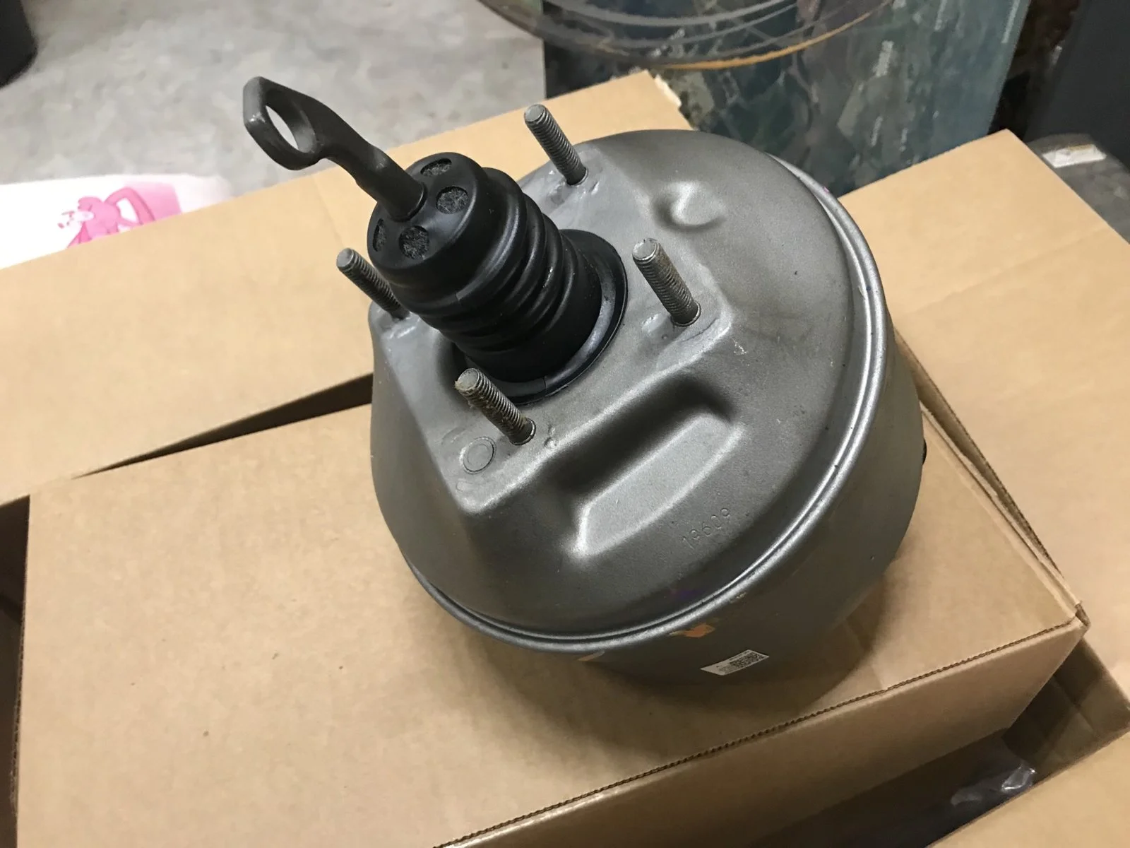

package delivery today:
Reactions: 95BlueStallion, 90sickfox, Rdub6 and 6 others

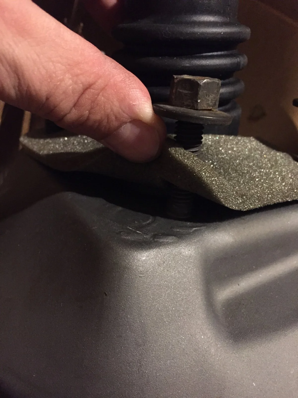

Just noticed is that a SN95 booster that they moved the studs on? Sure looks like it. @Mustang5L5

The sn95 rod hole is straight out and not offset like a fox booster rod. They don't interchange. That looks like a cobra booster to me.
Only for 96-98. For 94-95 it’s curved like a fox.
SN95 boosters are metric threaded, and fox is SAE. Easiest way to tell other than the offset lug. It’s a cobra booster.
All the remand have that welded lug look. Heres my Ford racing booster reman out of an m-2300-k Kit. Same moves stud

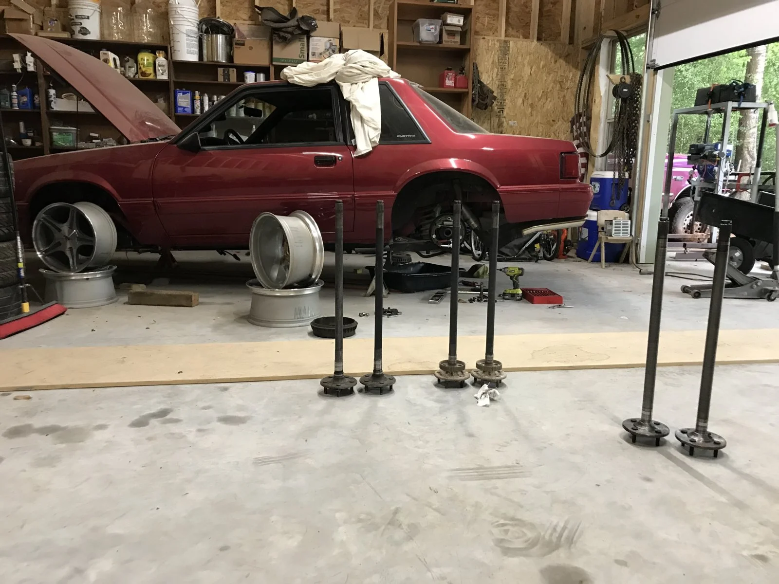

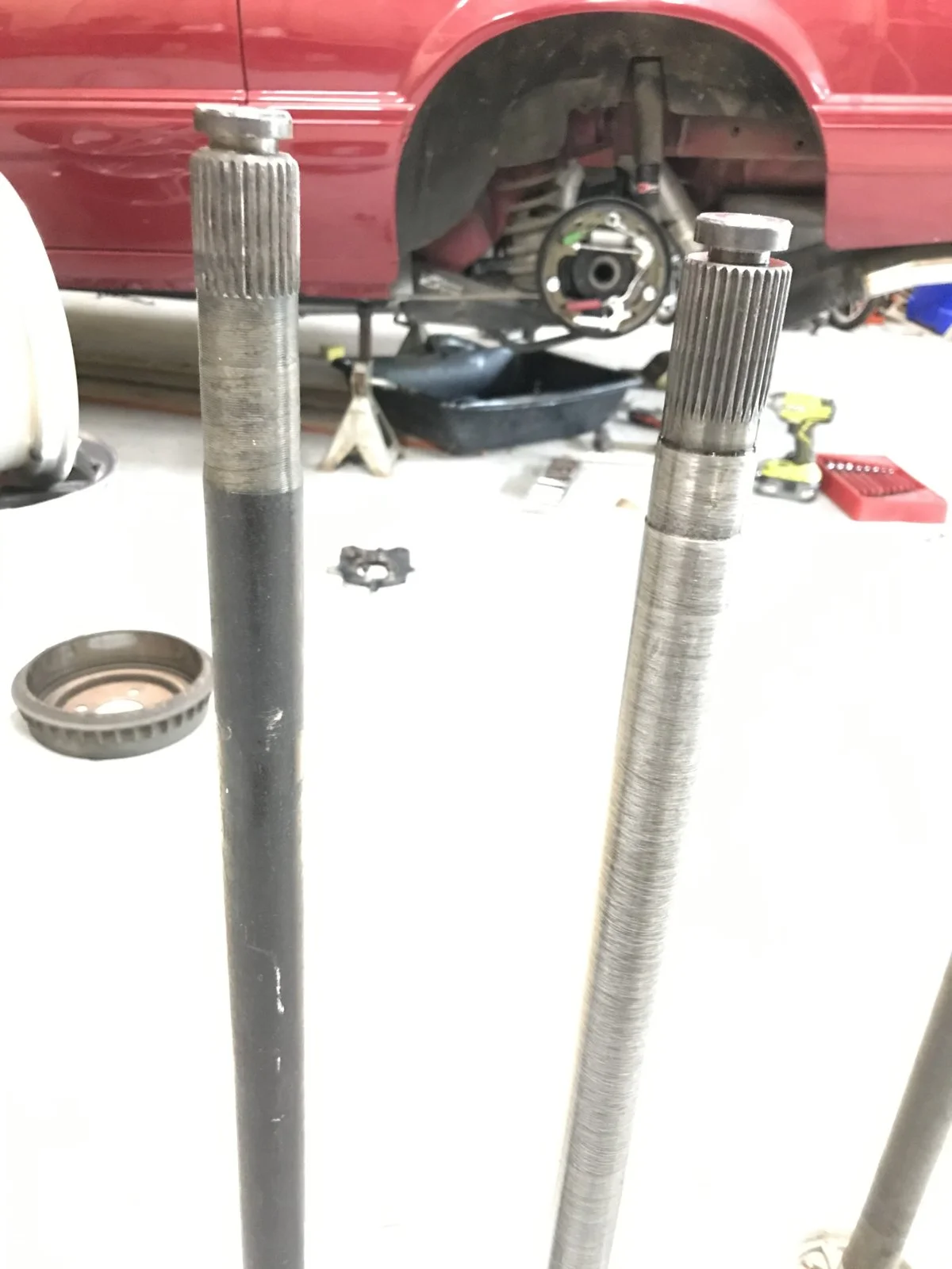

Spot the non-obvious difference. The axle that came out of the car is on the right.

Sitting in my thinking chair staring at 3 pairs of axles and can’t use a fkn one. I’m not mad at the fact there’s a 31 spline carrier in the car. I’m peeved that I finally got motivated to work on the car and immediately sat on my balls... figuratively speaking, of course.
