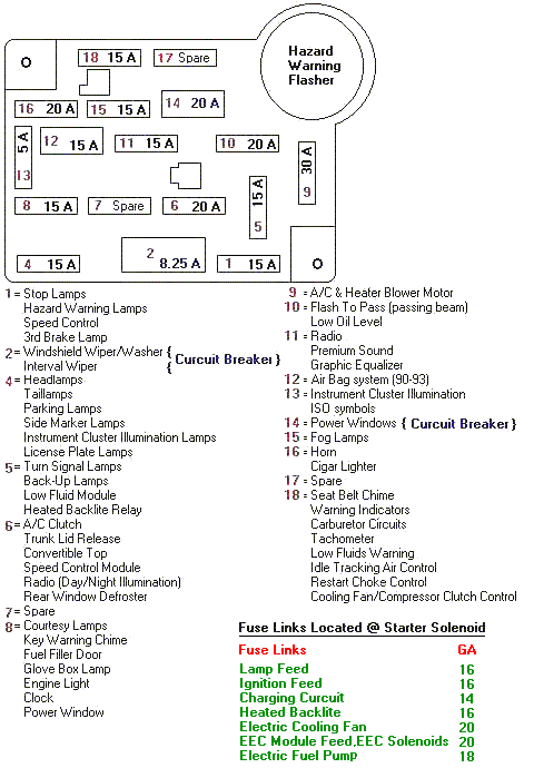

I was putting new radio in and blew a fuse that controls my heater fan, found which fuse it was after pulling every fuse ( no owners manual ) put back 30 amp like what was in it. Now when I crank my car, the low oil light blinks three times and low coolant blinks 2 times:bang:. The only thing I can think of is maybe put a fuse in the wrong place, the reason I say that I remember 2 or 3 slots had nothing in them, I had pulled out some got distracted with kids and forgot where I pulled fuse from. Anyone with ideas please send them and by the way I have aftermarket gauges ( oil and temp) have 60lbs oil pressure and let it run about 20 mins and temp got up around 175, run perfect.
See the following website for some help from Tmoss (diagram designer) & Stang&2Birds (website host) for help on 88-95 wiring http://www.veryuseful.com/mustang/tech/engine/
Ignition switch wiring
Fuel pump, alternator, ignition & A/C wiring
Computer, actuator & sensor wiring
Fuse panel layout
Vacuum routing
