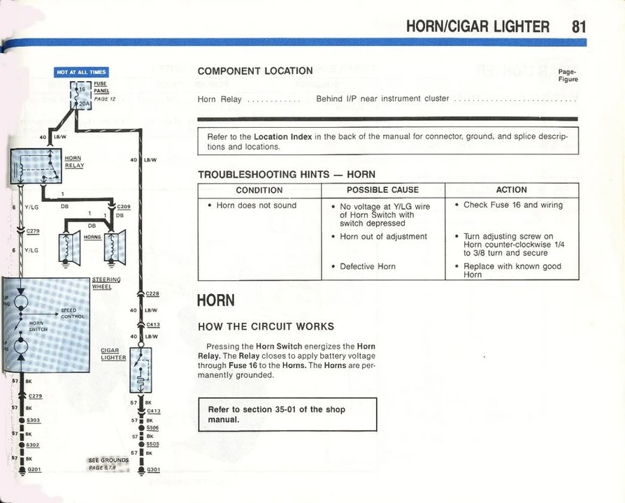

I found the answer by pulling one at the yard. Horn brush is located behind the steering wheel. On an 85-89 they look like this:
The reason I was looking for a new brush is that one of the pins had broken off the brush and thus the horn no longer worked. In a 1984 the brush is set deeper in the column by way of a tower-like housing. Meaning that the brush I needed was longer. Fortunatly I salvaged the pins and springs from an 89 mustang and put them into a an 84 brush. Worked dandy. Problem solved.
