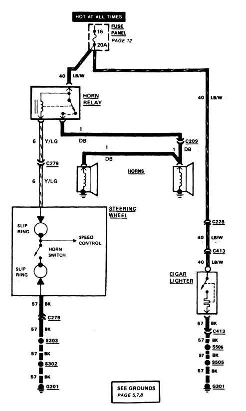

The horn on my 89 used to work when I first bought the car but now it does not work nor do I hear any clicking when I try to push the button. If it means anything the cigarette lighter does not work either. How should I approach this problem? Bad fuse likely?
There's your wiring diagram.
I'd start with the 20A fuse
