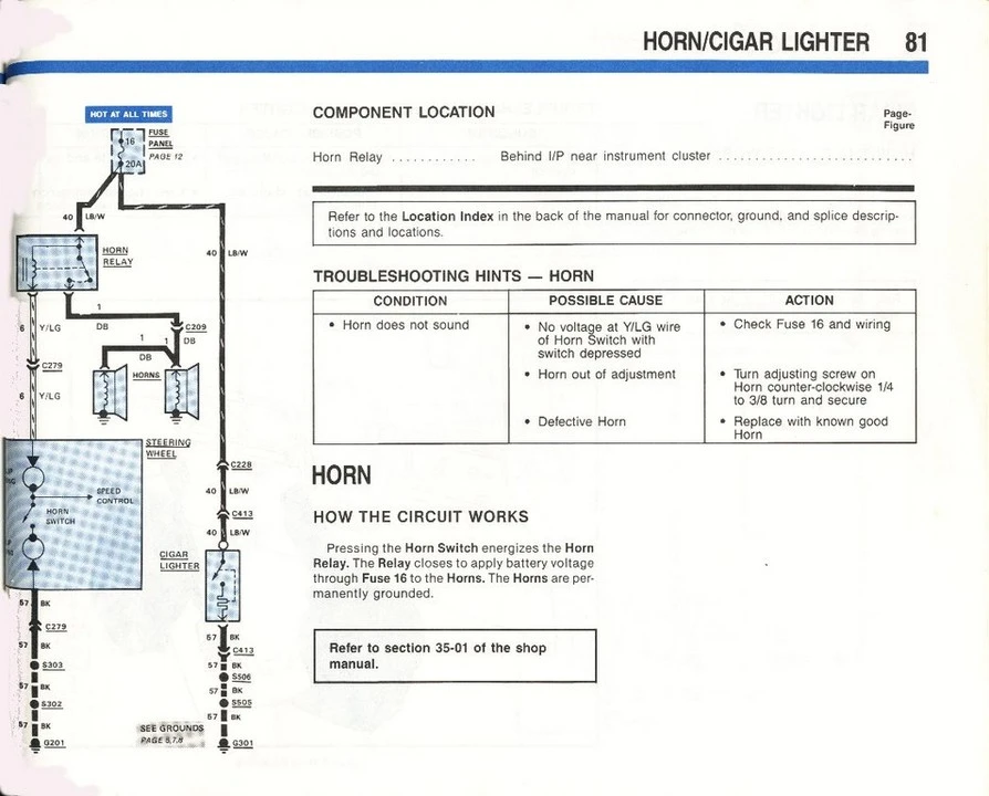

Hi I'm the new guy with a couple questions. I have an 88 Gt and I cant seem to be able to locate a horn relay does anyone know where it is hidden? One more I changed out the cluster that had the speedo that stopped at 85mph to a 140mph all is good but it is about 10 miles per hour fast is there anyway to calibrate it? Thanks for any ideas .
