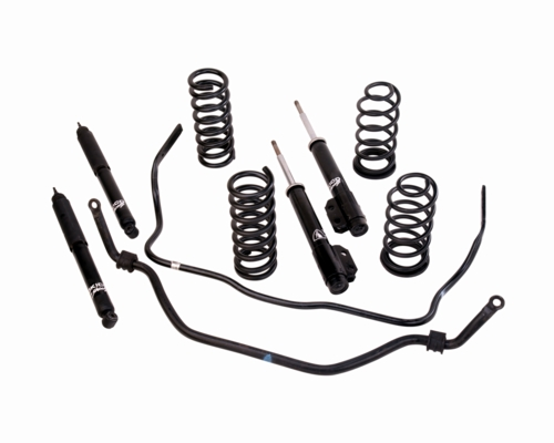

How about this suspension setup?
Ah yes, my old friend M-5400-A... I have recommended that kit dozens of times on this board. It is a good choice and I believe some have reported finding it for as little as $369 :nice:
No CC needed. The drop isn't dramatic enough.
For traction, add what Tom said, MM LCAs.
Correct me if Im wrong, but wont this setup decrease straight line traction? The stiffer springs will reduce the body weight transfer.
Skidzz said:
Not to hijack this thread, but would you need c/c plates with this setup? I was going to go with h&r springs and bilstein shocks/struts, but this kit is looking a lot more appealing with that price tag....
not really but since you're taking everything off you can just throw them in, they are a worthwhile piece to suspension
If you're looking for improvement at the drag strip, start with drag radials.. You can get a pair of nitto 275's for your stock wheels for about $300 and will likely drop your 60' by 2 tenth's or better.. With practice mine dropped 3 tenths consistently with just that.
