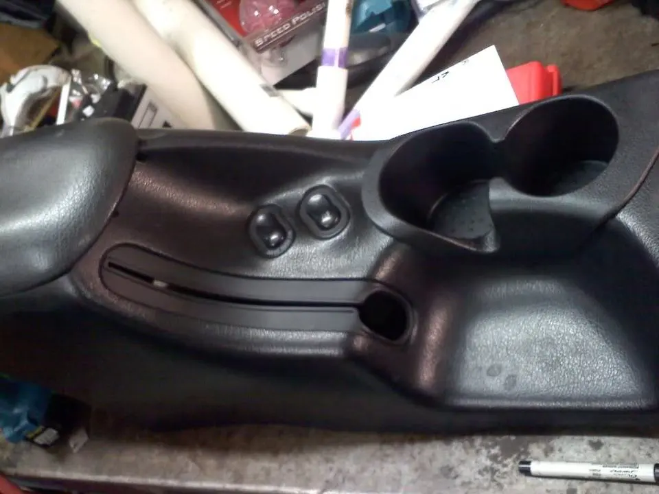

Update on my project ..
Decided not to leave the cup holder gray and had the cup holder dyed blk. and replaced the rubber parking brake liner. :D Still waiting on rtv to dry before installing.
waiting for a smaller blower pulley, and 60# injectors to arrive so I can finish the engine mods.. :D

looks great! 2 questions: (1) did you use the e-brake rubber you linked on my other thread?, and (2) how does it attach to the console?

Used this one...
[FONT=&quot]1994-97 MUSTANG PARKING BRAKE HANDLE SEAL - Classic Car Parts[/FONT]
The site is a little funky but it worked, ordered on line and the guy I finally talked to was nice..
It has a formed plastic piece that sandwiches the e-brake rubber. The console has tabs that stick up and go thru the rubber and plastic piece then are melted over the thin formed plastic piece. We used a soldering iron to remelt the tabs. Most of them were not reusable so we used them to align the part remelted what we could and used rtv to hold the rest... took about an hour or so. Of course the console was already out.
Hope this helps should have taken a couple pictures.

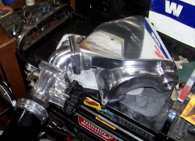

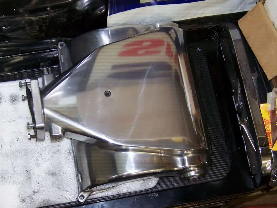

20 hours into the Holley and shes not quit done lol maybe another 25 or so and shell be finished. The TFS elbow well thats going to suck up another 30 or so hours. uggggg... All in all the engine bay make over and a few interior mods should be done and ready for Carlisle

I CANT BELIEVE YOU ARE POLISHING NOW. I am done and so over with polishing stuff, it gets dull and you have to take it off and polish it again over and over, it gets old. I personally liked the black engine bay look your car had.
Good luck tho, When it's clean it looks tits :)
Haha Hollywood I hate polishing crap also. The project started out with me just wanting to pull the systemax logo and ribs off the intake. After I ground off the lettering I asked a few guys what they thought about going polished and the overall opinion was do it, it will look hot. Ughhhh Im still not sold on keeping it polished. I do have another plan for it if I dont like it. But since I have already made a few changes to the engine, I have to atleast take a look at it on the motor. Heck if I dont like it I can always go back to my original plan. The only thing Im wasting is time and during the winter thats all I have is tons of time lol.
Thats sick as balls rich. At least it will be easy to powder coat it if you dont keep it shiny.

Thanks travis.. We will see how i like it when I get everything back together. Like you said, powdercoating it again is still an option.

Also, 95Opal intake looks nice. Way too much work for me though! Every time it looked dull Id be all over it again.
That intake looks amazing. I still haven't tracked down my alternator problem yet. I'm now entrenched in the flooring project. At least it's warm inside the house.
