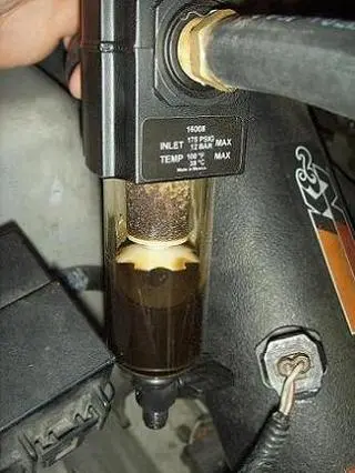

Put a pcv air/oil separator in there, and you'll be amazed at how much oil it collects (which would've just been burned.) My '04 with 8k on it filters out easily a tablespoon every 25 miles.
oil separator
You got that right. Check out the pic. This isn't the small $12 size that most people are getting (like the one Steeda sells). This is the larger size. Why? Because the smaller one can't hold more than an ounce without the intake sucking so hard to draw up the oil. For those that have the small one, ever notice how it never gets more than 1/3 to 1/2 full? For those that have used Seafom on the intake, you know how hard the damn thing sucks through the PCV hose. That much oil was caught in 400 miles ( 2 to 3 ounces). This equates to about 24 to 30 ounces at 5000 mile interval oil changes. I change mine every 3K to 4K.
