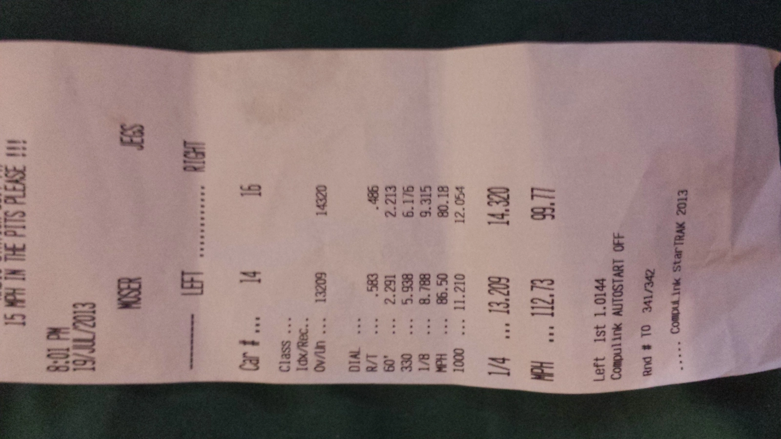

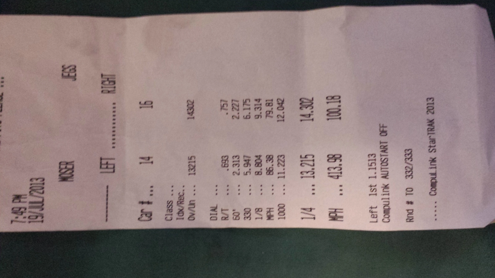

Tracked my car for the first time ever. Sure its not just those either but anywho. Guess I'll start with the mod list. Trickflow 75 mm tb and plenum, bbk cai, o/r x-pipe, flowmaster mufflers, Excedy clutch and flywheel, H and R springs, tokico blues, Welded in sfc's and Upr rca's with spherical bushings, 3.90 gears, sct tuner and some sumitomo 285's on 18's . I only made 2 passes at 2k launches felt like it fell on its face a little at the start then hittin 2nd was almost the same amount of spin i'd get on the street. I was runnin 2.213 and a 2.215 60 ft's which I know isn't to hot and my trap speeds were 100 mph each pass at a 14.3. Weather was about 90 degrees and it rained about 3 or 4 hours before track time but any advice or input would be great. I think I got to many mods for those crappy track times.

Actually heres my slips foundem in the car after work.
