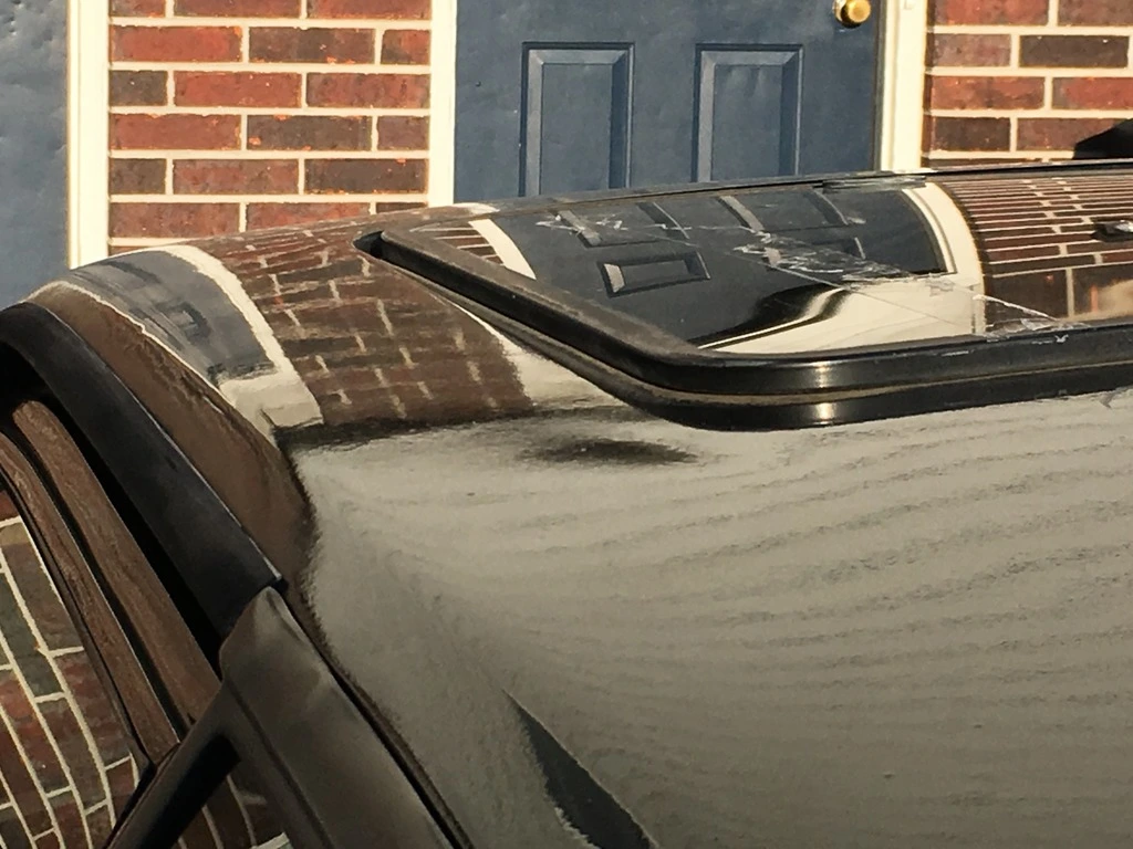

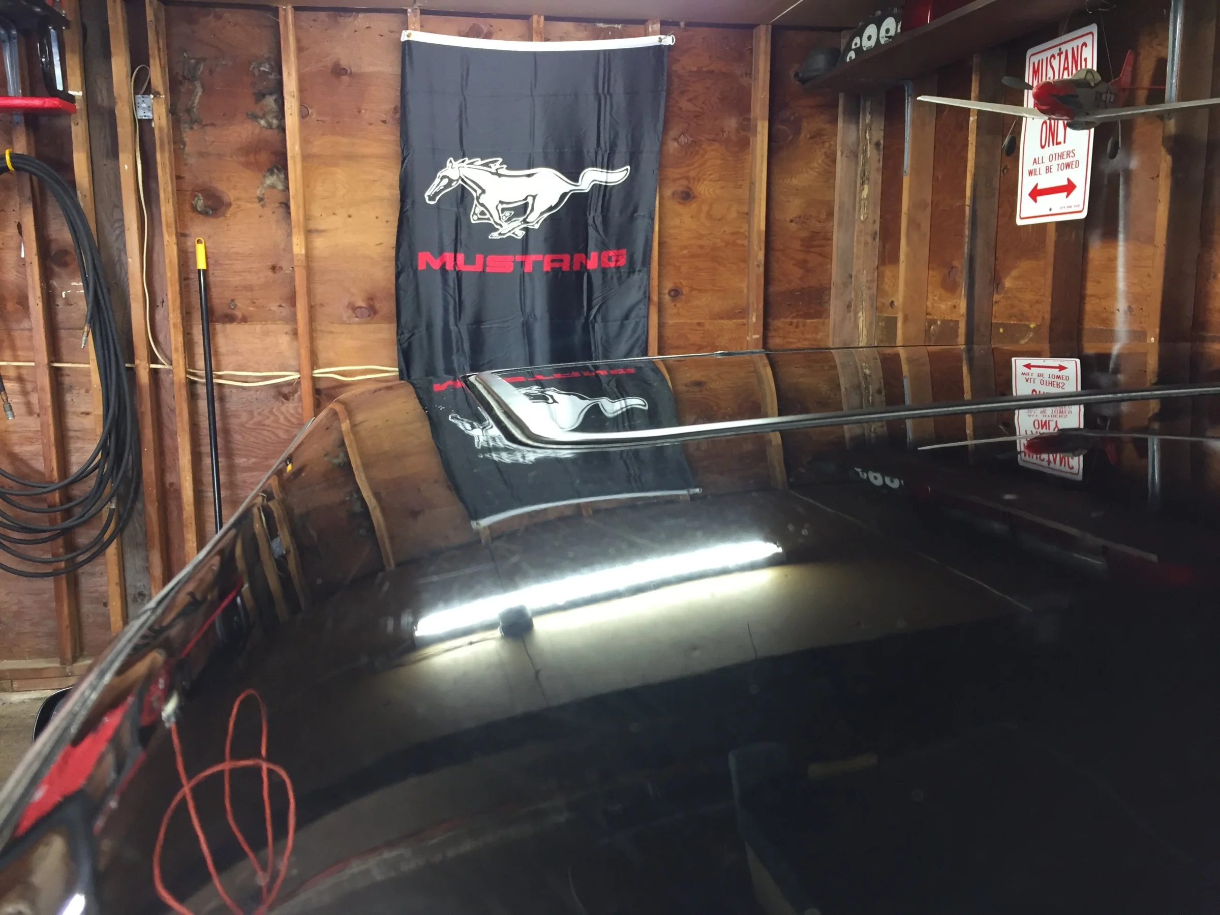

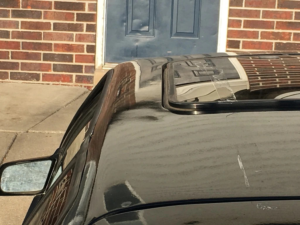

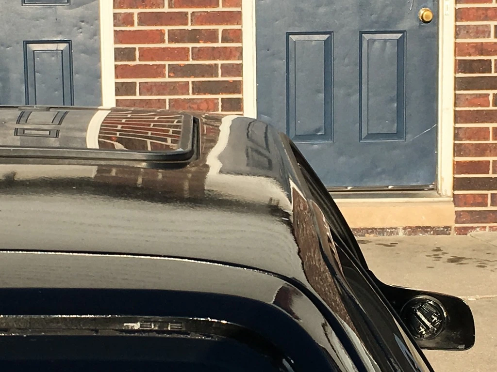

Just had my first day at the track with my GT40 engine build. Couldn't get out of the 14 second range due to bad 60 ft :/ Always either wheel hopping or spinning the tires through first. I'm looking into sub frame connectors and boxed lower control arms (avoiding slicks). Now I'm wondering, I know already that the hatchback cars aren't as ideal as the notch's because the body is less stiff/heavier. But what impact does having a big hole in the roof have? Do non-sun roof cars have any bracing there or is it just thin steel? I've noticed that my car is small dents right above the B pillar behind the sunroof and I wonder if this is from body flex. It also appears to bulge out to the side slightly but barely noticeable. Please see the pictures below of the roof in the reflection of some straight door frames for reference and tell me what you think.
I'd say the difference is negligible. Not something i'd worry much about.

Huh I didn't know it should be flush. I think it was closed all the way. The latch and props where the sunroof metal tabs go in look exactly like any other foxbody sunroof though so I was under the impression it was factory. Also, my door jamb sticker says it was a sunroof car.
Do the paper test, open the sunroof and place a sheet of notebook paper between the glass and the seal on both ends, close the sunroof, you shouldn't be able to pull the paper out or at least it should be difficult.

That is weird how much lower than sunroof sits. Mine is tight and sealed at the height you see in the pictures. And yes if I put a piece of paper in there you cannot pull it out of either side. It doesn't leak or anything.
Have you replaced the inner weather strip recently? Is it seated all the way down? Is it the correct strip? Or did someone previously swap in generic weather stripping that is too large?
I have not replaced the weather stripping no. The previous owner did a lot to the car. I get the distinct impression the car was completely apart and was then put back together poorly. There's a possibility the latch or sunroof or weather stripping is not original. But hey either way no one really notices that it sits high and it doesn't leak so whatever. What is more important to me is seeing if it hurts the cars rigidity which is sounds like it may not. I'm hoping future drag strips let me pull it out to save weight because the glass is soo heavy.
