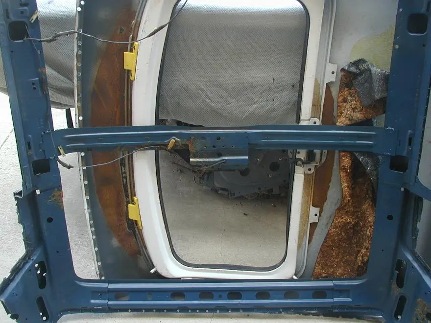

As for general rigidity, I'm not sure there is a significant difference from a hard top. On the solid roof cars, there's just one brace running across the roof where the hole would be, while on the sunroof cars, the metal is stamped and folded and welded, which does add some rigidity in itself.
Both are prone to flex, so proper classic bracing is key no matter what, but I wouldn't classify one as worse than the other.
Now, ttops or convertible? Different story
Here's the roof structure of a solid roof car. As you can see, just one flimsy brace is all that's different. The sunroof skin behind it probably has more metal in it (although it doesn't connect to the side structure of roof)
Needless to say, I'd venture to guess no measurable difference
