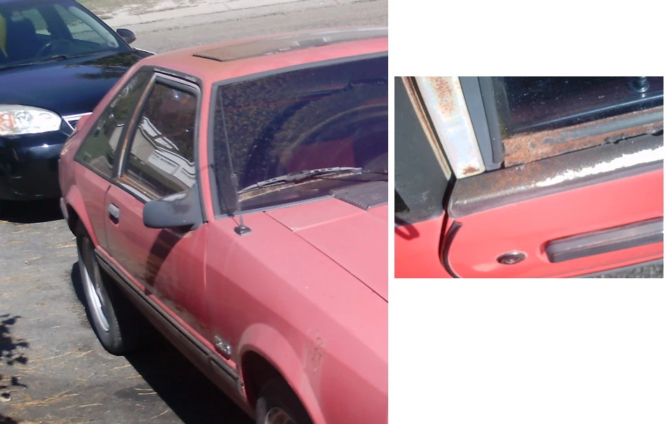

Oh yea, here's a look at what I got back when i went to pick it up for the above mentioned car show. All that brown is metal shavings. Whatever it was, when it hit my car it was so hot it embedded in the paint and in the glass.
He refuses to acknowledge it happened at his place. I didn't see it when I picked it up because the car was covered with dust. (and I do mean COVERD!) He says it happened over the weekend while I had it and claimed he doesn't have a tool that makes those kinds of sparks!

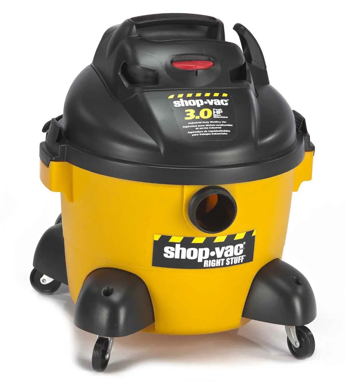

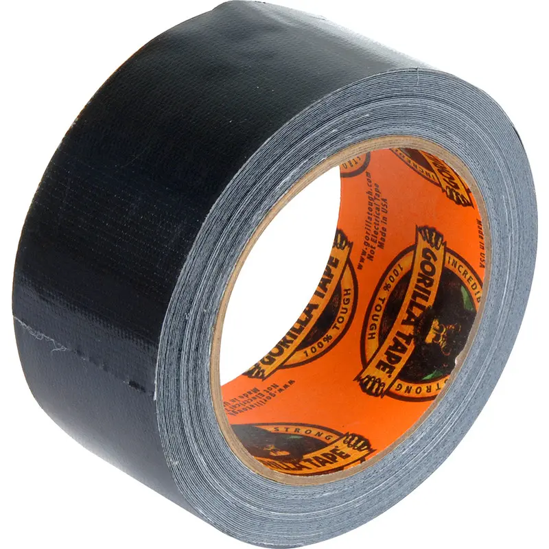

If you would like to clean out sunroof drains without poking wires down the tubes or risking the possibility of blowing the tubes out (old, brittle, etc.), there's an alternative:
Take one of these:
You can find them on most fuel cans.
Some of this:
And one of these:
I have never broken a drain tube when using a shopvac to clean them out. Don't tape off the nozzle completely. Leave an opening that allows you to vary the suction by covering the hole.
Ideally, a piece of clear tubing at the end is perfect. It allows you see what getting pulled up.
This works with household vacuum cleaners too.
