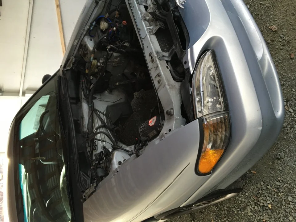

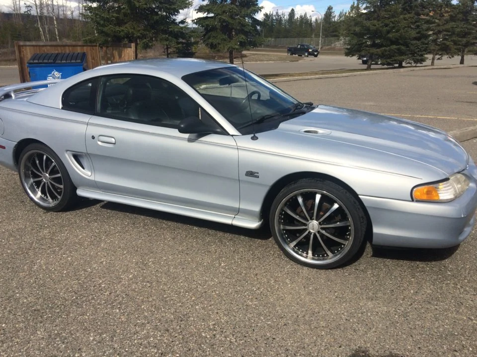

This thread really snowballed......I'm kinda wishing I considered the coyote route before, but it's too late now. I ended up with this list of parts
TFS 11r 190 heads
Tfs r series 90 mm intake
TFs track max cam 224/232 542/563
Tfs Chromo pushrods
FRPP roller lifters
Jp performance timing gears and chain
90mm lighting MAF
Comp HE alum rockers
47# FRPP injectors
ARP hardware all around
Decided to get my block disassembled and dipped at a local machine shop. It didn't meet their tolerances to be re assembled so Now it's getting bored .030 over. New bearings all around. I'll hopefully be assembling in late jan.
Here's a pic of my car looking all empty and sad
And another looking sexy last summer
