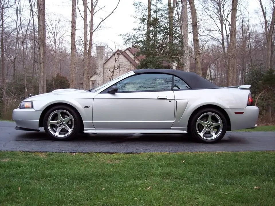

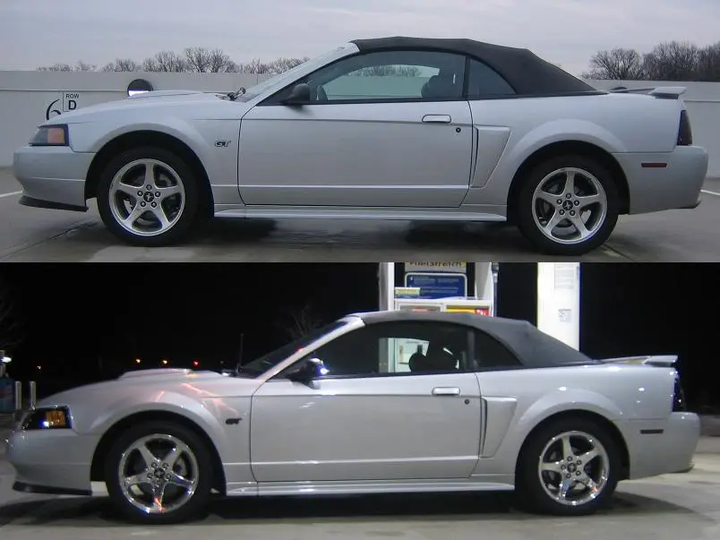

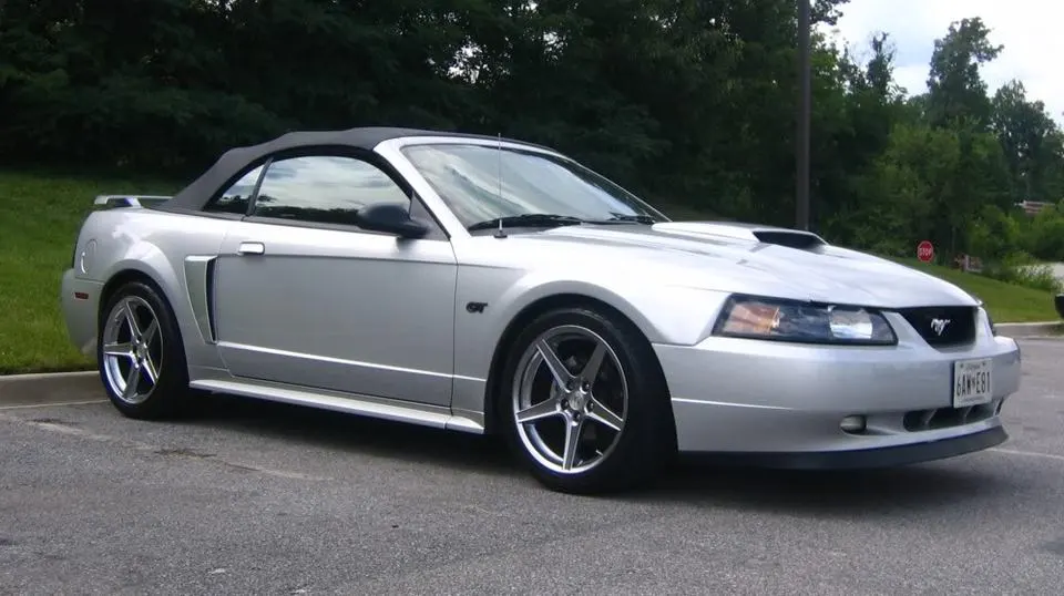

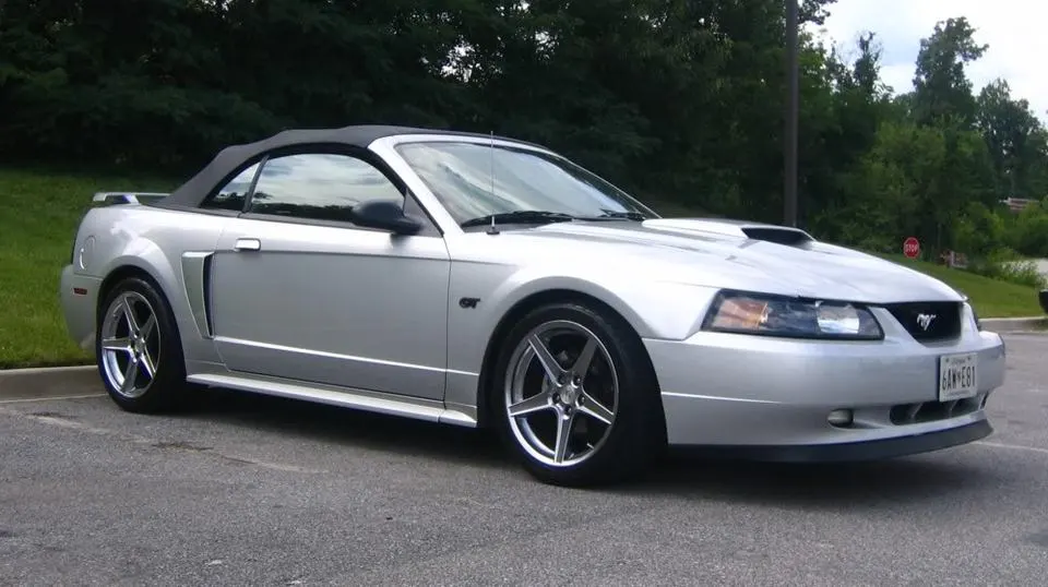

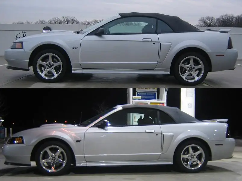

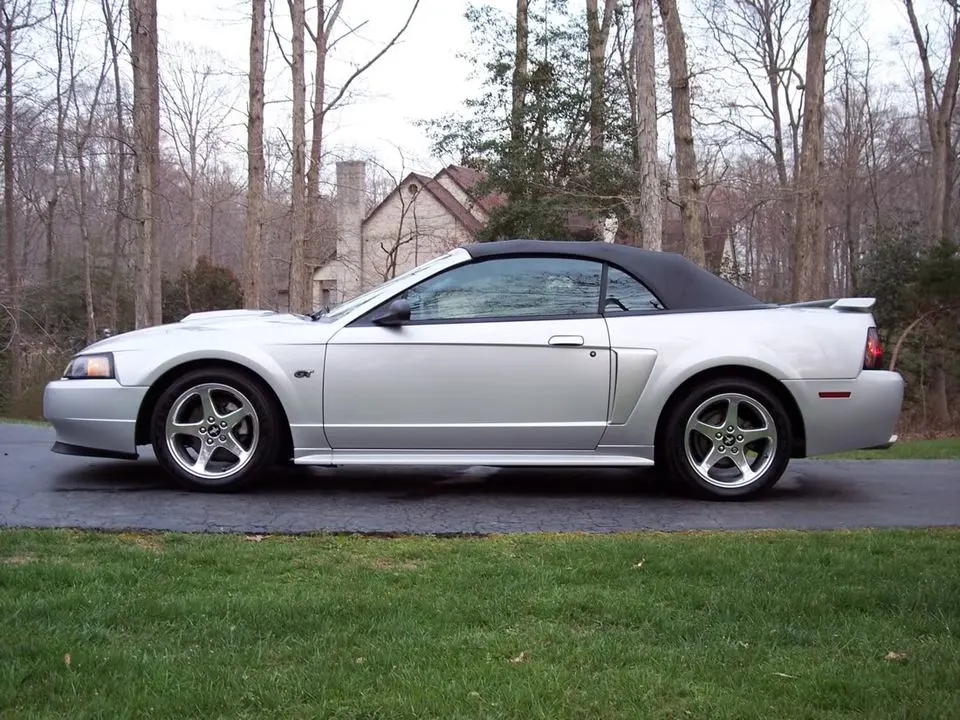

Here is the drop the night after I put the kit on. I took out one isolator from each corner, and they settled a bit after this.
Wasn't low enough for me so I cut half a coil off the front springs and it looks great.
with 18s
