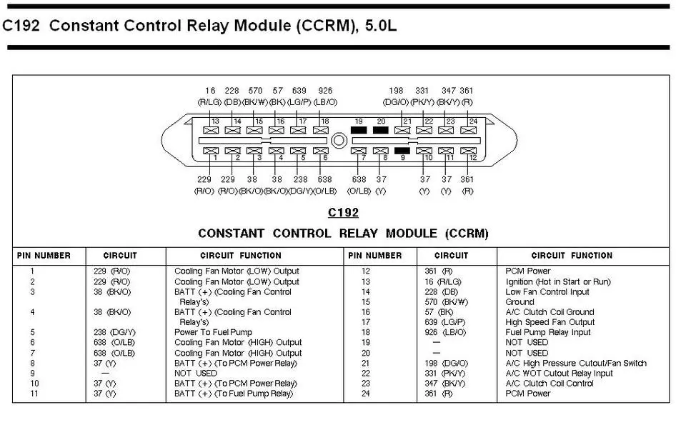

How do I check if my high speed fan is coming on?
Open your hood with the car hot, and ground pin 17 on the CCRM. If the fan speeds up, then the low speed was on.
