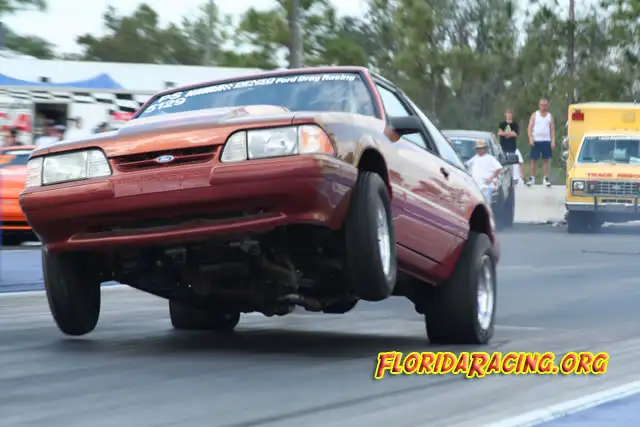

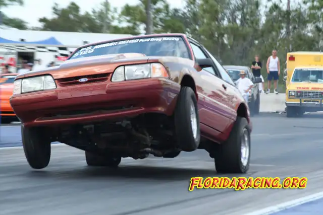

I want this

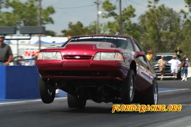

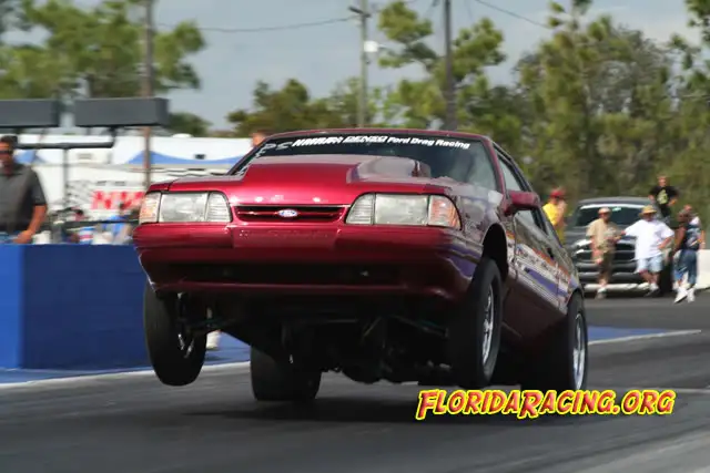

Not this

So You want your stock 90Lx to launch like picture #1? I think you are going to need 425RWHP aswell as the above suspension mods to do that.
I was using those pics as an example. I want to get the suspension set up so the car doesnt twist when leaving the line.
