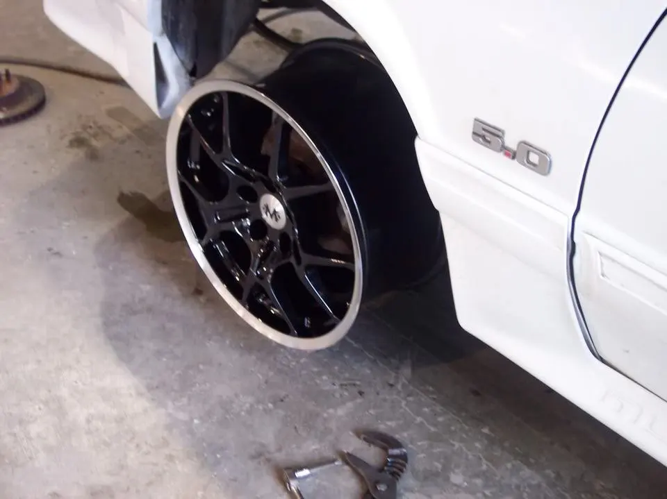

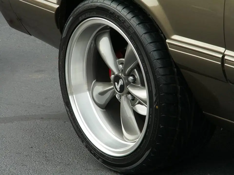

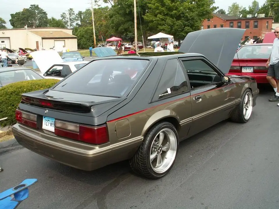

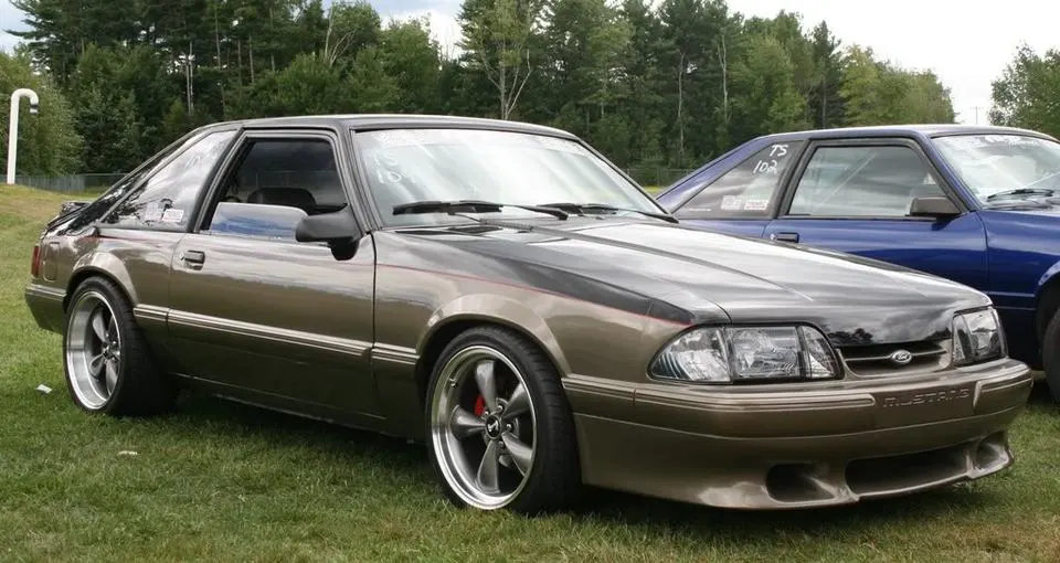

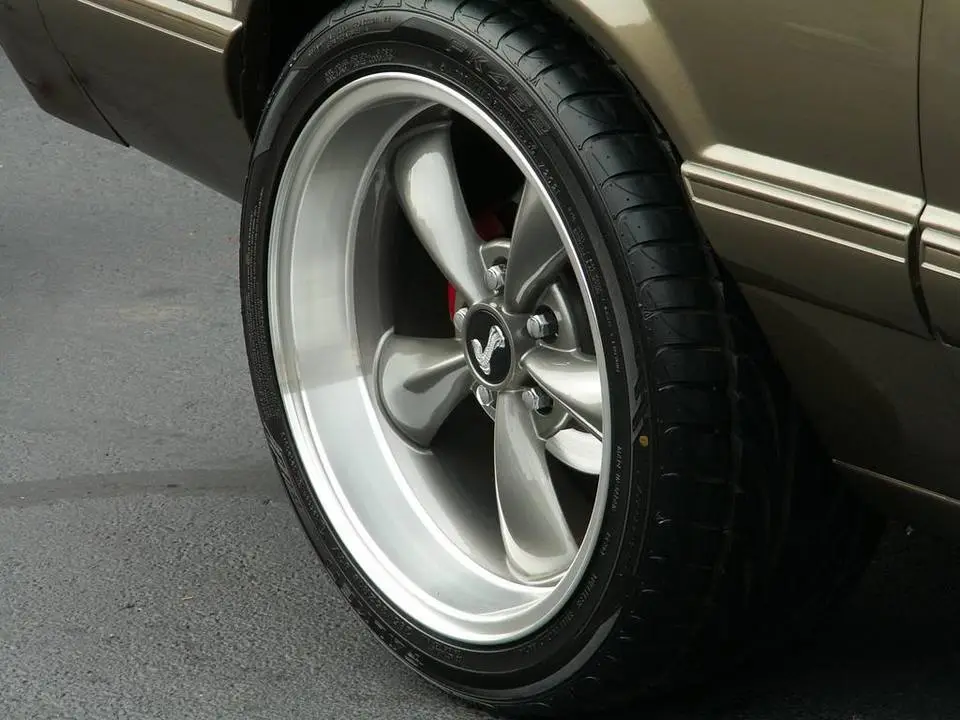

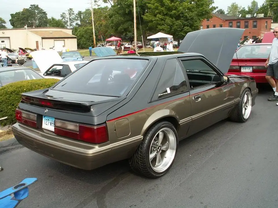

I have 18x9's on my car. 255 up front and 265 out back. Should have gone with 275, but oh well, next time.
I have no problems with rubbing except on full turn. The amount of times I do that is very few so I deal with it. I did not roll my fenders or flip my quad shocks. I have BBK springs in my car, which drops it about 1.75".
No problems with fit.
Here is a picture.

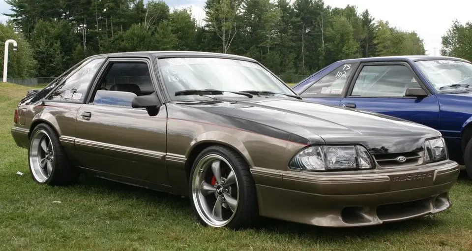

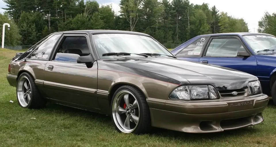

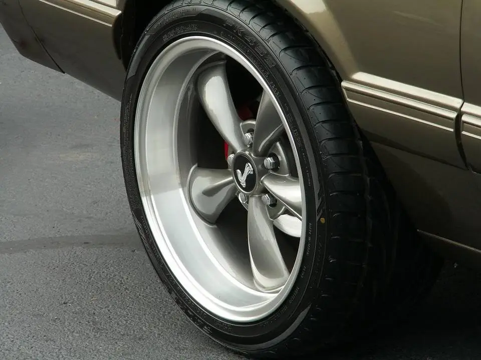

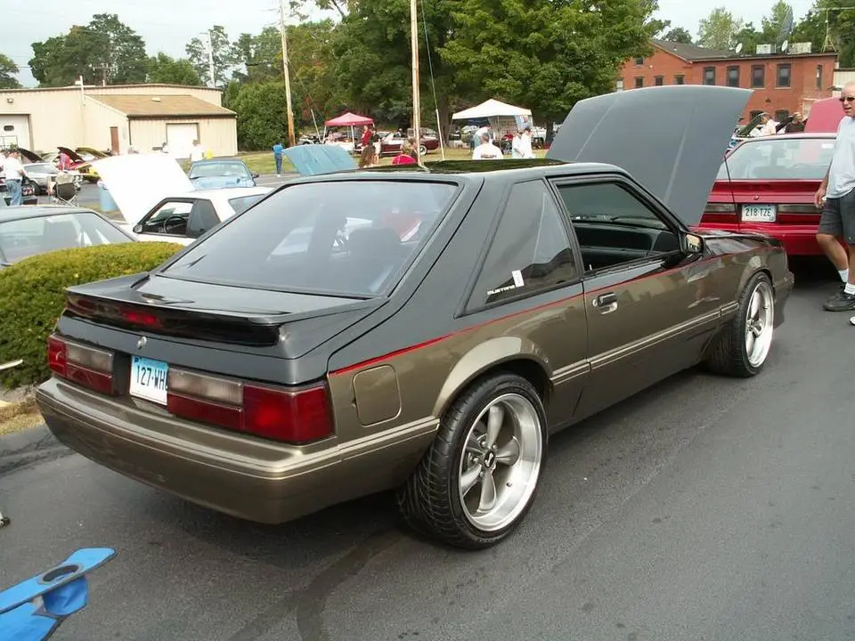

I run Saleen springs with 18x9 and 18x10 Bullitts. 255/35s out front, 285/35s out back. Rolled fenders, no quads, no rubbing other than one time on a hard hard turn, and another time when I had to ramp up over a steep hill, and I stuffed the wheel.
Out fron they rub on full lock like ANY wide wheel will with our lower A arms, and mine rub on the fenders on bumps. It is worth the look though!

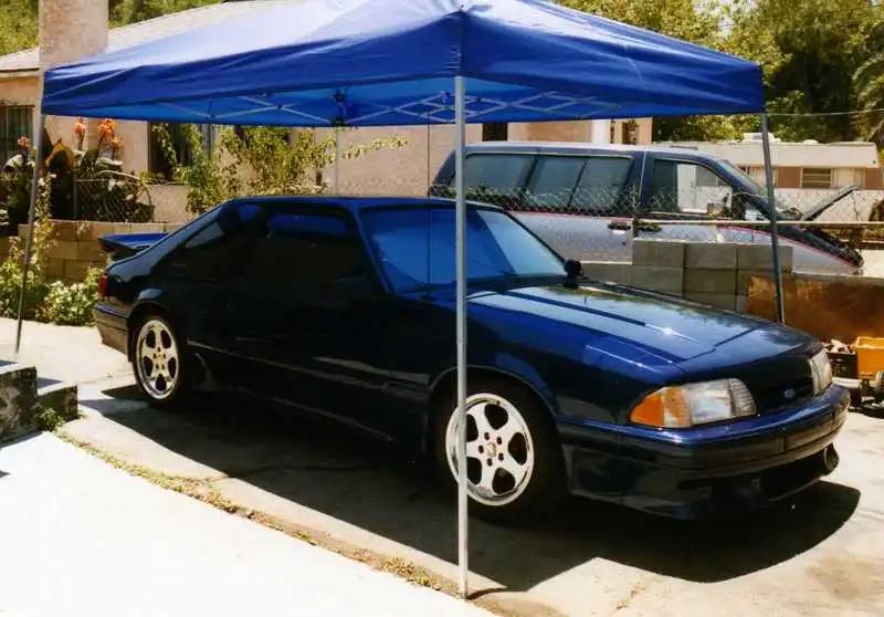

87ttopstang, love the car. Has it ever been featured in any Mustang magazines? I'm just now seeing you car for the first time, and it looks great. Reminds me of my '90. Not that it even comes close to what you have done with your stang.

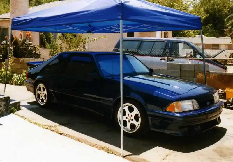

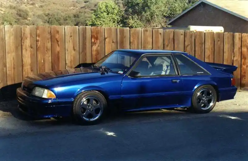

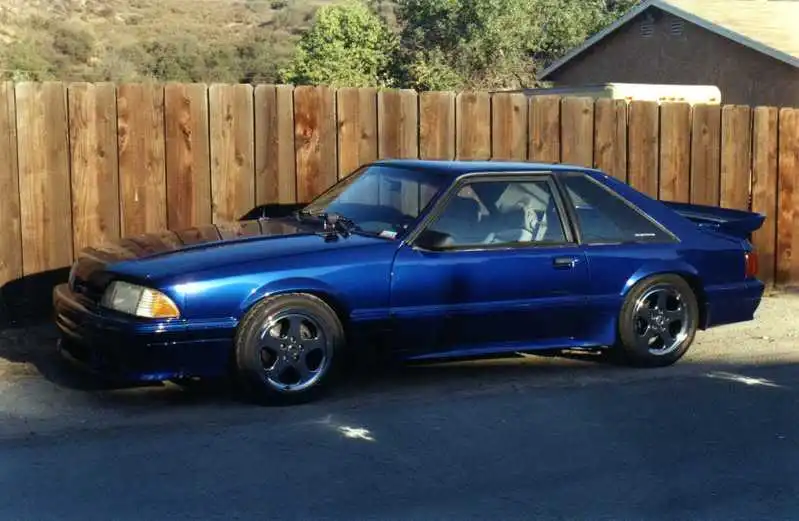

Here's my '90...

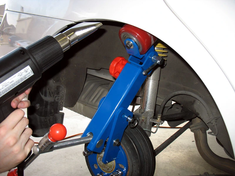

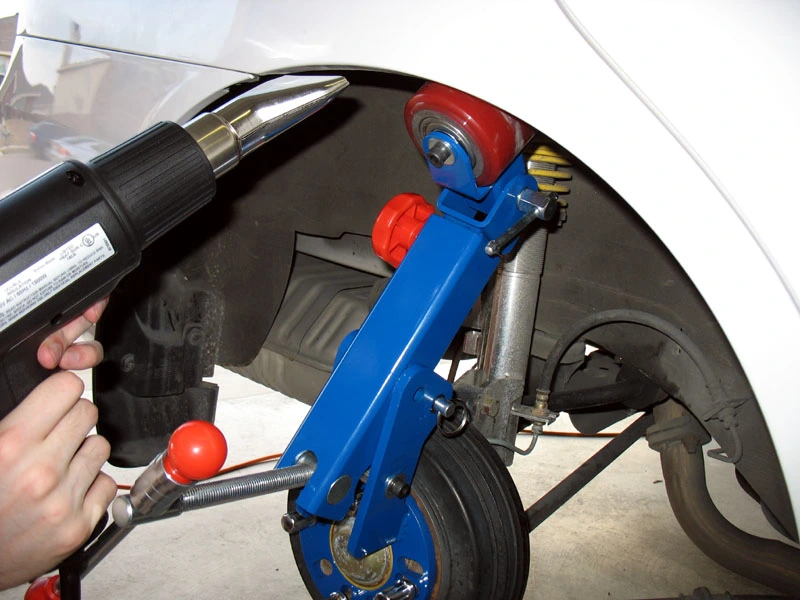

whats it cost to get your fenders rolled or rent one of those? is it something anybody could do or best for the pros? it doesnt affect the paint? i could see it causing flaking or cracking pretty easily....

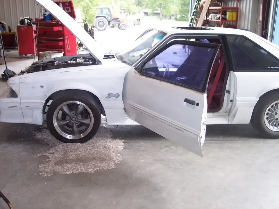

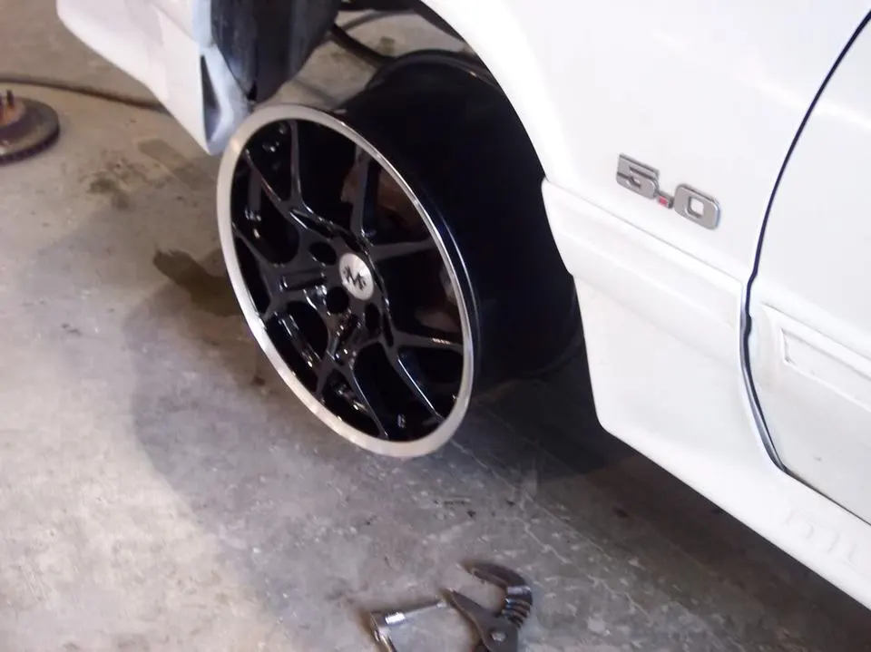

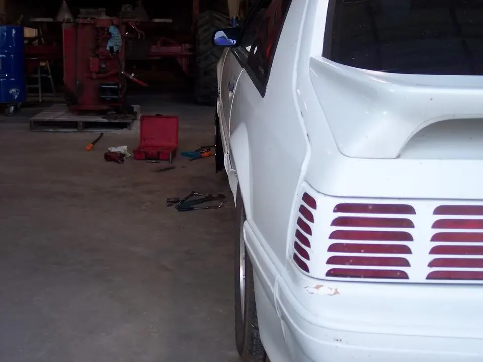

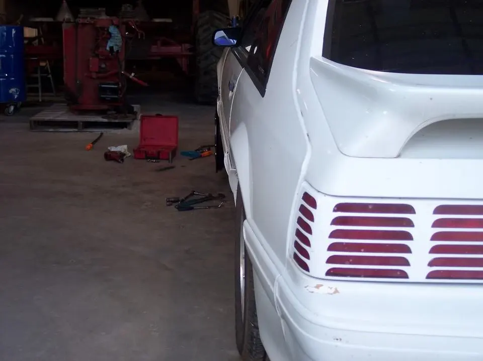

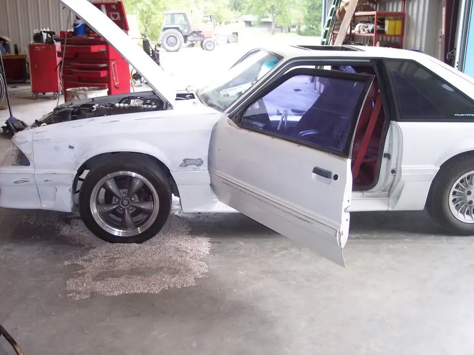

Oh here are some pics of the 18's im gonig to be running on my car, they fit perfectly too, could't be happier
The last pic is what the car is sitting on for now with those 17 inch bullitts they dont look to bad if you ask me :shrug:
