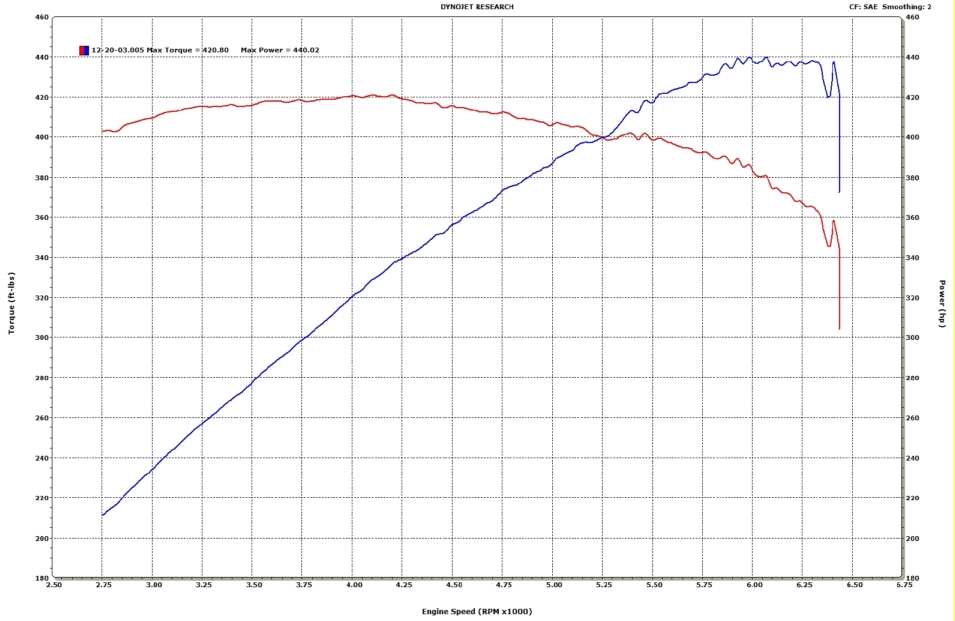

Why do I love my stock 8psi Eaton, let me count the ways....
How about 400+ RWTQ @ 2750RPM's! :D
