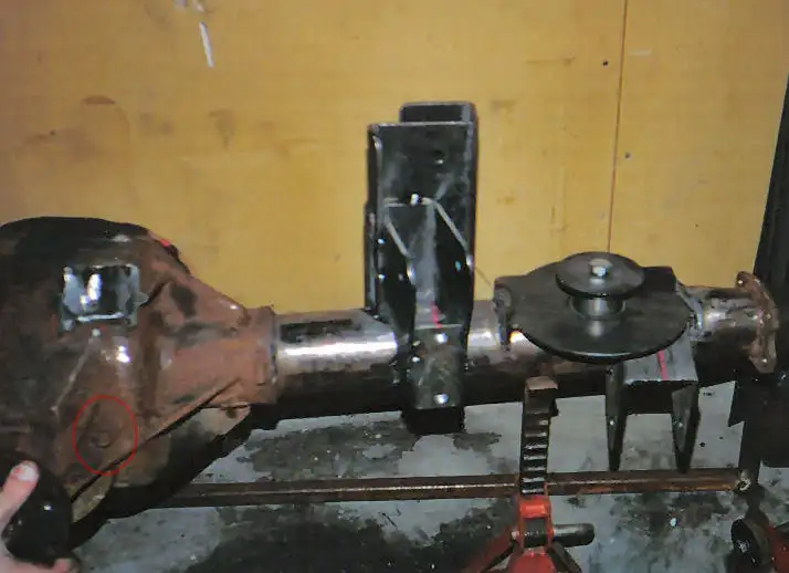

I know I've located at the fill plug (I've seen numerous pictures) but I can't figure out how to remove the thing! It appears round, no socket fits over it either. What am I supposed to do, pry it off?

The fill plug has a 3/8" square opening in the center. You might have to clean it out. Basically you put an extention on a 3/8" ratchet and use that to unscrew the plug. They are usually in there pretty tight too.
I'm not sure if you can see it in this pic, but RYC CUKR's right, you just use a 3/8 extension on an ratchet. It may well be filled with a bunch of road crap, you might have to get in there with a flathead screwdriver and clean it out.

One more thing.
I have found that it is much easier to get to the plug if you have the back of the car jacked up and let the rear axle hang. That way the axle and the plug aren't as close to the underside of the body.
