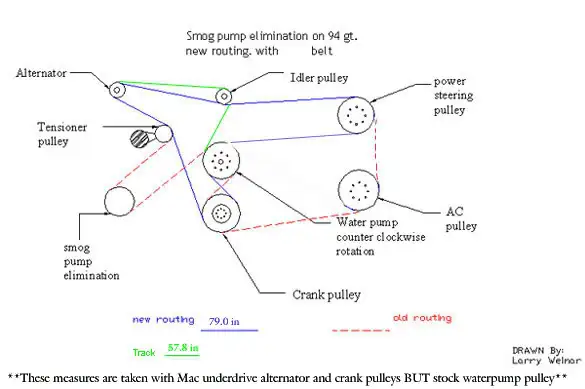

how do I route the belt when bypassing smog pump.Yes I have searched but didnt find a diagram on how its route just the belt size I need.My problem is if I just bypass the pump the ribbed side of the belt will have to go under the tensioner or do I bypass it??
Chizel said:
Any idea what the length would be bypassing it and running underdrives?
