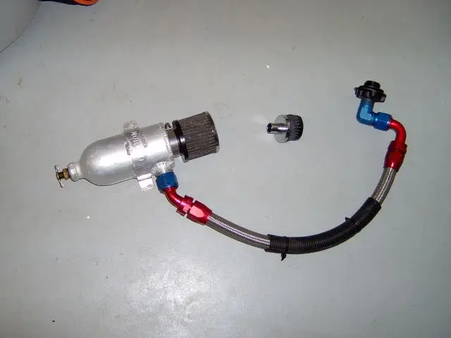

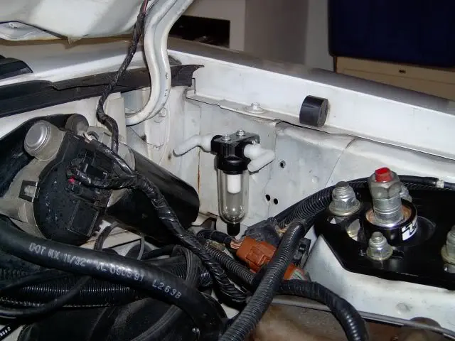

I run a PCV valve with an air/oil seperator on my car. Then I run a breather / catch can that connects to the pass. side valve cover where the oil cap used to be. Or you can just use one of the breathers that screws in place of the oil cap, but they tend to get oil-soaked after a while.You are correct that the PCV is completely useless when under boost. You need to be sure that the valve you run is one-way, otherwise you will pressurize your crankcase with boost. Just trying blowing in the small end, you shouldn't be able to. I don't recommend using an oil cap. Under boost all that excess crankcase pressure has no where to go except out of small hose that runs from the valve cover to your powerpipe or air cleaner. Too much crankcase pressure will lead to blown seals and oil leaks. Before I switched to a breather my car would pop the dipstick out of the tube and spray oil everywhere, not good. Some folks don't run a PCV at all, and just run breathers. I used to run a small one that fit right into the PCV valve grommet. I prefer to run a PCV though because it heps suck fuel vapors from the crankcase, breathers won't do that for you. Here's some pics, hope this helps
Old set-up, I run a PCV in place of the small breather now. I did put the catch can back on though
