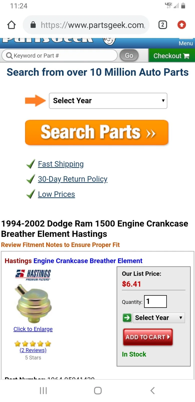

Get a 94 dodge ram breather and put it in the oil fill hole in the valve cover. You'll need to use a combination of heater hoses to reduce the size down to the nipple on the TB. When you need to add oil just pull the breather out.

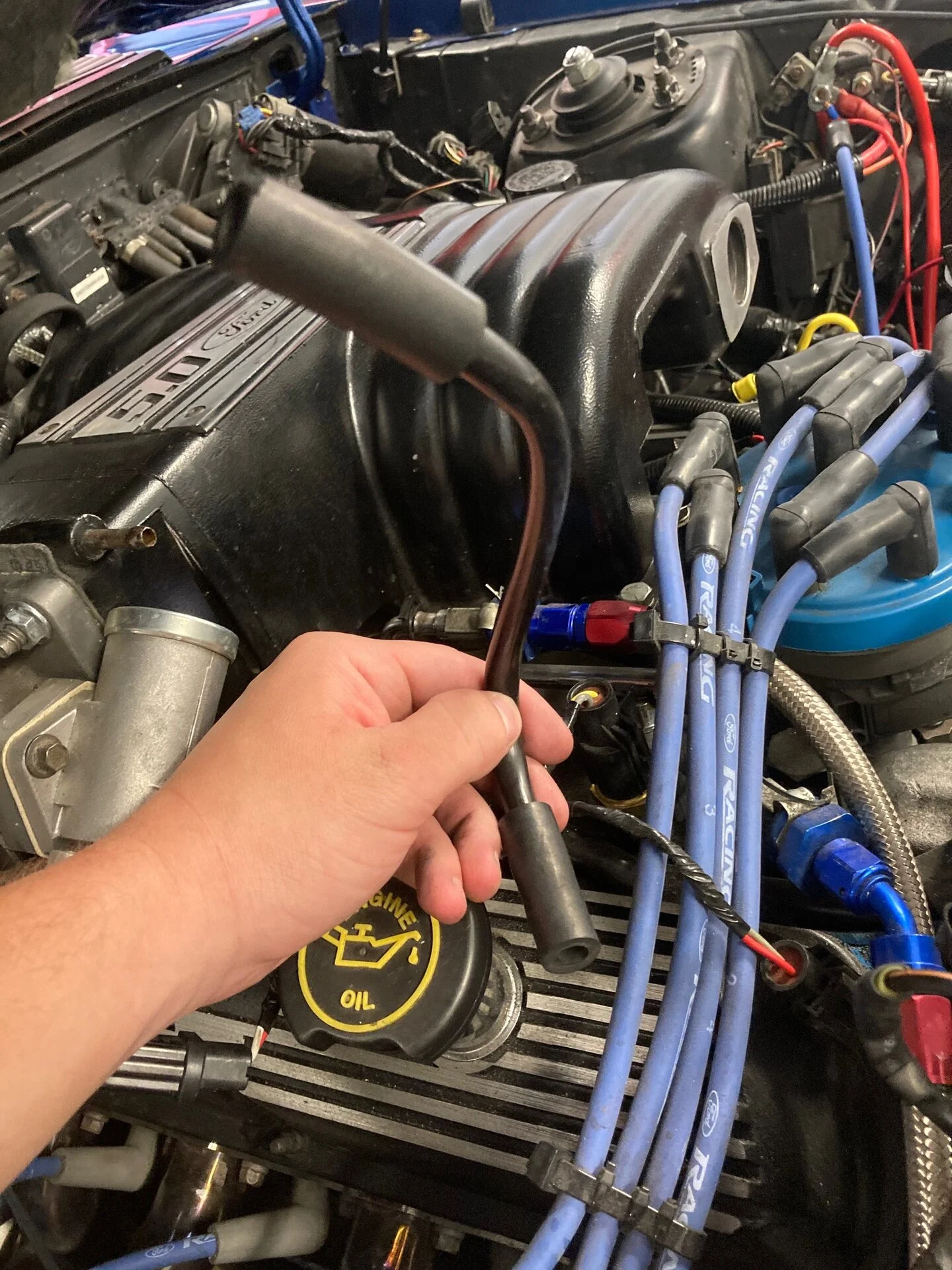

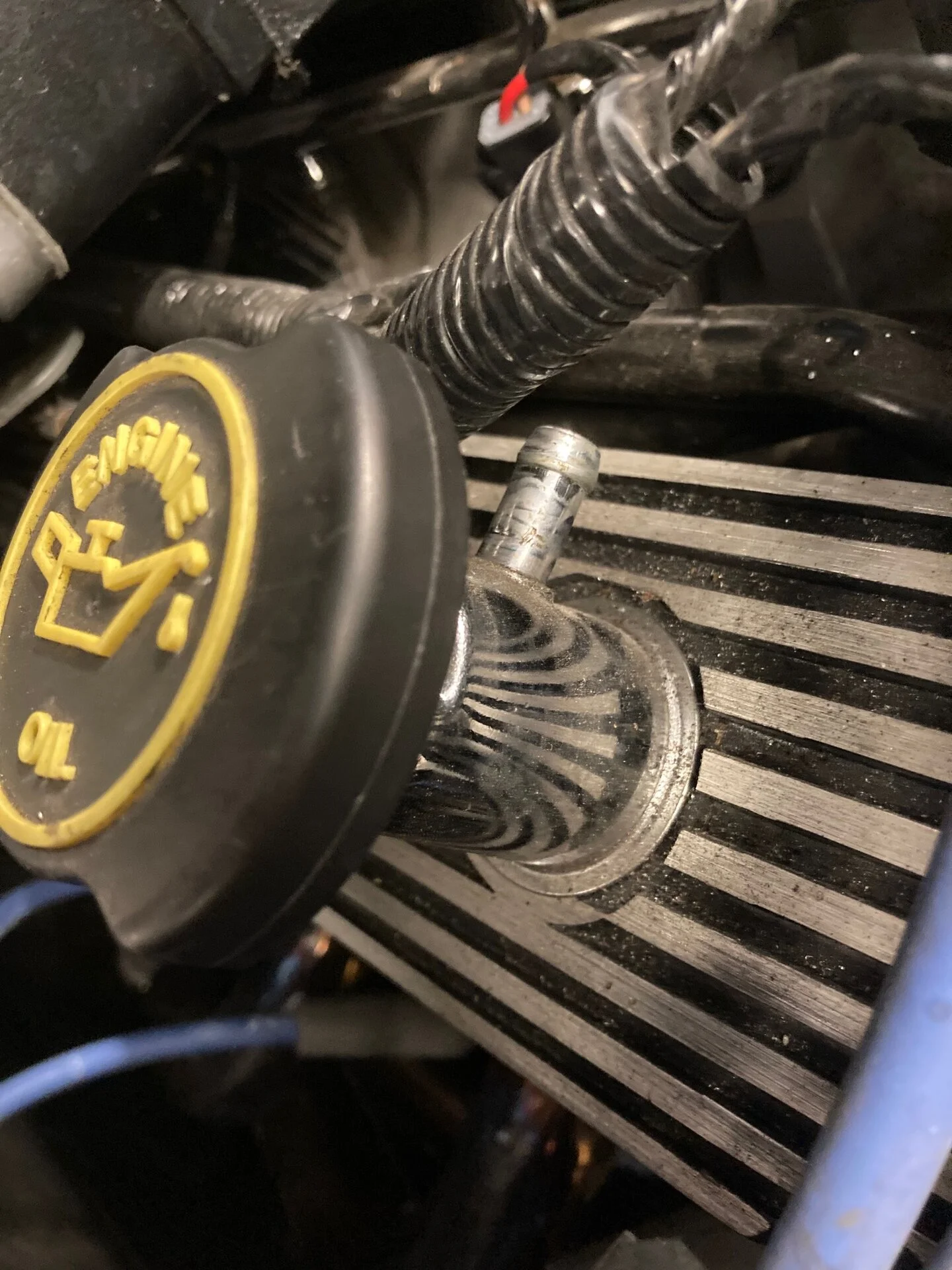

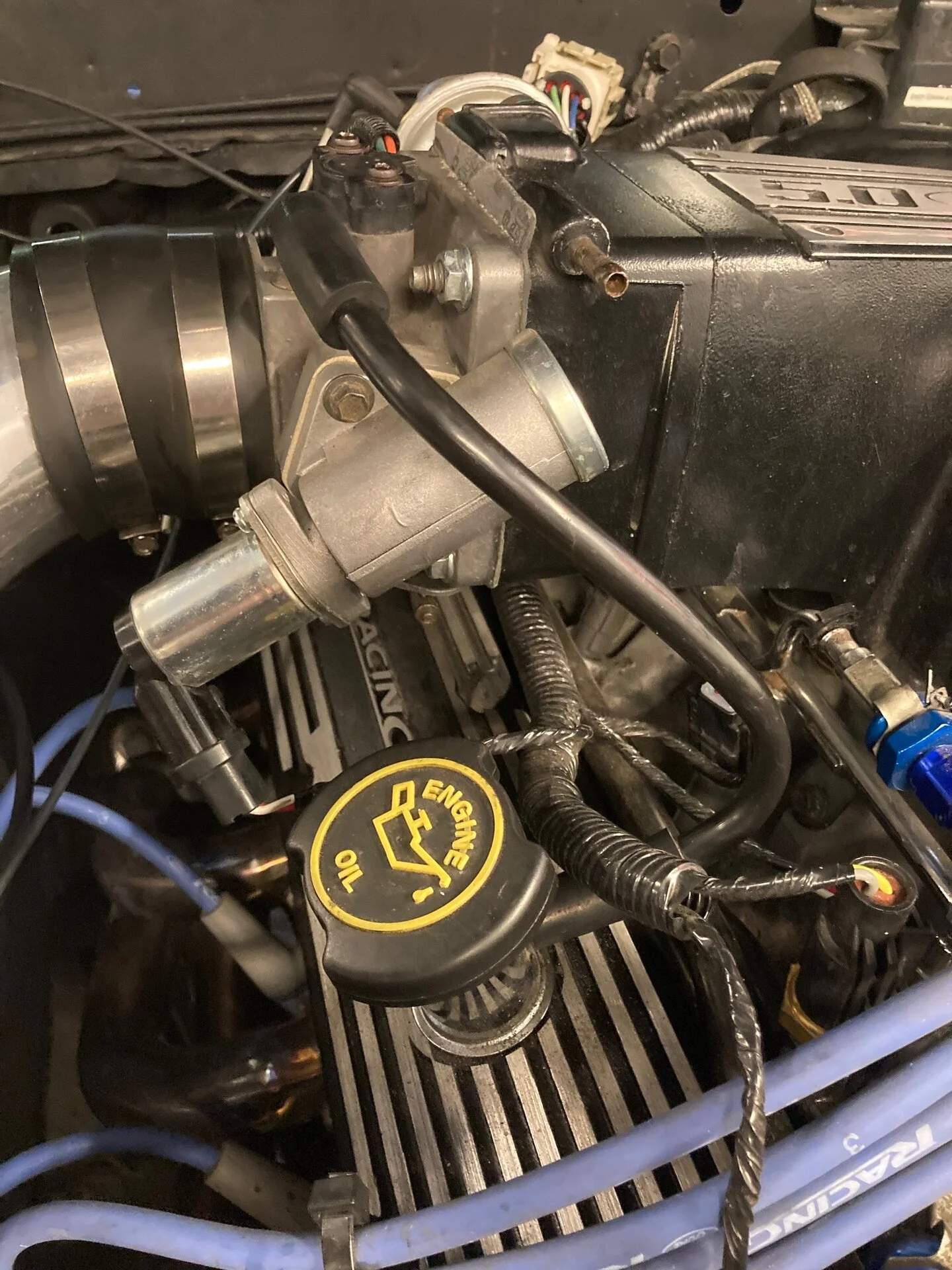

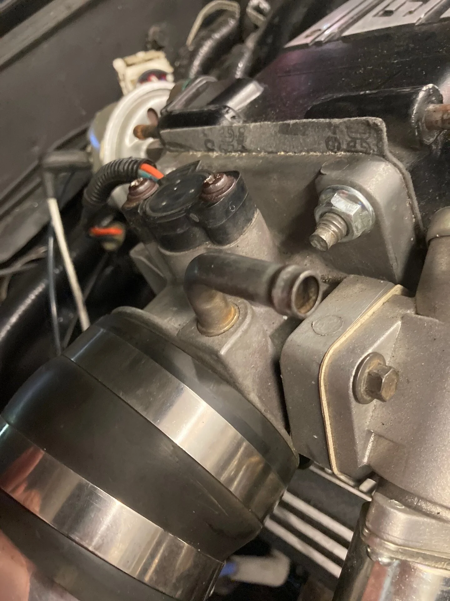

Hey you guys, I'm back with my mustang. As I was looking at it yesterday I saw that I already had the setup suggested above. My aftermarket valve covers came with basically exactly was described I should install. Yet I still got the same problem. I made sure the hose wasn't clogged. I made sure both nipples are not clogged either. When I take off the TB side (Just the VC side is plugged in) and run the car, I got a lot of suction at the end of that hose is that correct? Or should I have positive pressure blowing out air? My air filter isn't clogged or anything.
I checked the other part of the PCV system and it's there and it's new and goes into my upper manifold. Like I said, I'm just still running it with my dipstick pulled out, which also when I put my finger up to it, it has a lot of suction. What do you guys think?

You should have vacuum at the dipstick, not pressure. Sounds like your PCV system is all intact. Is it pulling vacuum past the dipstick O ring when it's pushed all the way in causing it to whistle maybe? Try sealing around the dipstick with tape temporally and see if it goes away.
Yeah I do have suction (vacuum) at my dipstick when I take it off, but that is how I'm currently relieving my crankcase pressure. If I push it in then that squeaking comes back and idles around 1100 to 1200. (No air is rushing in or leaking around my dipstick if I do push it all the way in.) So my PCV system "works" as far as I can tell but obv something is wrong with the system. Any ideas? Thanks.
Does it smoke out the tail pipes?
the crank case should not have vacuum enough to make a whistle or any noise for that matter.
I'm going out on a limb here and say you have a massive vacuum leak that is likely coming from a bad intake gasket.
Reactions: Sparky714
The smoke machine is always a good idea. I had a strange whining noise once. It turned out to be the vacuum line from the pcv valve to the upper intake collapsing. Just a thought.
You're going to need to replace whichever gasket(s) the built up crankcase pressure blew out.
So I changed my oil the other day when I got back from Florida, I didn't have any water or metal chips in it. My coolant in my radiator doesn't have any oil either as far as I can tell. Once I get my smoke machine I can check my exhaust for leaks all the way up to the headers. I don't see any leaks on my rear main seal and I don't see any around my CC and water pump either. My point being, if all those things are good, (assuming exhaust is good too) where do I go from there to check gaskets/seals? I guess I can do a compression check and see if it blew my cylinder rings?
