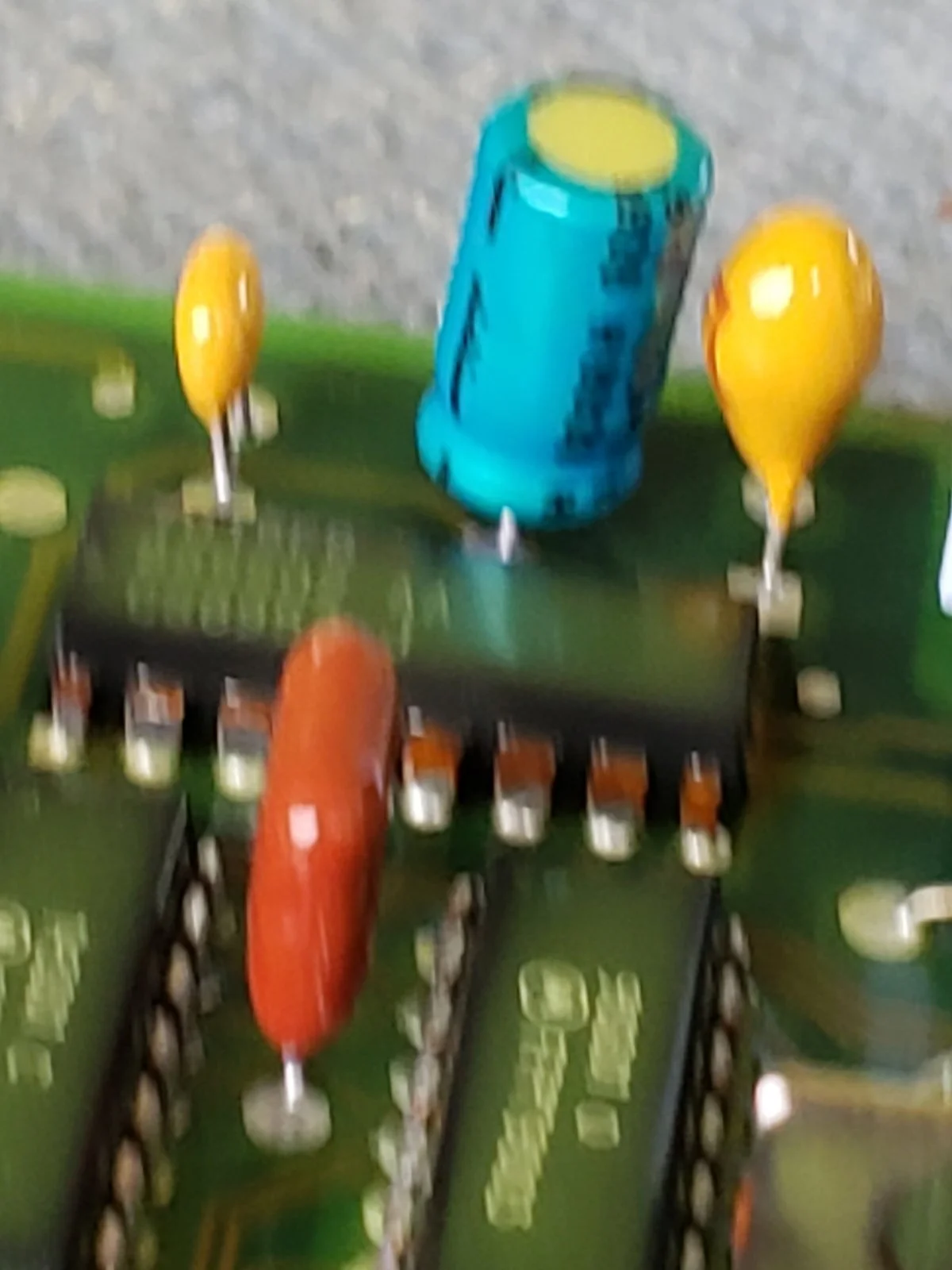

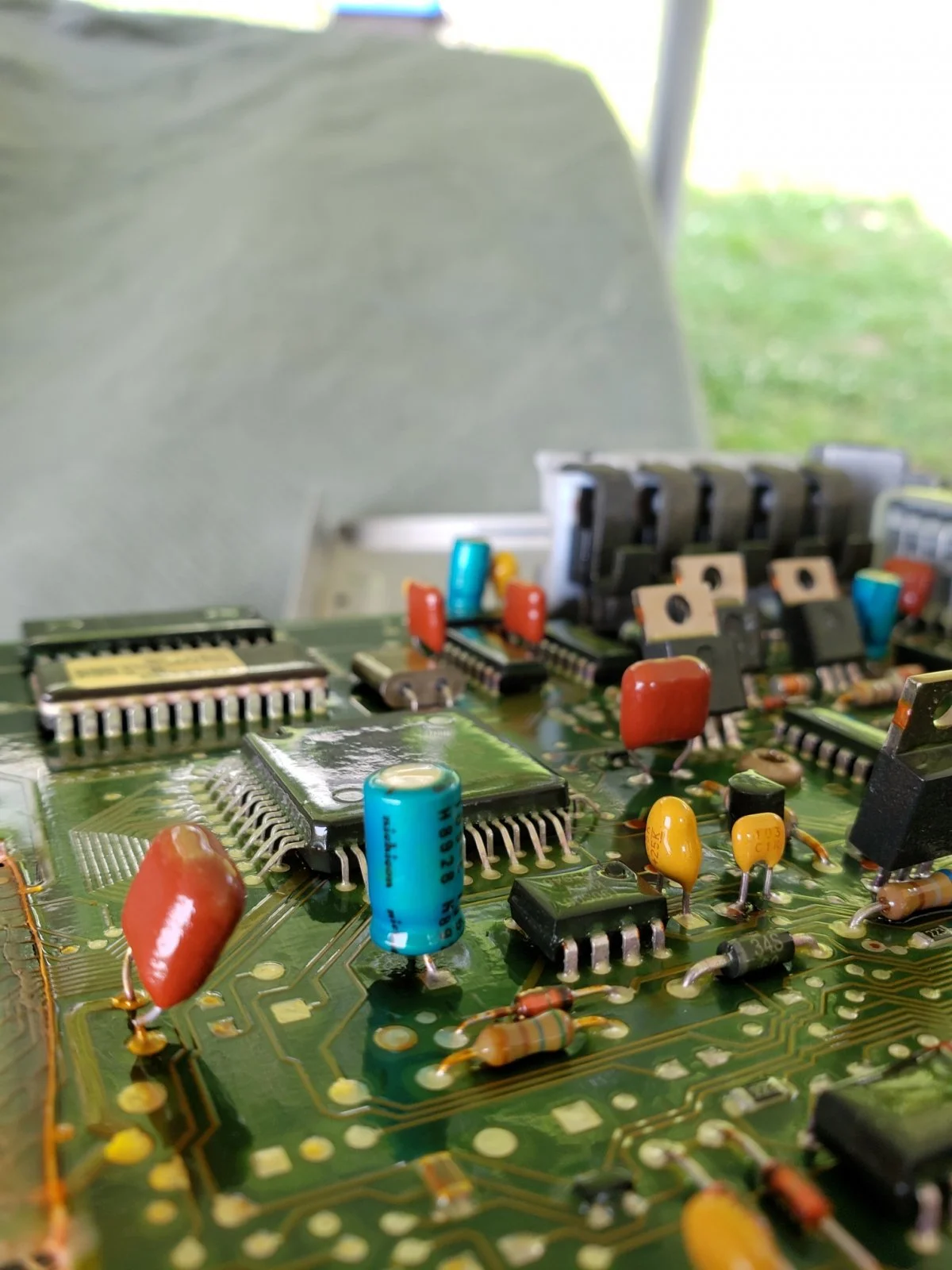

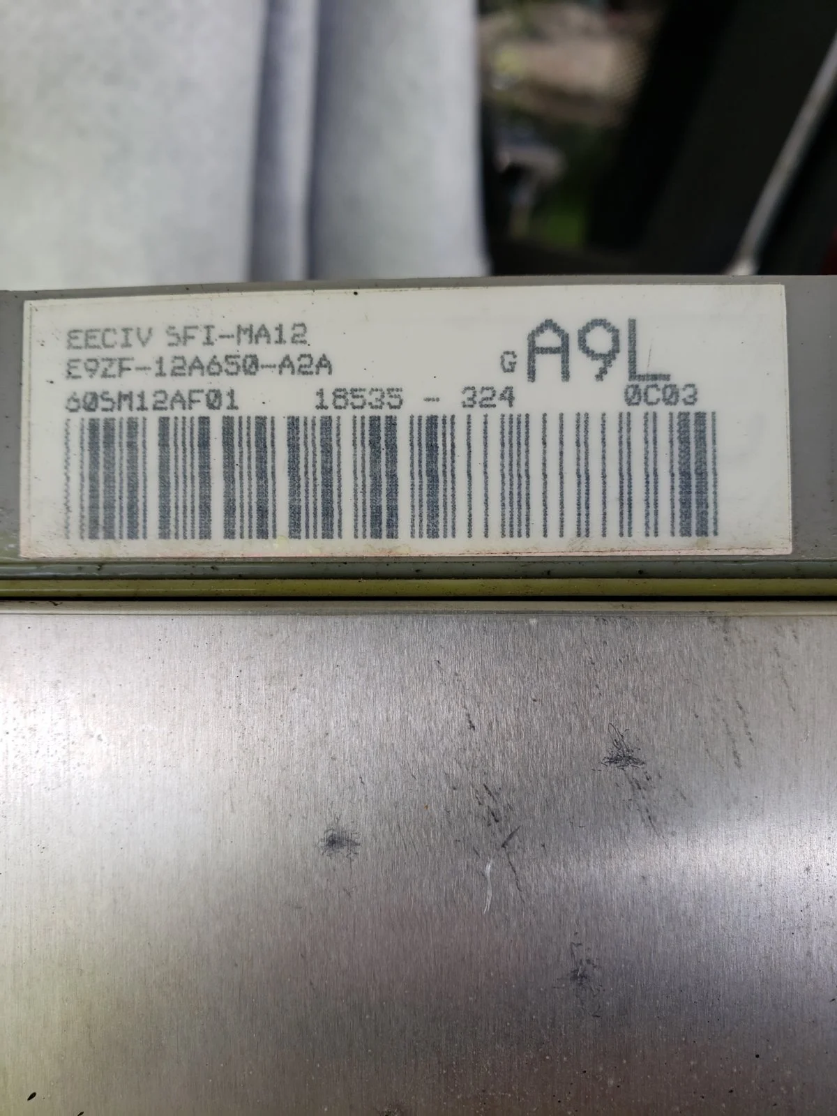

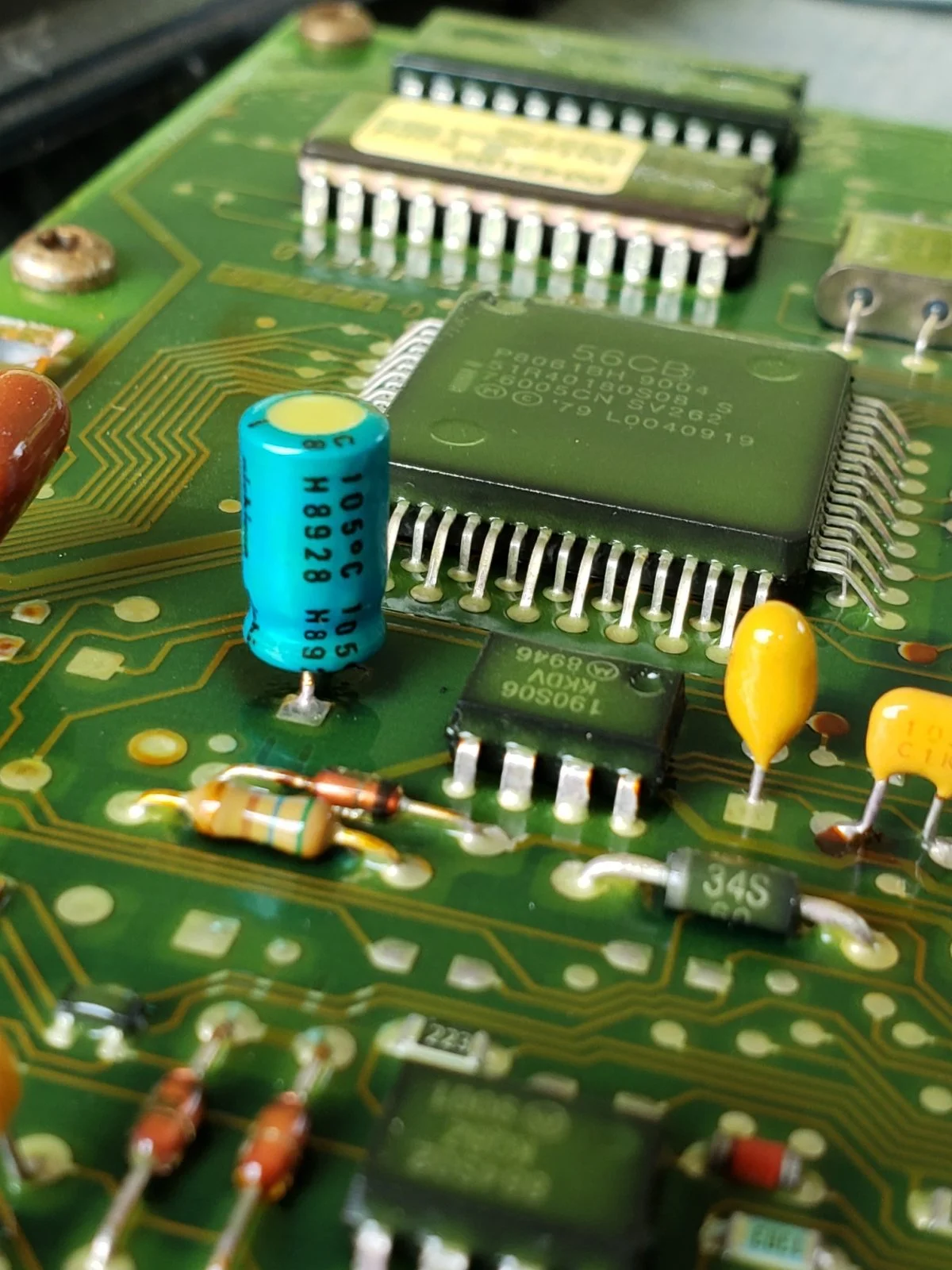

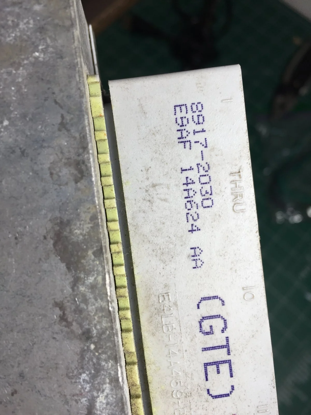

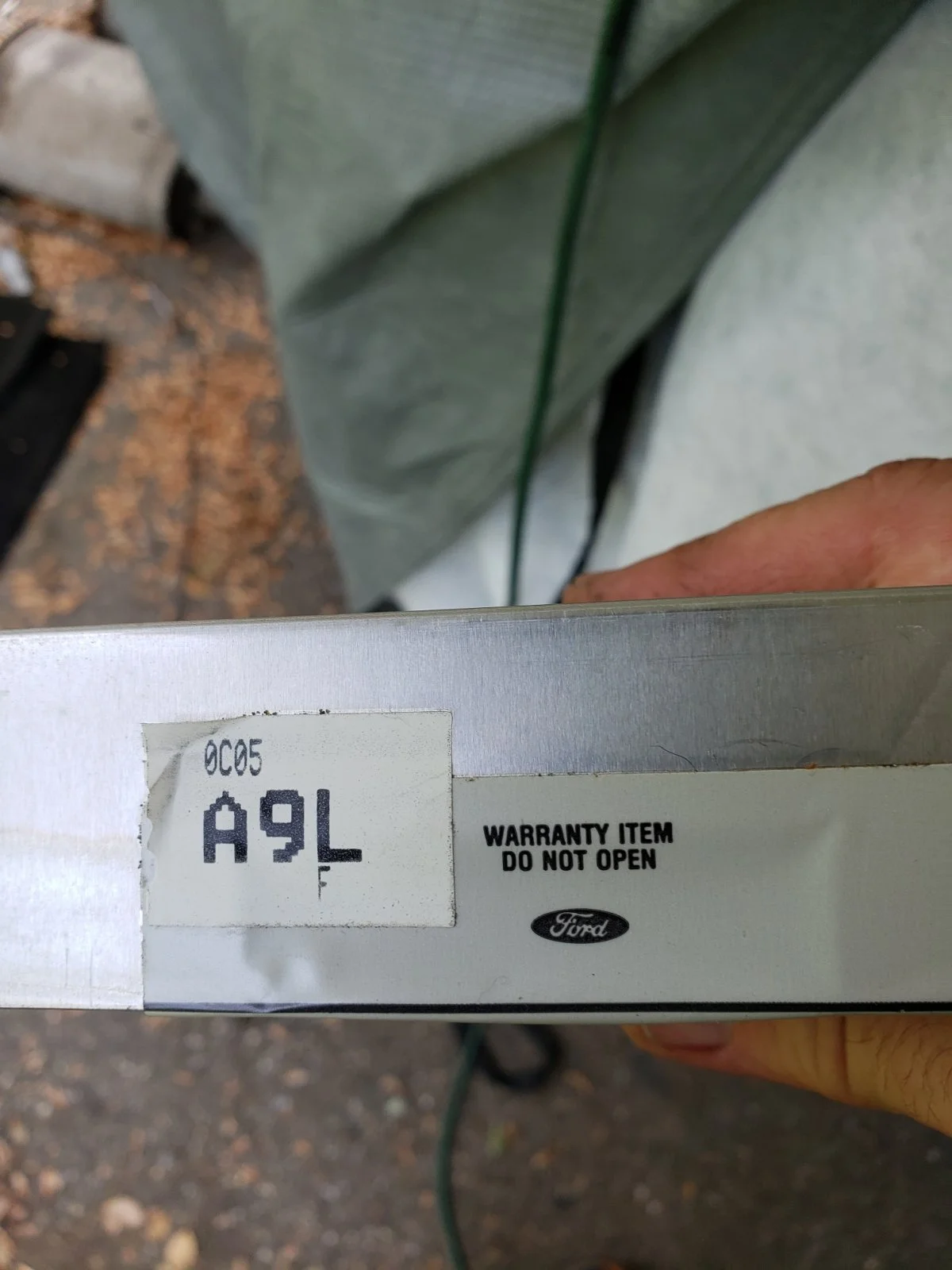

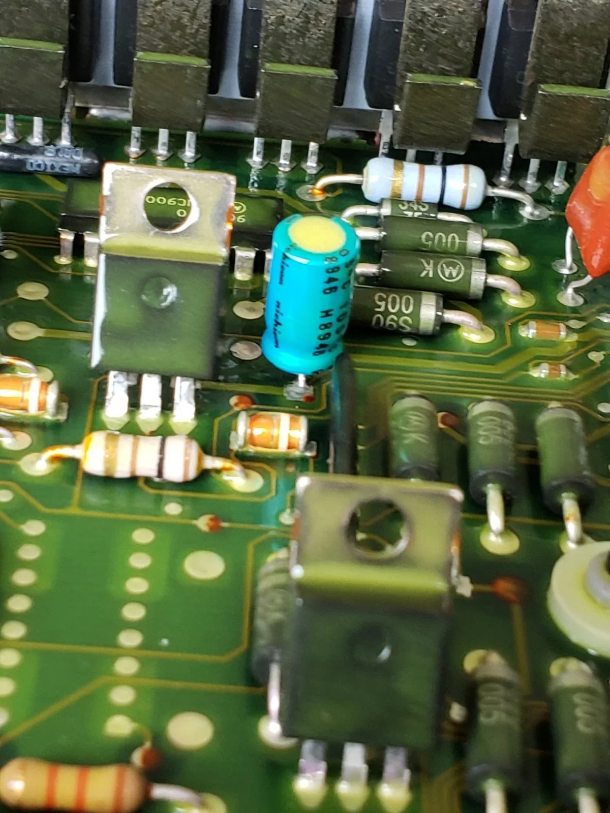

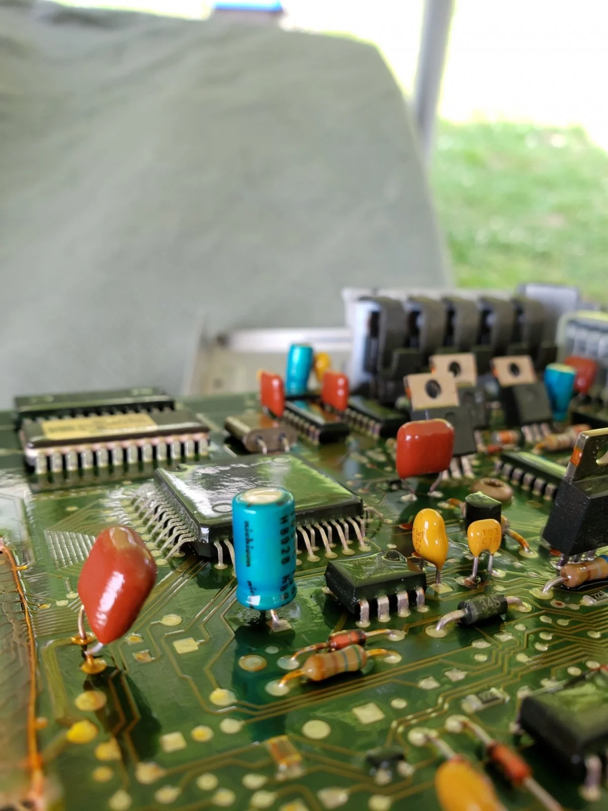

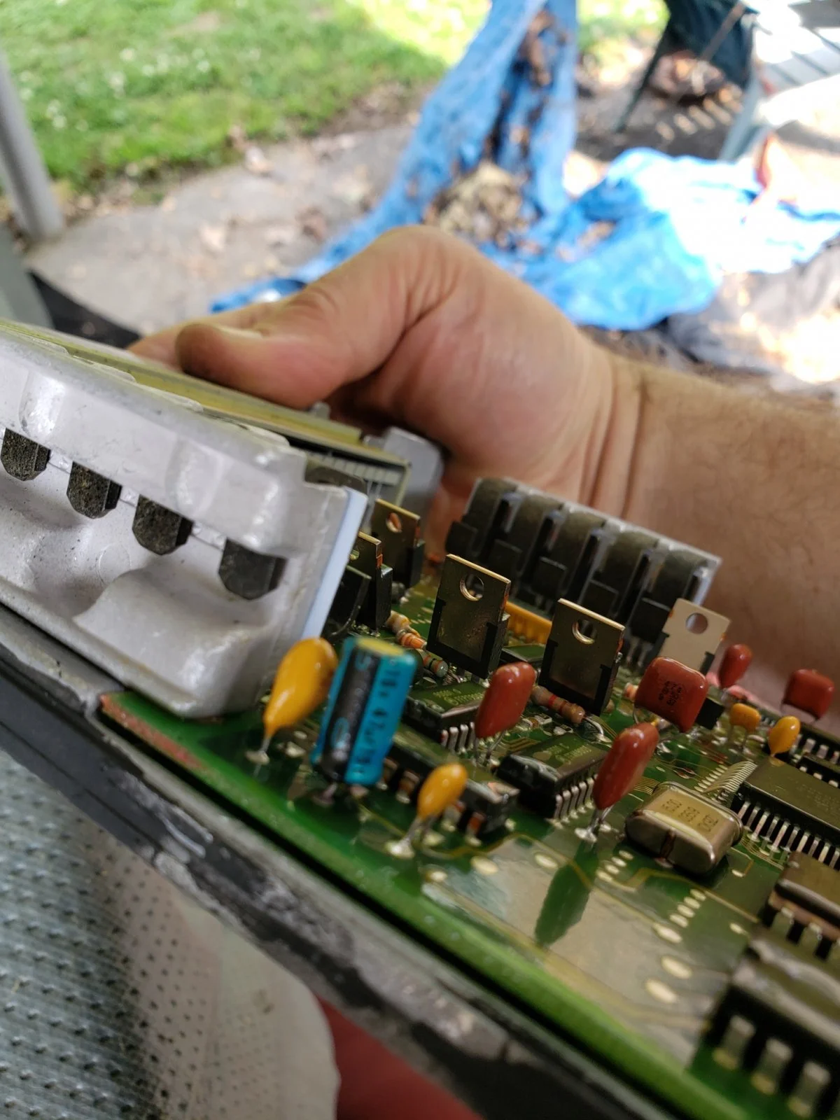

So, I pulled the dash... since I need to dye the read part black, and the HAVC box so I can replace the heater core and A/C evaporator... so I decided to pull the computer out also... The car ran find when I got it, drove it home and started taken it about, going on 6 years now :(. I will be getting a QH tuner for it when i get ready to fire it up this summer (i hope) so I decided to pull the cover off and take a look inside to see if my caps look bad since that seems to be the normal.... I'm no expert, but they seem to look fine to me, also look like the whole board is coated in a protective film, I guess like whats on the expansion port that I read I need to clean off to install the QH.
Also, this ECM seems to be the original one to me, no re-manufacture marks/labels on it.. and the seal was never cut... So how does this look?

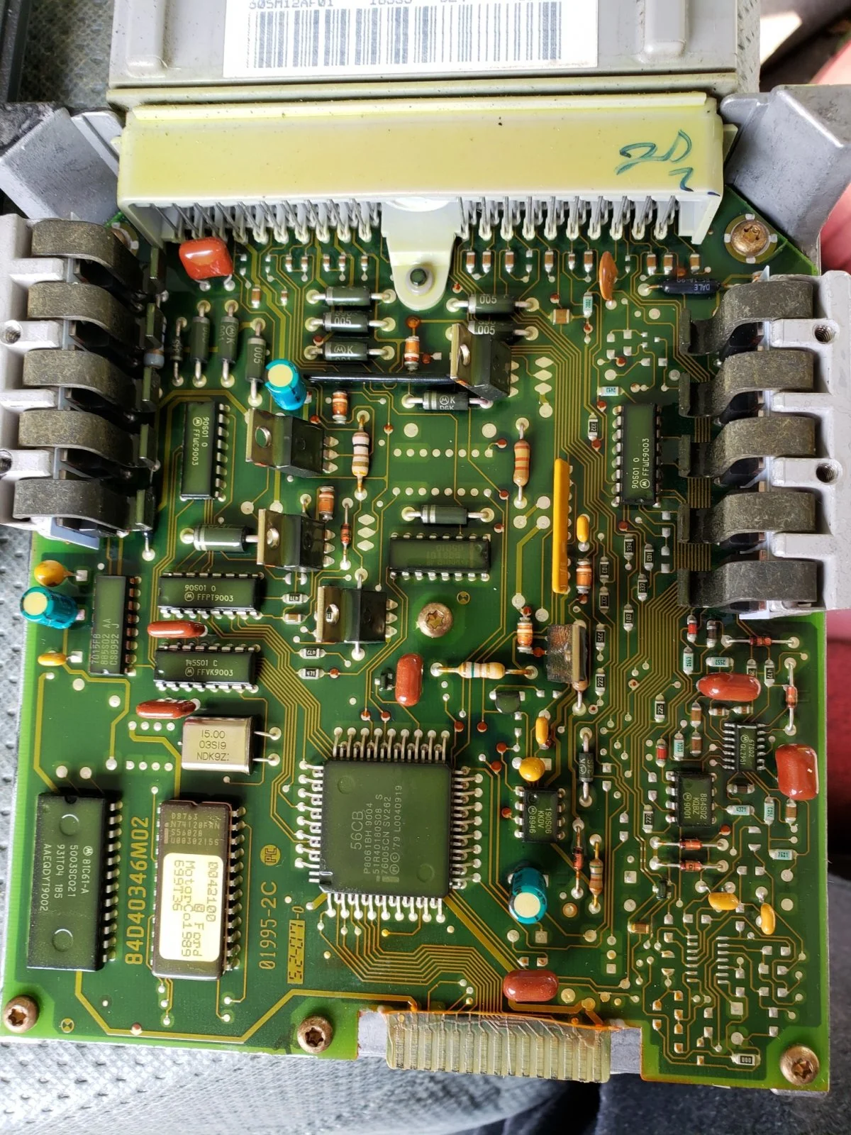

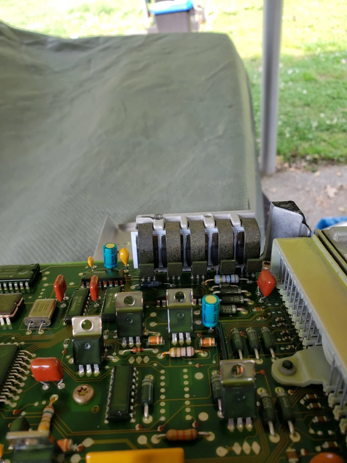

Also, this ECM seem to be the original one to me, no re-manufacture marks/labels on it.. and the seal was never cut... So how does this look?

Caps look find. Usually the bad ones will leak and the base where the leg solder in will turn a nasty greenish color. Those look pretty clean.
That ECU looks great...one of the better ones I've seen.
cool thanks , that makes me feel better... I was kinda hopping when I pulled it I would find it was replaced with a reman at some point.. so as not to be 29-30 years old... but appears to be factory to me... but yes looks very clean...

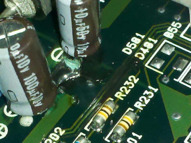

looks like that cap is leaking...back leg looks black..since u have the computer out might as well replace them..cause they are going to fail
