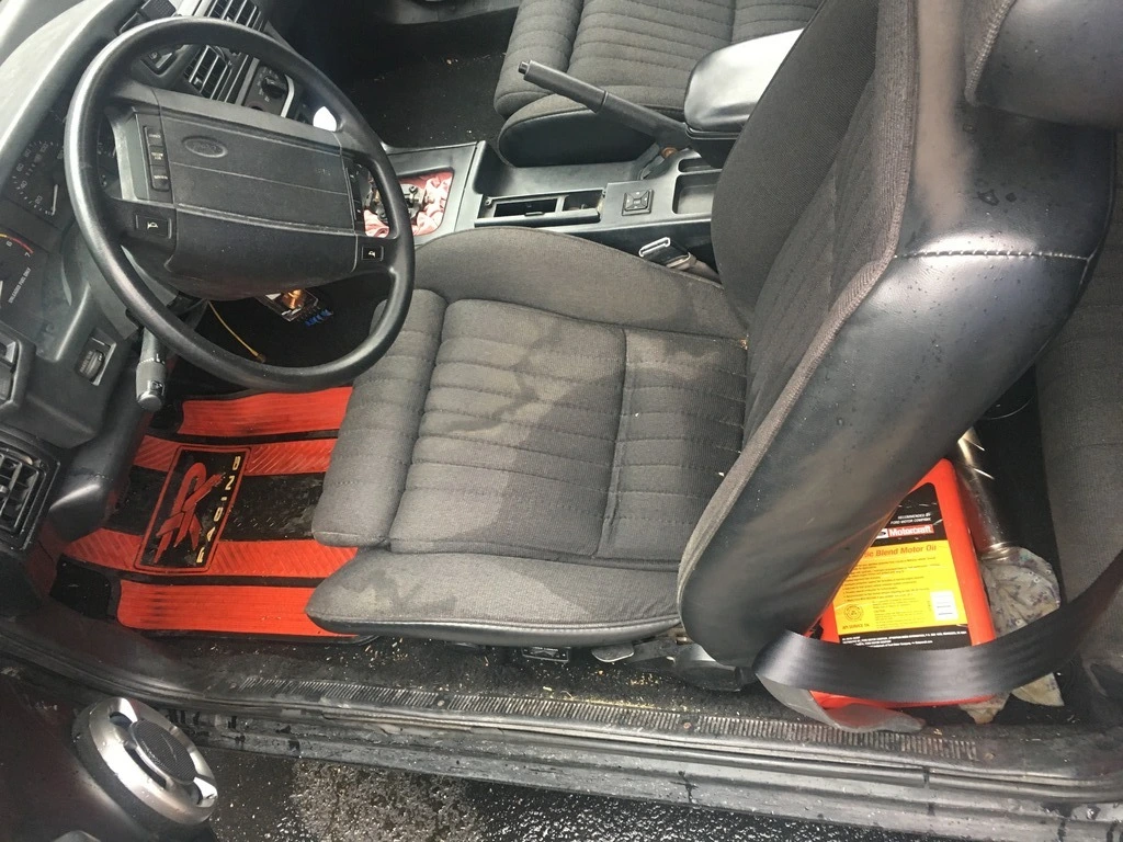

My driver door sits 1cm too low at the end (latching part). It is very difficult to open the door and it's so bad the rain literally pours into the car and soaks me and the interior. The hinge pins are perfect and have no play at all. When you open the door it does not immediately droop down like a car with bad hinges does. The striker plastic bushings is gone and I assume installing a new one would immediately break it because the door sits so bad.

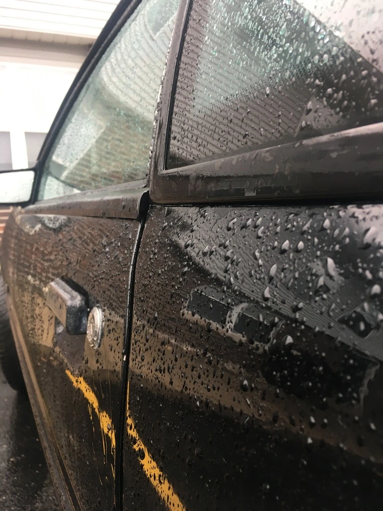

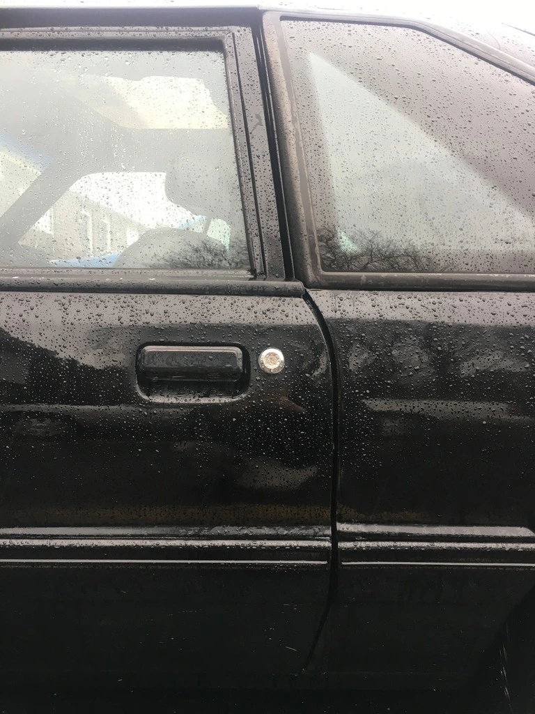

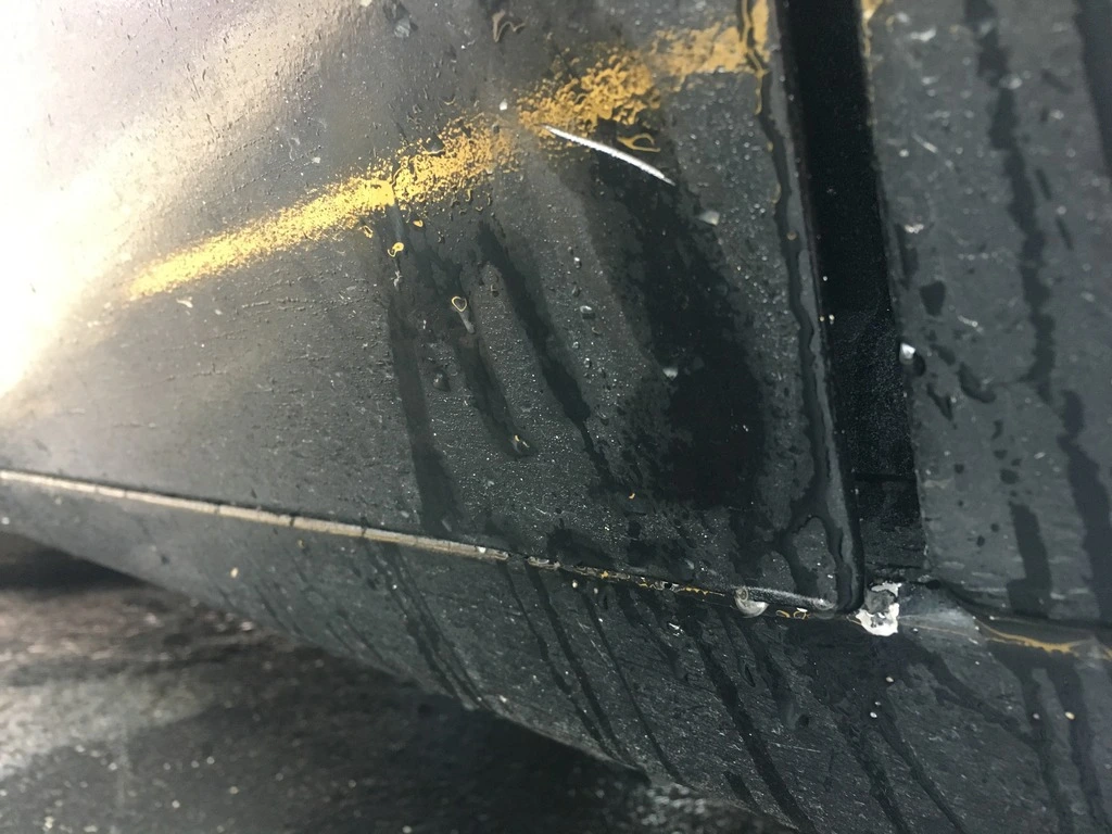

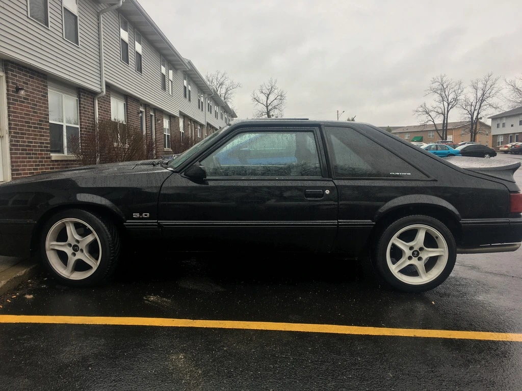

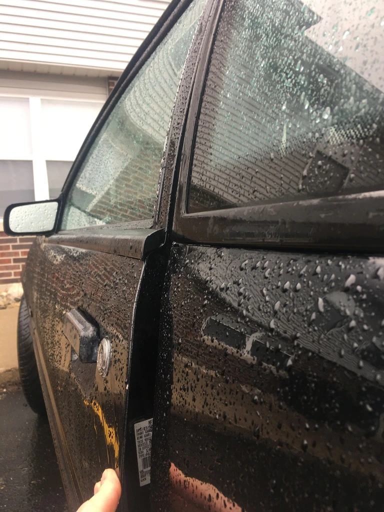

Thanks for the advice guys, glad to hear it is adjustable. I will check out where those bolts are and see if I want to pull the fender. For now here are some pictures of how it looks currently. The door is closed in all of these pictures except for the one I'm physically holding with my hand.
Holy crap! Move the striker up until the door body lines match up with the 1/4 body lines.
That door has dropped a bunch. You'll need to adjust the hinge bolts as well. I understand the hesitancy of wanting to take the fender off. You can adjust it with it on, it's just a little bit of a pita to do it.
First, the striker, then the hinges.
Truthfully, the front of the door is low too. This is fairly easy to fix, luckily.
BTW, I bet you're getting wet! It really might take you 15-30 minutes to fix that.
