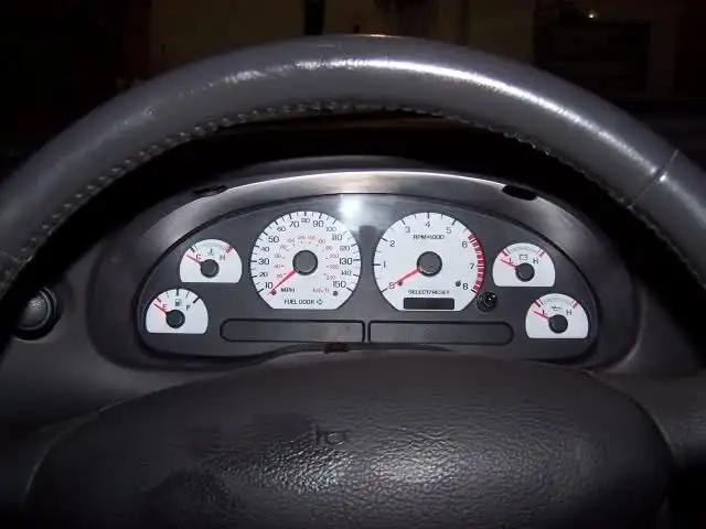

I finally got it off. I used the bent nail and a set of vise grips so I could hold it without the nail moving.
Im happy
