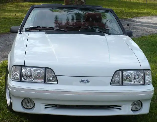

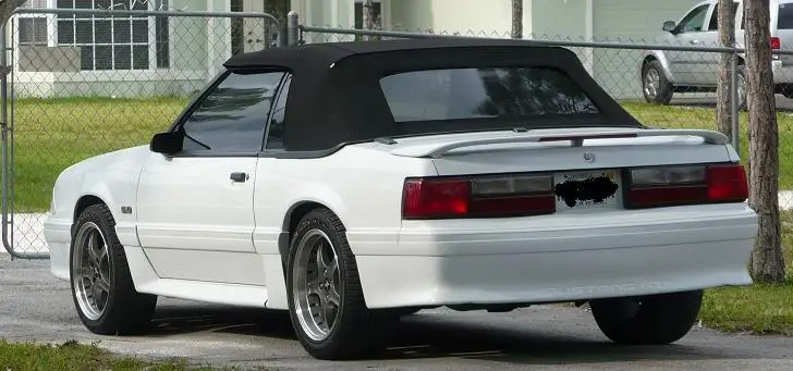

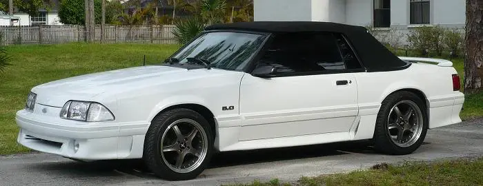

Thanks!
Sorry I couldn't resist an opportunity to show off my car.
Here's some more recent pictures with the LX tail lights and projector headlights..
