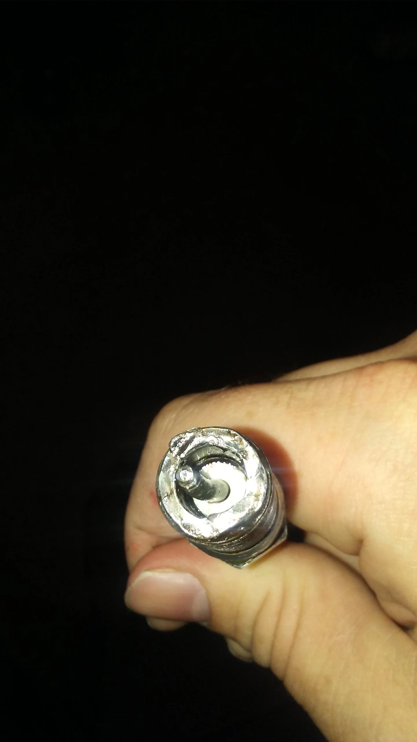

doubt the plug broke due to the mechanic. Also, Ford wouldn't even be able to prove it one way or another. I'll do my best to get a lawyer, it's going to get expensive, not sure how I'm going to be able to afford one. and no, the new spark plug was busted. smashed in .
the spark plug that broke.

Is that the plug the mechanic put in? Or the one you broke trying to get them out? If you can't afford a lawyer, just threaten you will get one, and check into your states lemon law. Back in 02 ford tried to get me to pay for a new head on a 2000 focus until I threatened them with the lemon law. Long story short they changed their tune once I mentioned the lemon law. The new head was suddenly covered under warranty.
every mechanic I spoke to either says most likely the head gasket blew and caused hydrolock which causes internal damage. or the rod or piston broke and smashed up against the spark plug
That plug looks like the aluminum from the head is still wrapped around the threads. Indicating metal failure of the head, and not the plugs. As long as the mechanic has any kind of info on proper installation torque of the plugs, then he is covered and Ford needs to honor the warranty.
