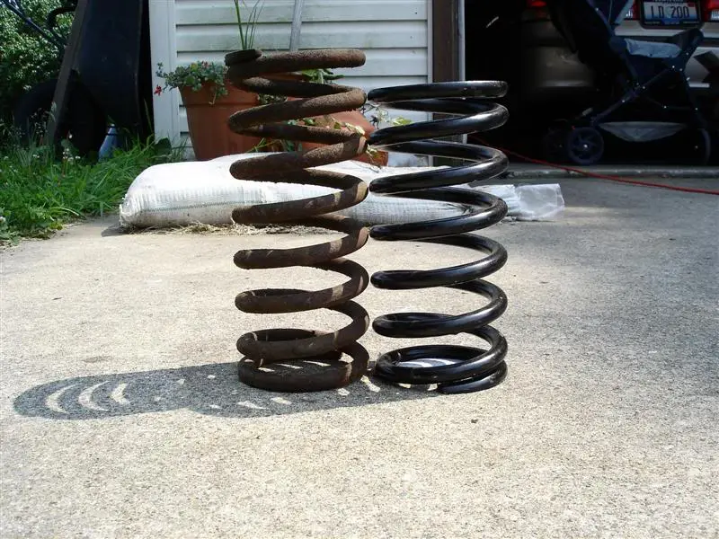

You Install Lowering Springs!! This isnt really mustang related, the mustang is currently Out of comission, but I have been working on the MG this weekend and thought i would share.

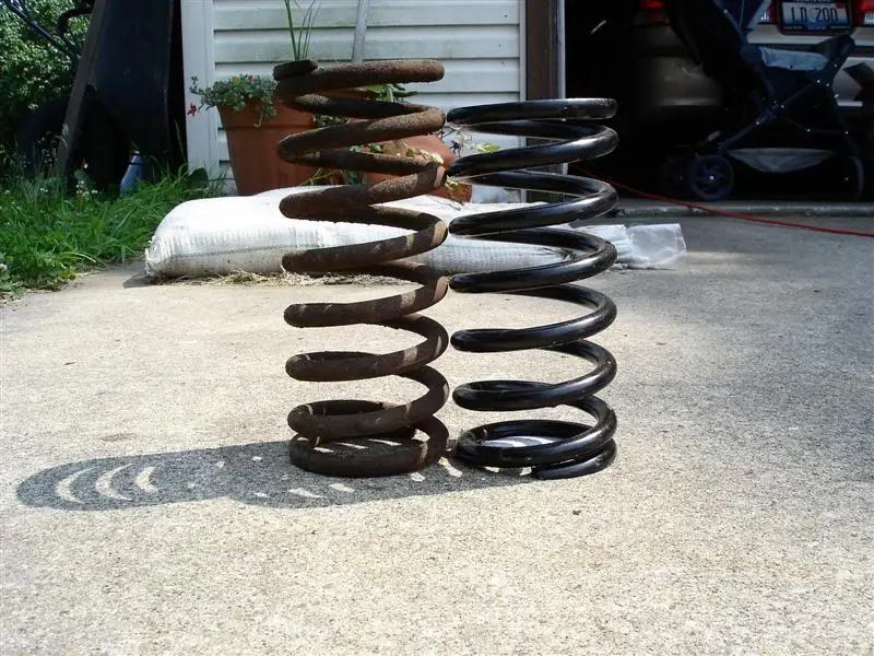

New Spring Next to Old Spring. Should Lower the car 1/2" old spring is 380# New one is 440#

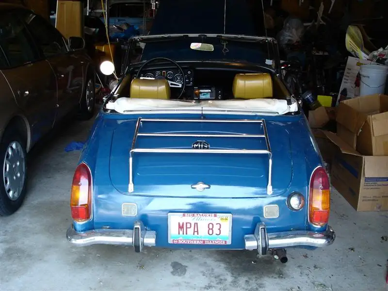

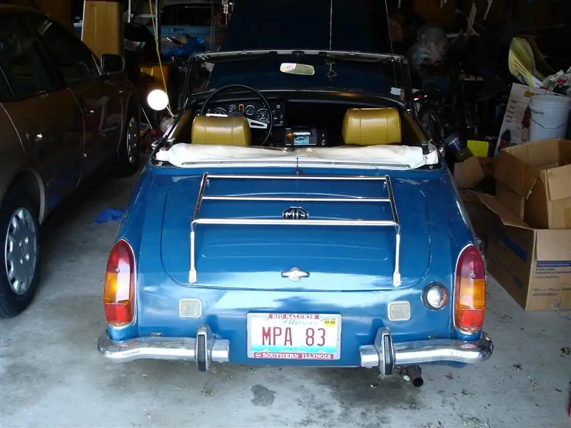

Car in the garage..

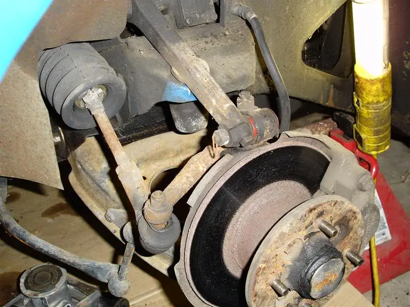

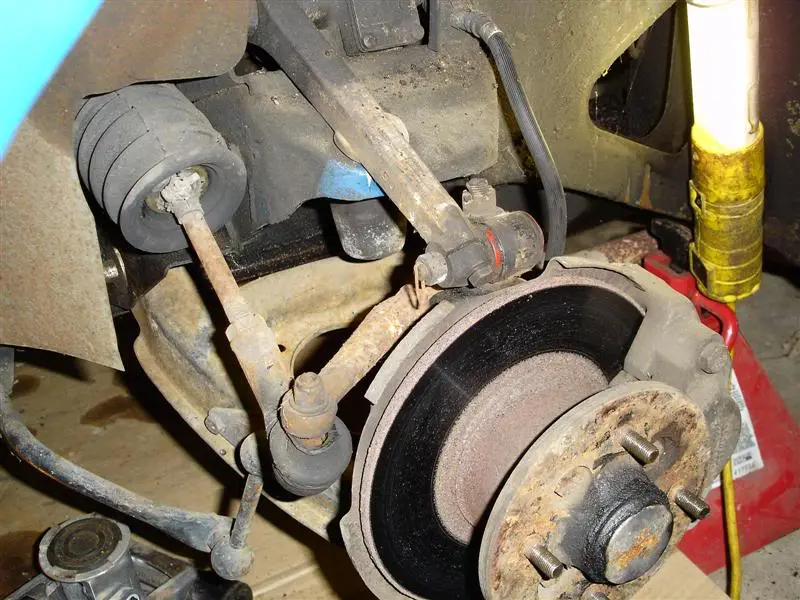

Archaic Suspension Design (with old Spring Removed), Notice the Lever Action (armstrong) Shock.

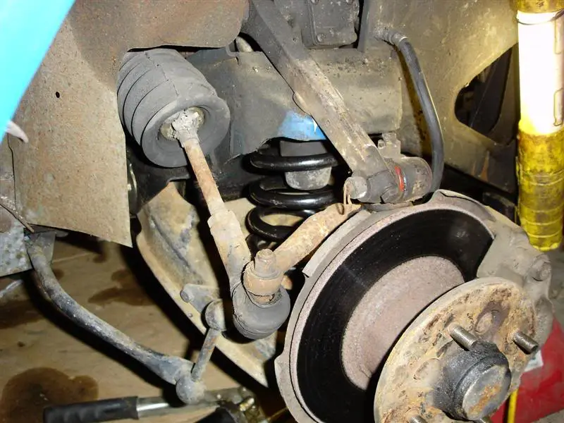

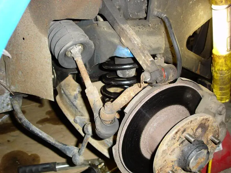

New spring, And new Brake Pads Installed
Found Bad bearings on the passenger side and had to order some new ones, so i dont really know what the ride height is yet, Ill post a finished pic when i get the wheels back on.

Anlushac11 said:
Are those the horizontal shocks I have heard about? IIRC those dont seem to work very well and the originals tended to leak alot.
The Shock is actually the top of the suspension, In that pic its the lever that attaches right above the spindle. The actually dont work too bad.... when they work. You Do have to fill them once in a while, But you can get different valves for them that are really easy to change so thats nice. One bad thing is there is NO camber OR castor adjust anywhere.so things just have to be right.
