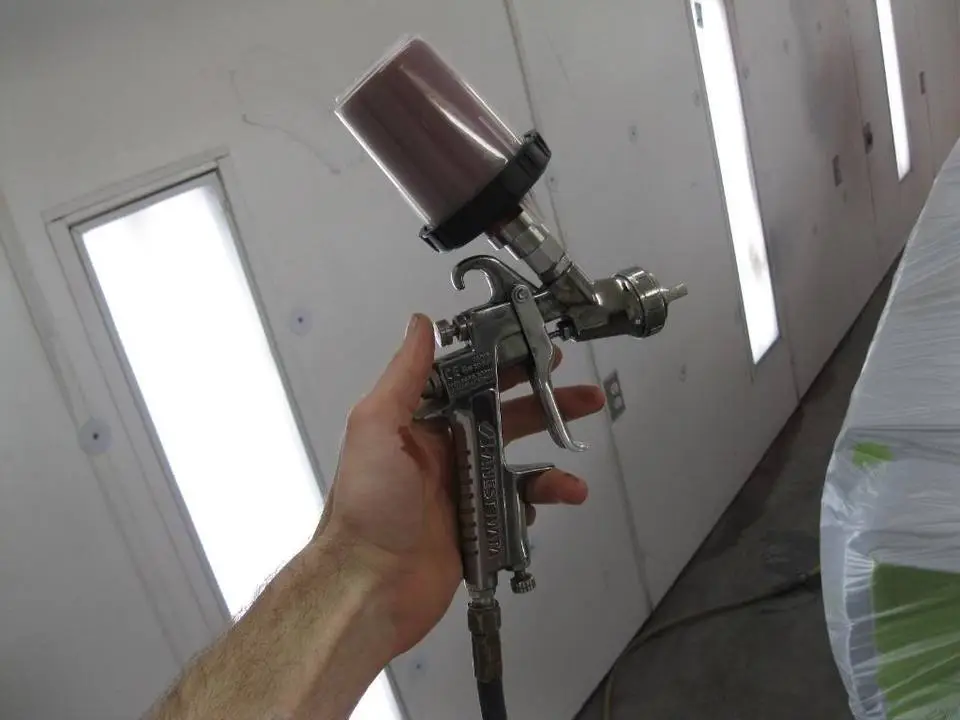

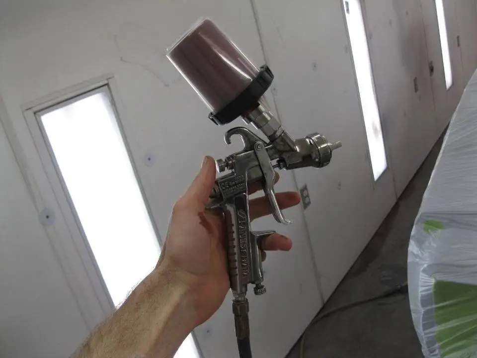

i used the small cup system on my full size gun to spray the engine compartment and the inside of the trunk. you can spray upside down with this setup. i also removed the regulator at the gun by setting the pressure at the wall regulator. smaller hose and removal of the coupler helps too.

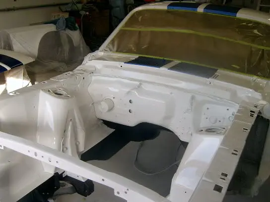

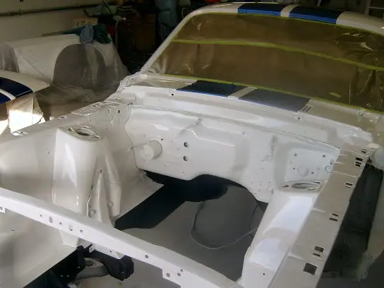

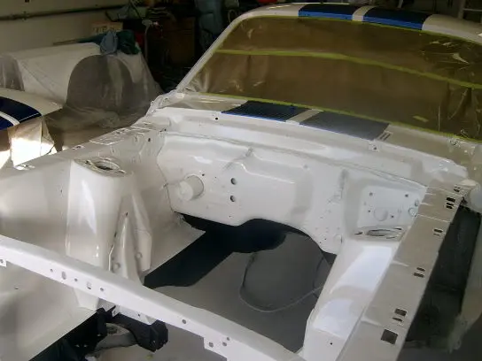

It's a pain in the butt to be sure, but I knocked my fan width down a bit when I did the base so that instead of a 6"-8" pattern at 6" distance, it was more like a 6" pattern at 12" distance. Without the fenders, that allowed me to reach the inner fenders from outside. I did the firewall sitting on the floor, as well as the areas behind the towers you can't easily reach. I also only got the tops of the frame rails and the vertical part of the firewall. On the vertical parts of the frame rails and the trans tunnel where it breaks under, I back-taped it later and shot it with satin black single stage. Here's a pic that helps show kinda what I ended up with.
You posted at the same time as I just did. So you went with black on the trans tunneléfirewall as it breaks back from the vertical part, if I am reading this correctly. I have been wrestling with where to transition from body color to the satin black I am also using under the car.

Yes, you are right on about where I did the color separation. It's tough to see, but I went about an inch below the break with the white on the firewall and right on the ridge of the rails. With everything assembled, your eyes really don't even see two colors. It just kinda looks all white because the satin black blends into the shadows under the car. I also did the front cross-member satin black because I didn't want a glaring white cross-member peeking out under the Shelby nose. I think the regular Mustang valance is a bit lower and covers the cross-member.
Now you've got me thinking. I was going to do kind of the inverse of what you did, paint the tops and sides of the subframe body color and the bottom satin black but in your picture the transition looks very natural, I like it. When you say front crossmember do you mean the two 45 degree supports that hold the strut rods? or the rad support? either way that was my next question, to paint the 45 degree supports body color or satin black, I don't think doing the top body color and the sides black would look right on those? the rad support will be pretty much hidden at the bottom on the inside and like you say by the valance on the outside so I think that will be all body color.

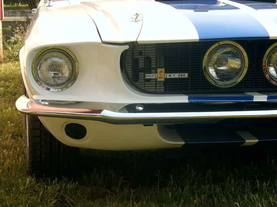

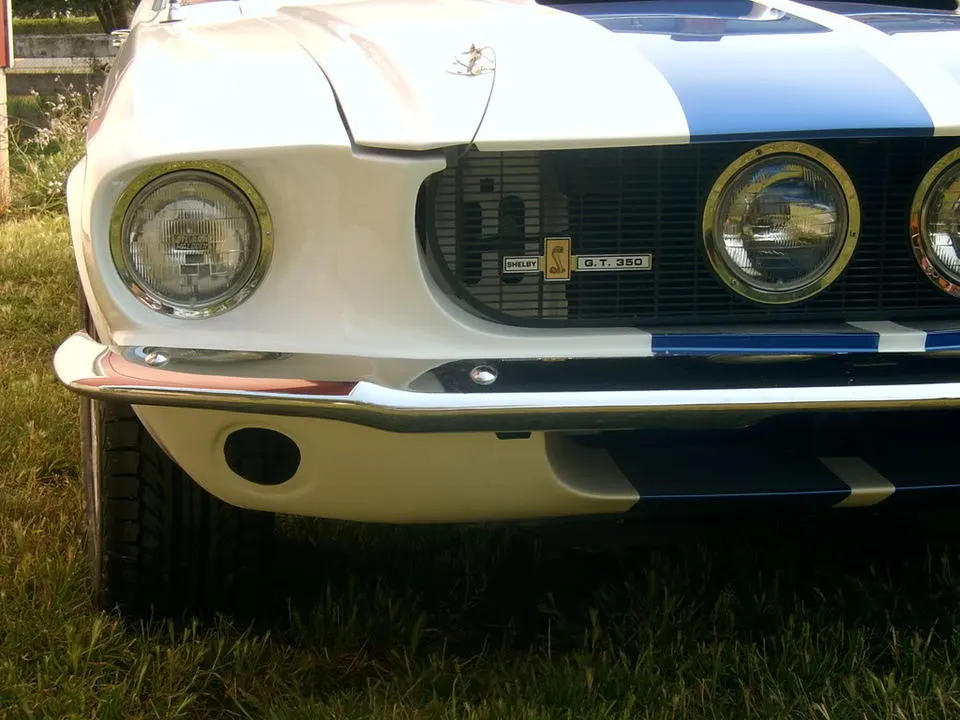

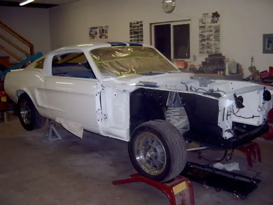

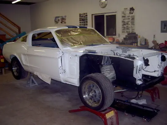

I left my radiator support white because I think it gives it a more detailed look with the white peeking through the grille, but I shot the lower front crossmember and strut supports satin black to hide them. The Shelby valance doesn't cover that whole mess and I thought it would look a little goofy with all the white hanging down under the white valance. Here's a couple pics to help show what I did
In the first pic you can see where I separated the colors in the front, while the second pic shows what I meant about the radiator support showing through. Just a personal quirk of mine, but I like to show off the the cleanliness that comes with a plain white car. In the last pic you can see what I mean by the black hiding all the crap hanging down and making the car look lower.

Thanks for all the pics and explanations, I really like it. I've been really struggling with where to trasition the two colors and I think the way you did yours is the ticket. It looks like you pretty much snapped a line all the way around where the top of the subframe is and anything under it is black. I'm going with your plan, thanks again for the help, and to the others that offered suggestions on how or where to spray it from.
