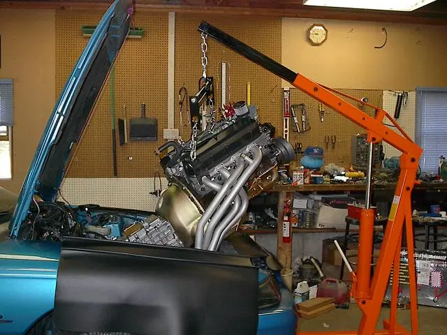

all at once & (off topic) install the headers before putting it back in the car

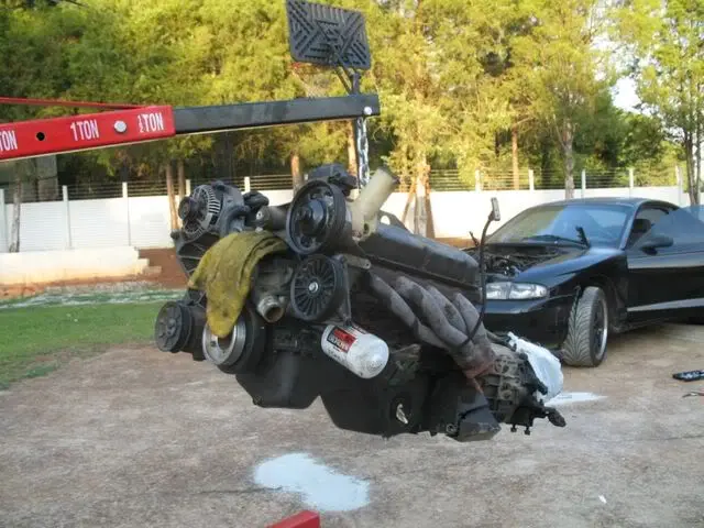

engine and tranny.
good times..

To the people with long tubes:
Were there any problems installing the engine with the headers already on?
I've always heard to keep the headers in the car and then bolt them onto the engine once the engine is put back into the car...

nope, just make sure to unhook the steering shaft from the rack (1 bolt) and swing the shaft towards the fender out of the way.

^^^+1^^^ much easier to bolt them out of the car.
