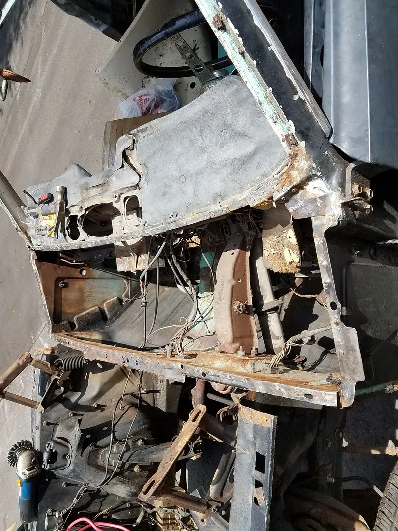

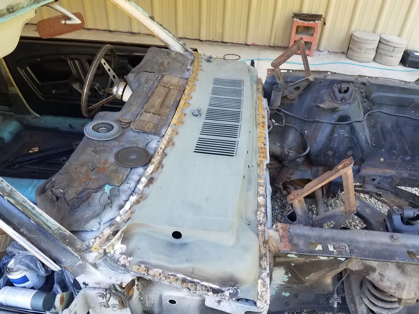

Can't give any shop reccomendations, but what are they saying needs to be replaced? Some things like the cowl as an example rot out on these cars fairly easily and its a lot of work to replace one:

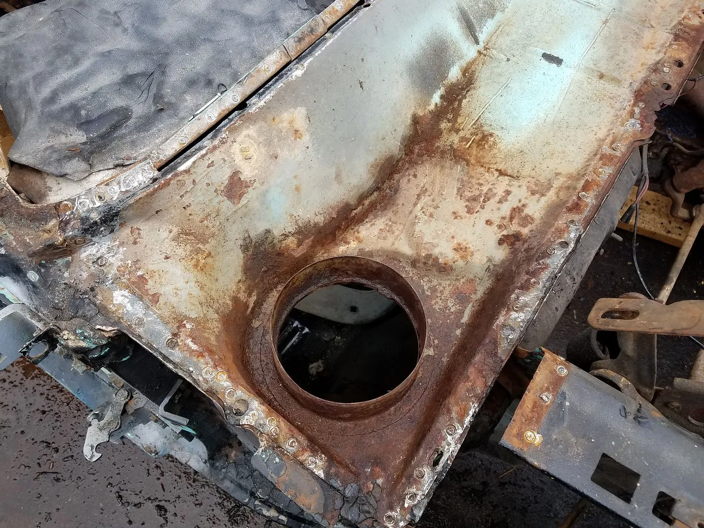

A common cowl condition(mine before I replaced it)

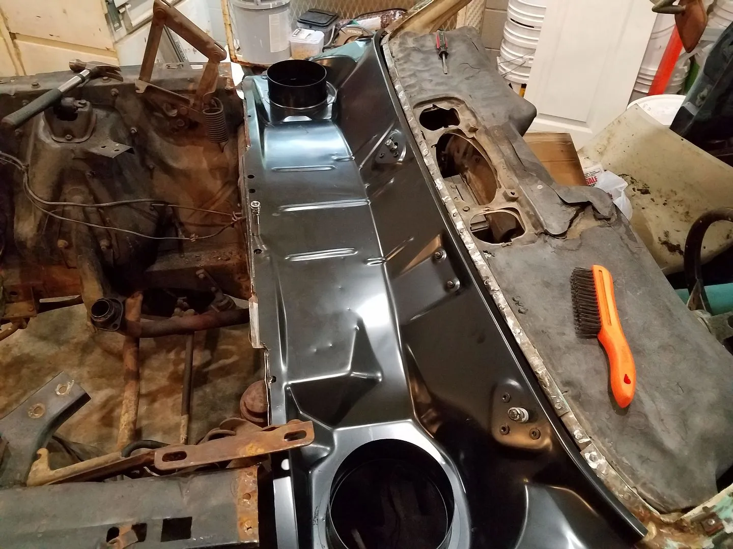

Took me about 25 hours to replace it(maybe $300 in parts and supplies, would be more if I didnt keep the original upper cowl)...a shop will charge $3000-$4000 to do this(maybe more) but will likely be faster for them. its a common problem on vintage mustangs and a sure sign is that the floor pans need to be replaced...or have been replaced in the past...the cowl will rot and drip water onto the floor boards, rotting them as well.
I am not saying you have a rotted cowl, just saying that when it comes to shops, the bill can add up quickly if you cant do the work yourself or know someone who can....this type of repair is fairly common.

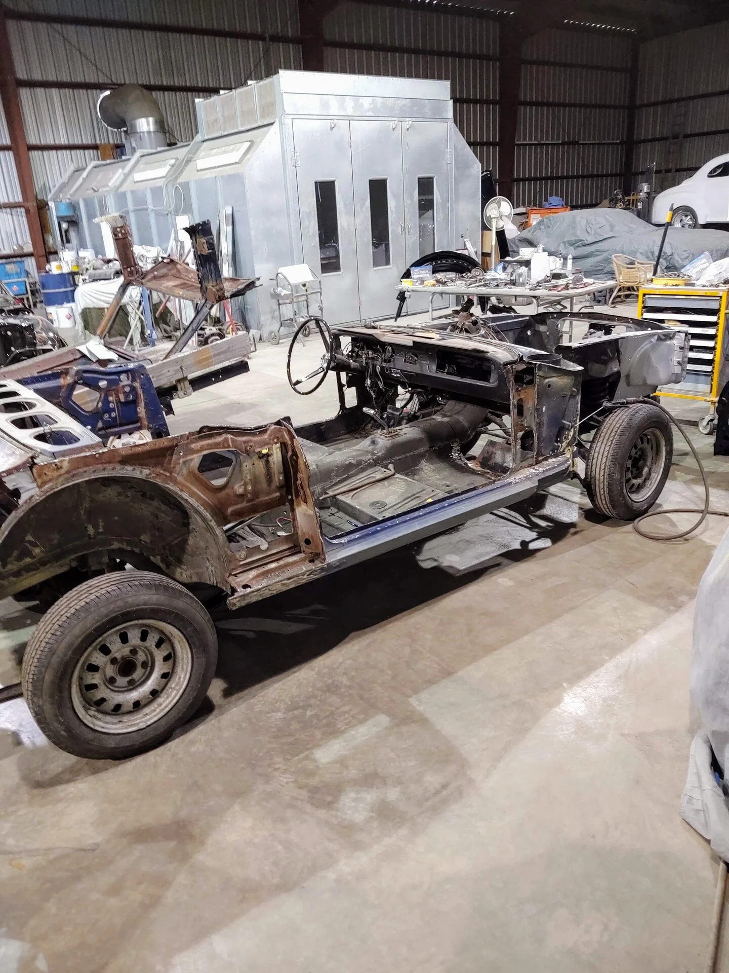

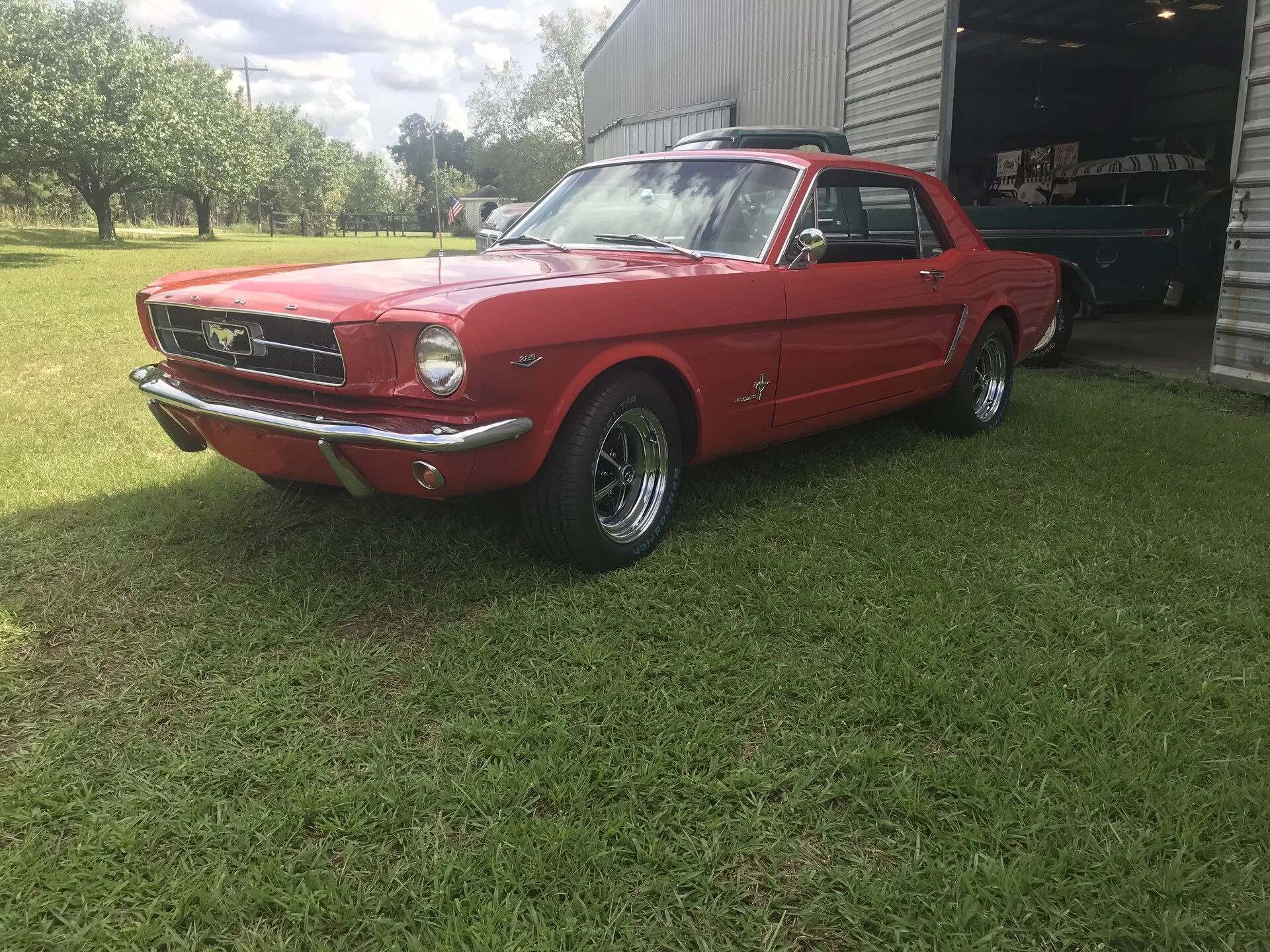

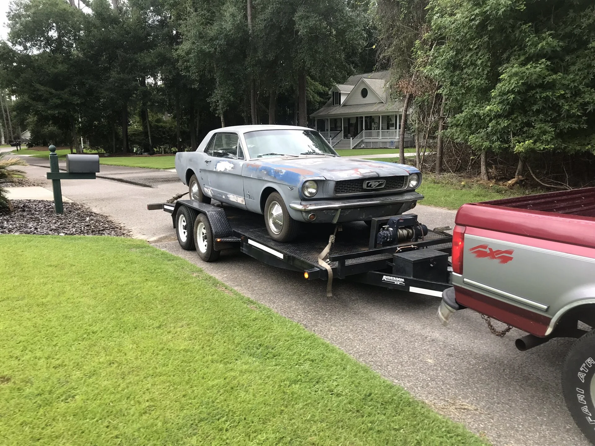

When your friend finally find’s one, He needs to go over it very well I bought my 65 Mustang for 5K and ended up putting another 25K in parts and labor and still have a few minor issues
