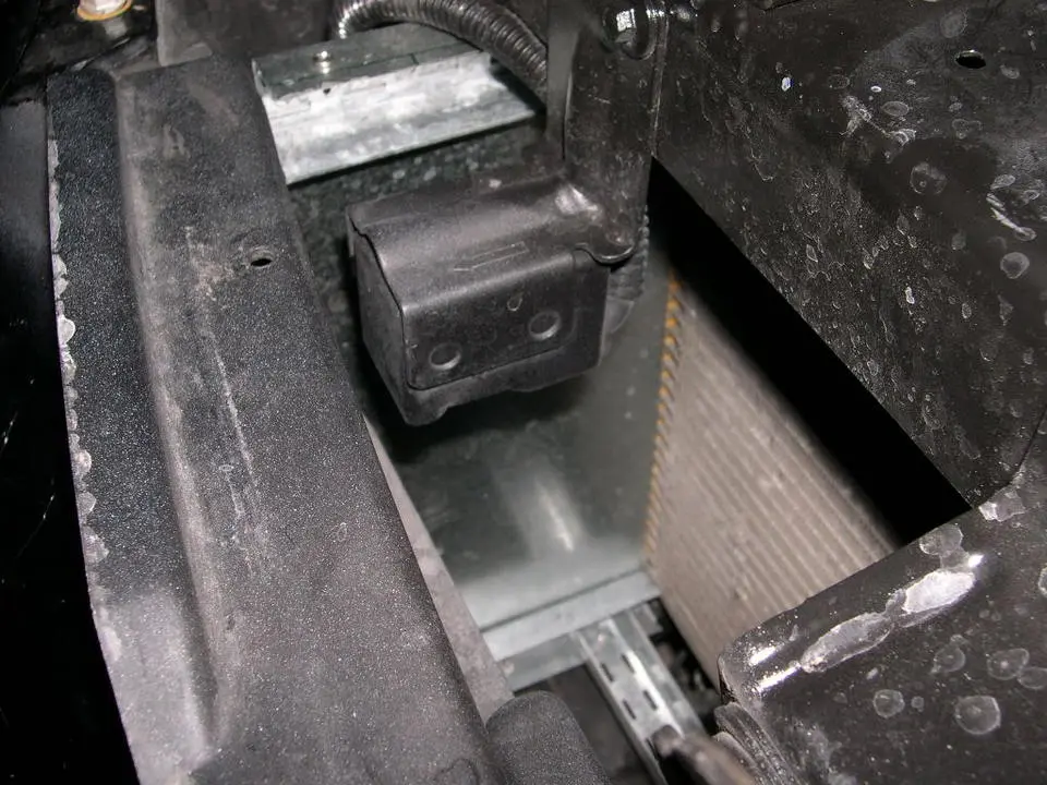

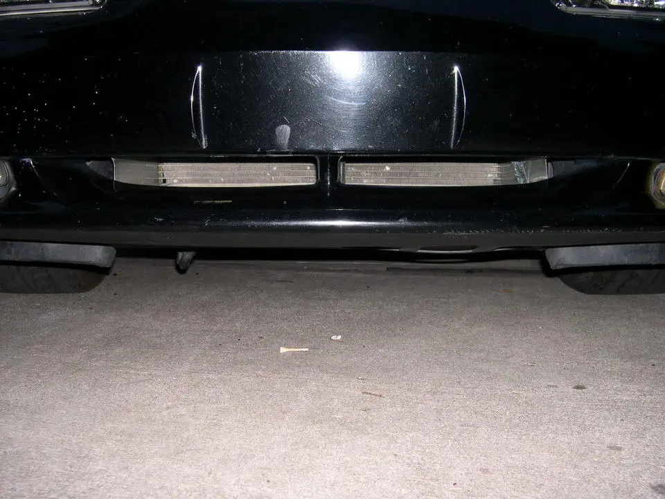

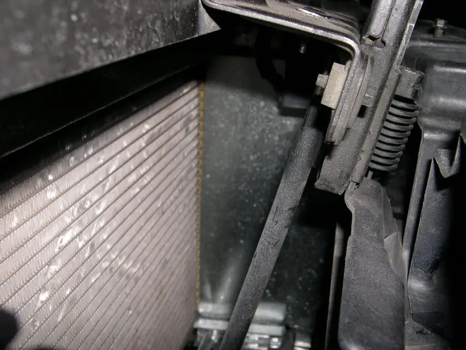

Wondering how hot you guys run on the highway. I just finished up making a sheetmetal box frame that boxes in the radiator to the front bumper to force air to go through the radiator instead of around it like air wants to. Because just like electricity, air wants to travel the path with the least resistance, well i got rid of that path by making this frame. Now on the highway, granted it was about 45 degrees, but it barely hit the N in normal on the stock gauge. Just seeing how much of an improvement I made with it. Thats with a h.c.i. motor and long tubes and some spirited driving.

Well I'm still running a stock radiator and stock thermostat so it used to get pretty hot under there with the long tubes after some good wot runs. The biggest difference is sitting in stop and go traffic, it never goes above the R anymore since the coolant circulated is cooled off so well, it never has a chance to get to boiling temps and sky rocket like it used to. I'll see if I have some pics of it before I installed it. You can't really see it now with the bumper on. I'm gonna rock the stock radiator for a little longer til I have some cash for a custom Ron Davis.
Jeremy
Just took some pics.
Jeremy

Jeremy, didnt you have black plastic going down the sides before? I suppose it might not have gone forward far enough in your case. I get it now. :bang:
It doesnt look like you have the little air dam under the bumper. Contrary to what people post, in extreme heat (desert SW), I did notice a difference with or without it.
It looks like you did a nice job with it. :nice:

Yeah, those black plastics you mentioned were long gone years ago. Thats what was causing my issues the most probably. But now I have these and they aren't going anywhere. I'd have to take the top support bar off before it even comes out. And like mentioned, its trimmed and cut to form to the core and bumper and the bumper cover so it has to go straight.
