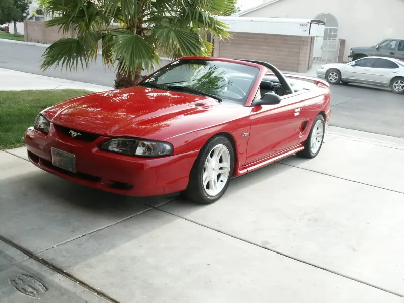

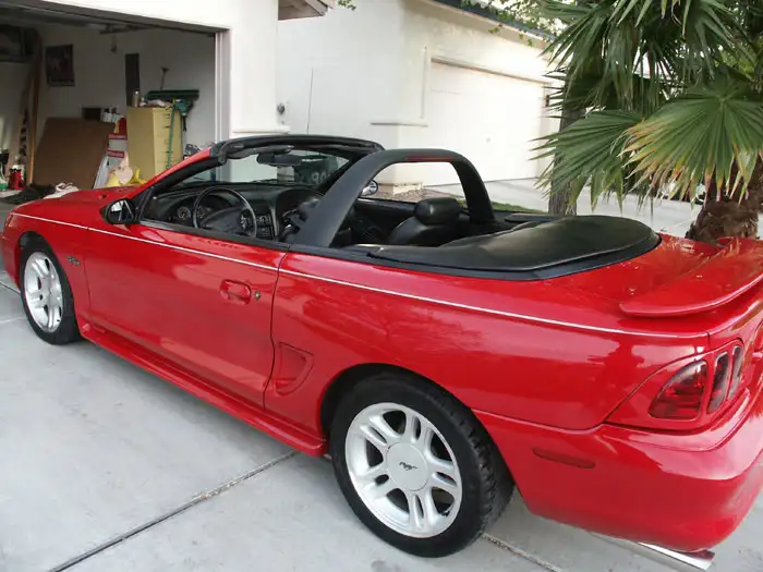

Caster/Camber plates would be in order. Don't cut springs unless you want to compromise your ride. I'm sitting (lowered) at 1-3/4" in the front and 1-1/2" in the rear. They DO NOT look like I'm squatting... It actually looks normal now not slammed.
See pics...
:SNSign:
