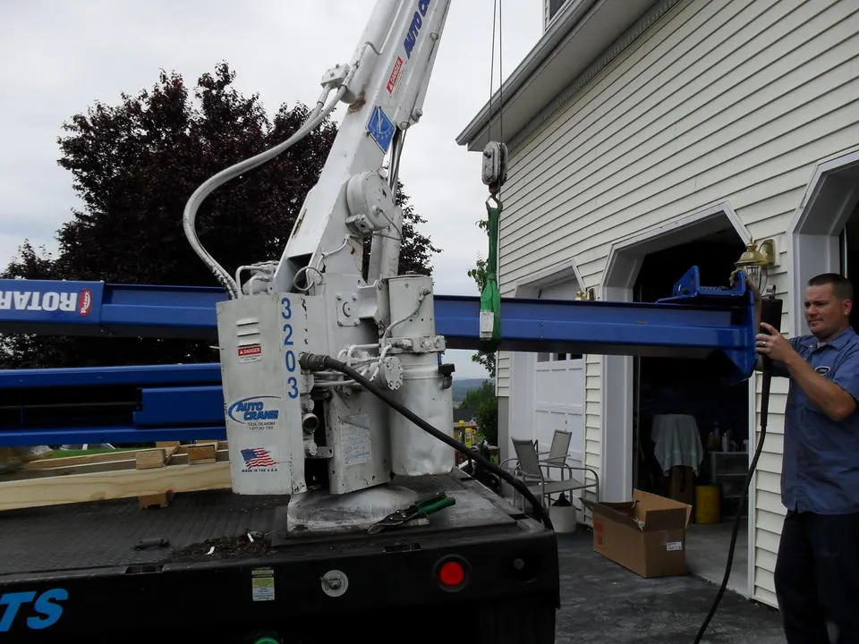

Here's the problem with lift installation. A freight truck brings you your lift and drops it off at your house...then what. how do you move it? is it in pieces? who is going to put it together?

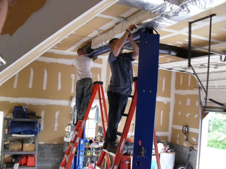

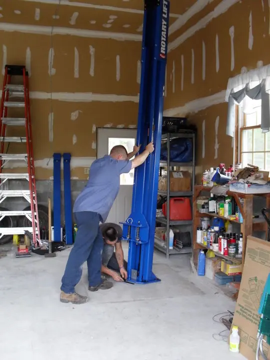

i would talk to local shops and schools who have lifts. they can tell you who did it. my parents recently put in a lift in their garage. the person to install it was also a dealer of said lifts. he brought it to the house and assembled it with his team.

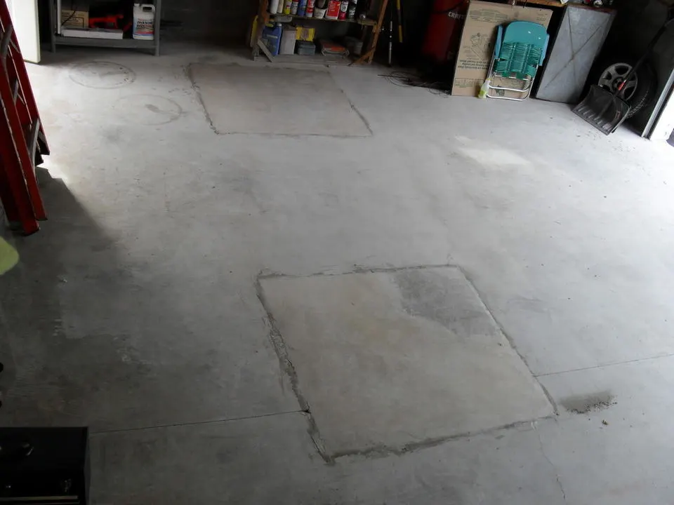

since i am talking about safety. you should be certain that your flooring is capable of supporting a lift. for the lift we got, our concrete needed to be at least 4.5" thick. they had to come and cut out squares and repour concrete deep enough to bolt the posts down. this is why it may not necessarily be the best bet to go the ebay route with a lift purchase

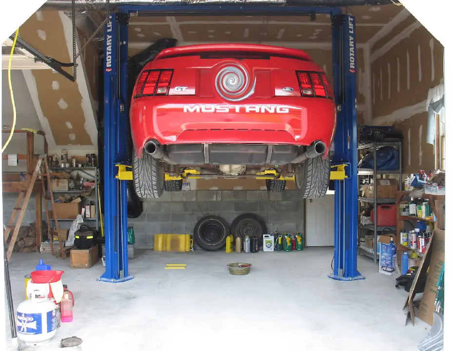

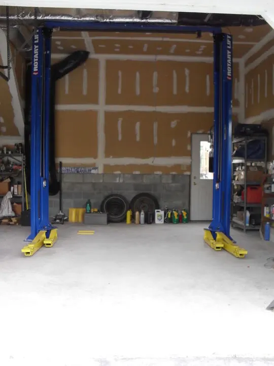

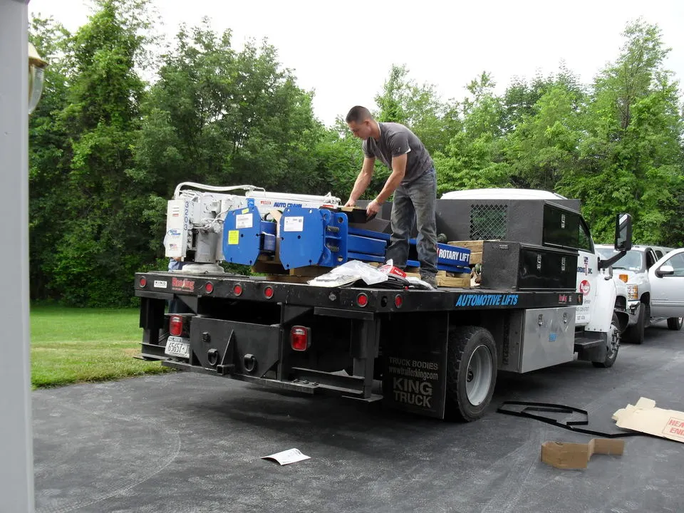

anyway, my parents bought a Rotary 2-post Asymmetrical lift:
ive had the opportunity to use it and i absolutely love it!

oh btw. although the one my parents got is a 2 post, theres an accessory in their catalog to install a solid platform on the arms so that you can drive a car up on it for extra storage underneath for prolonged periods :nice:

Oh btw, I would have the use of a tractor since we live out in the sticks and have those things.. would this be able to install the 2 posts do you think? I could even get a front end loader from some people as well if the tractor didn't do the job. Also that setup looks just like what I was thinking about. How tall is the roof in that section of the garage?

i BELIEVE the ceiling is just shy of 13 feet
