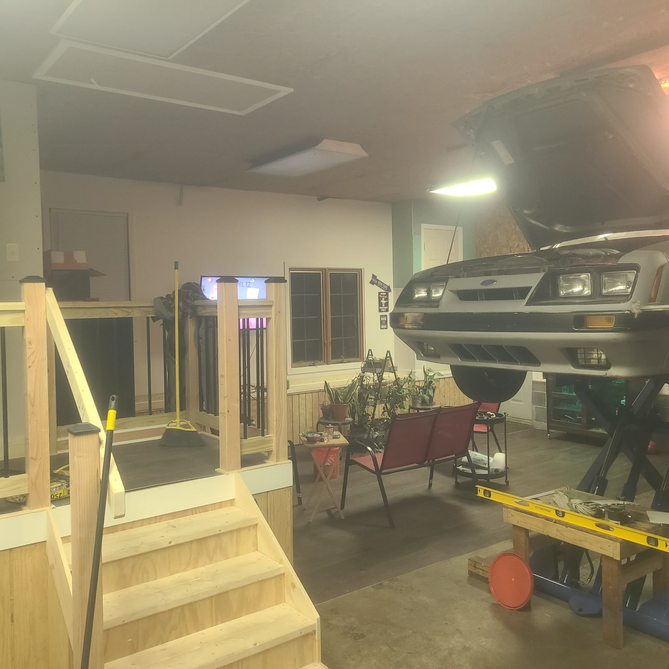

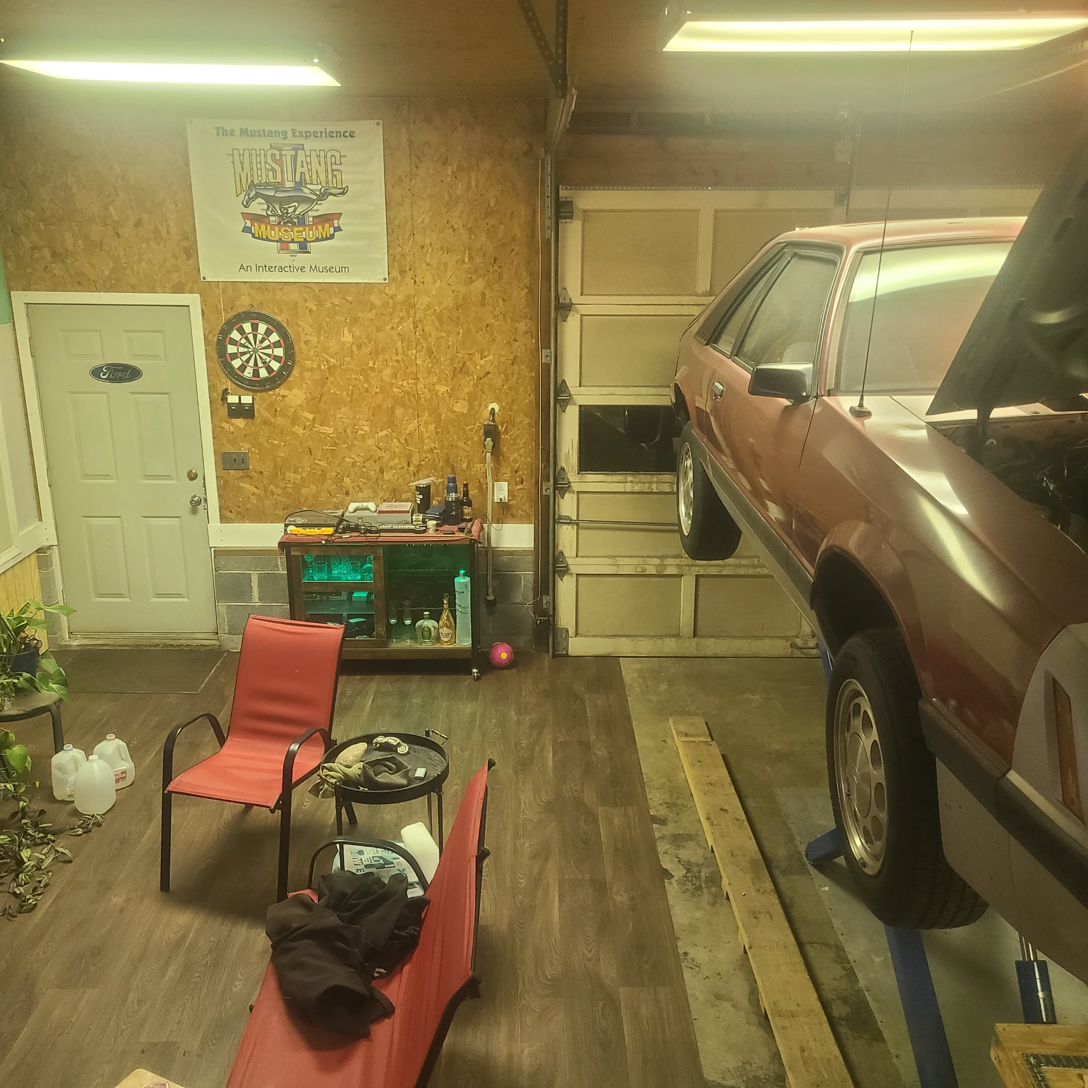

I've got a harbor freight scossor lift in mine. It works out well. My garage has an 11ft ceiling but maxes with a fox at around 9ft. Doesnt come close to the door motor or hardware. Its the same one thats sold by a binch of other bramds...they just paint it a different color.
This is all the way up with the car on 2x4 blocks on the lift arms. I did have to make ramps because my other car is too low to clear it. Recessing in the floor would be nice....but expensive and a lot of work. I put a quick coupler on the hydraulic line so i van move the pump out of the way.
I can easily fit under it on a rolling stool. Its a plus that I can move it anywhere.
