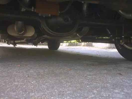

depends on the car. My 66 falcon was not fun and I spent a lot of money and time figuring out what other fords shared the same parts. No aftermarket support (custom 5 leaf springs, homemade traction bars and subframe connectors, stock hood modified into a 3" cowl hood). I essentially had to buy a parts car to convert it over. Ironically enough the parts car had less rust and cost me $200 complete with 8", c-4 and some crappy 255. So, I would not do it again. In fact I would make my life easy and buy a foxbody so I have no fitment issues.

isn't the running gear on a 66 falcon essentially the same as a mustang? If so why didn't you just find mustang parts?
I built the 306, bought a TCI street fighter c-4.
So yes the running gear is the same but that wasn't the problem I had.
Luckily the parts car had the 8" I needed (same year) so that meant the driveshaft with it (which ended up needing an entire new cap on the rear end side because it was twisted where it held the u-joint).
The problem was everything else. Any early model mustang is apparently an inch shorter from where the eye bolt is to where the shock plates are on the rear end and another inch from shock plate to shackle. So the two mustang springs I tried were both two inches too short.
I needed to get a cowl hood for clearance issues, but none of the mustang hoods cross over . . .
The frame mounts were impossible to find for the falcon. Which is incidentally why I bought the parts car in the first place.
Being that the falcon is shorter, I couldn't find any pre-made subframe connectors specifically for it so I found some for a fairlane and made those work.
The traction bars were the worst. I bought the mustang plus kit and cut the ends off of it (circle that holds the bushings). Welded those to some stock I had laying around after measuring the distance I needed. The original mustang length was actually 4 inches too short, I think mine ended up at 29 inches long. Then I realized the shock plates are completely different on a mustang. I slotted the holes on the plates from the kit and welded the tabs for the end of the traction bar to the bottom.
So, I did enjoy finally getting it to work. Add to the fact I have seen very few late model falcons, it was worthwhile. It was just annoying that every step of the process I had to stop and make something work. The thing sat in my garage with the motor and trans in for about 3 months.
