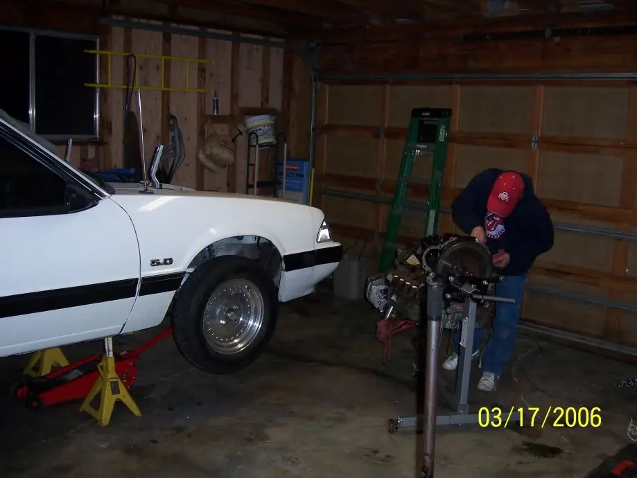

WOW! the scales i used must be way off then? My coupe all tublar k member and arms weighted in at 3200,my 4 banger weighted in at 2950 on the same scales.My coupe is a 351w and my wheels alone weight 53LBS each i took a wheel off and weight one so i know,my car also had a full tank of fuel and me in it i weight 150LBS.Here is how it looked when i weighted it,i was told with no front and rear seats with my hard fixed back plastic driver seat and my old centerline drag wheels my coupe weighted 2700 but that was with the 302.
3200LBS trim

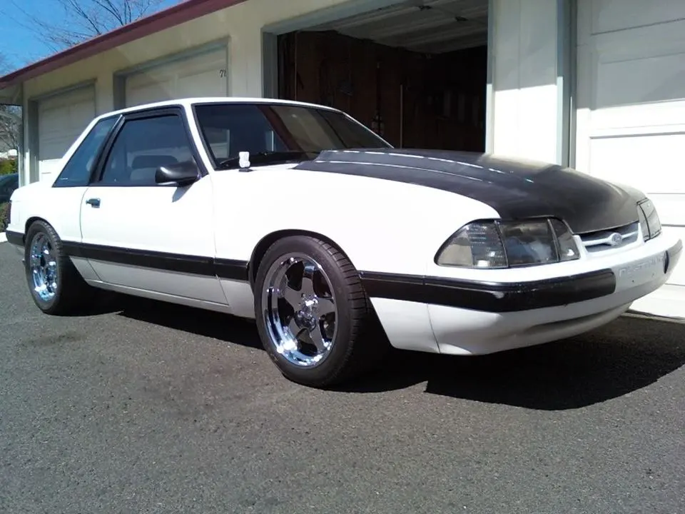

I'd guess 3250, myne weighed 2980 before i put a rollbar in it, and ive got no ac, ps, UPR front kit, no sway bar, aluminum rad, flywheel, bla bla bla.
it depends on the car, ive seen guys with way less removed than my car and they come in at 2900 with driver.
