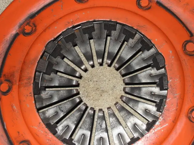

I have a centerforce that blew up on me in 1.5 year. It grenaded itself. The ring that holds the weights together broke and the weights went flying. Thats the reason why I am replacing it. I don't want go put the same clutch back in there and have the same problem down the road. The disc itself is mint not even close be being worn but it just seems like it wasn't made that well.
